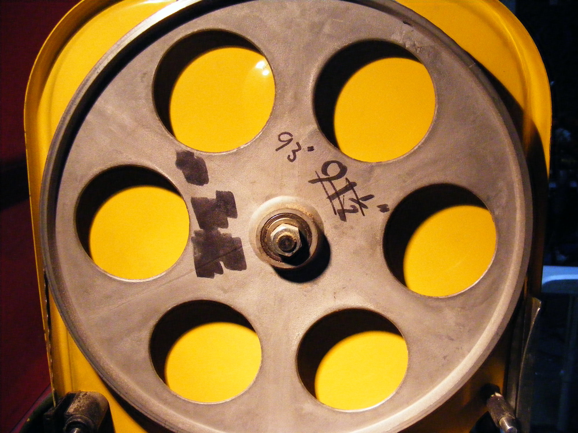

I found the wheels were balanced fairly well but a bit fettling helped the top wheel, it is easy if the bearings are good made a mandrel & used a pair of knife edges to do the bottom one it was worse than top wheel, there appears to be balance holes drilled under the tires from new, I was being really picky.

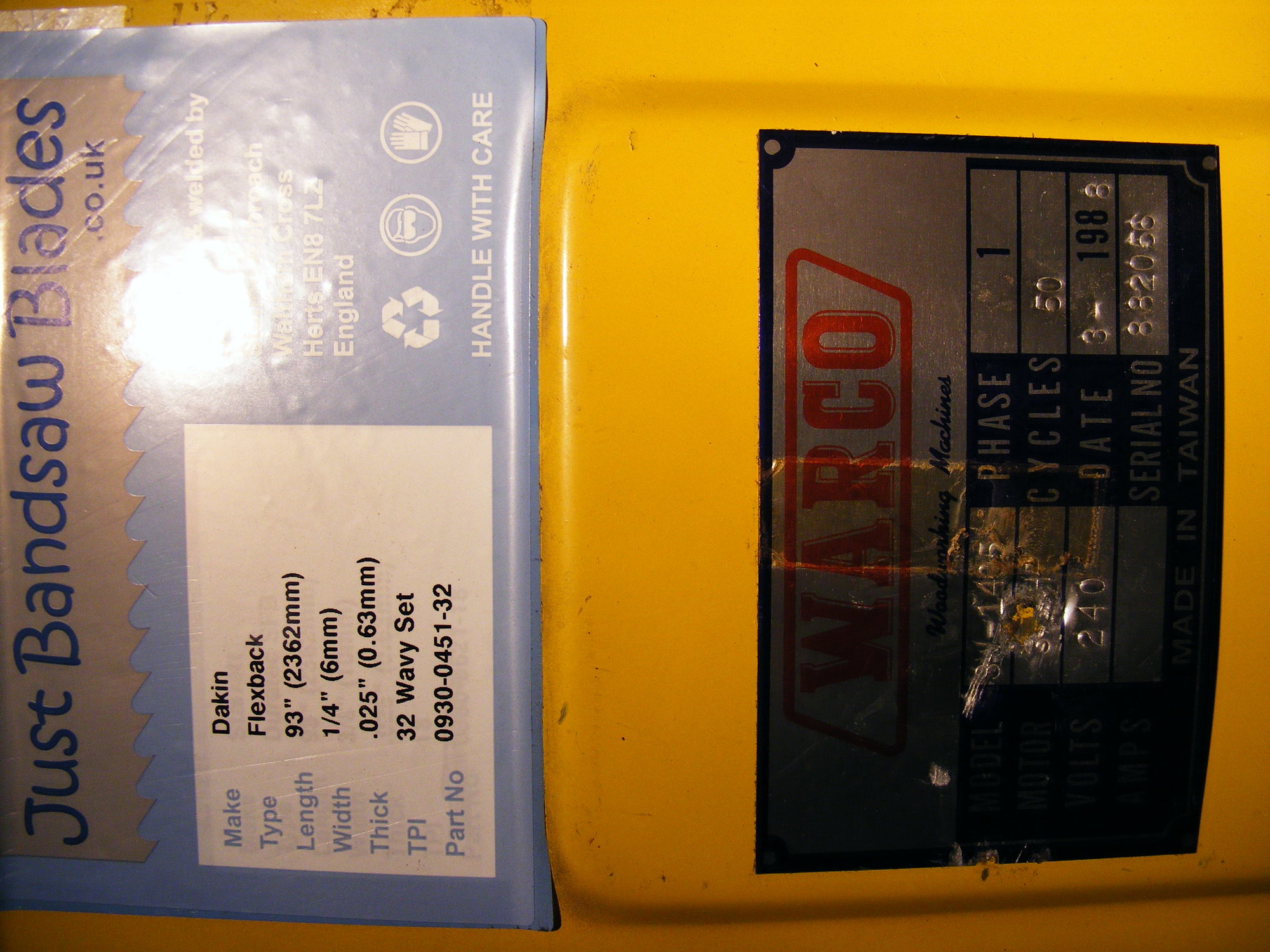

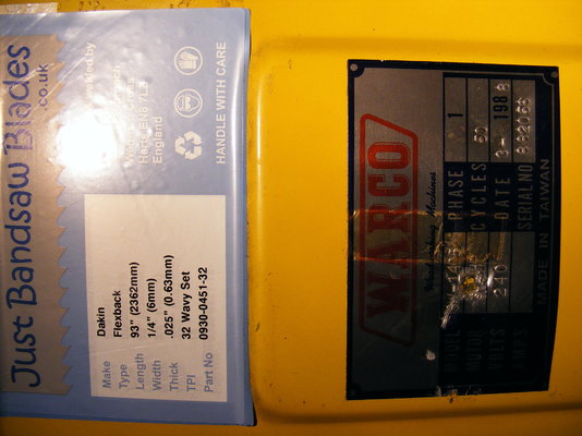

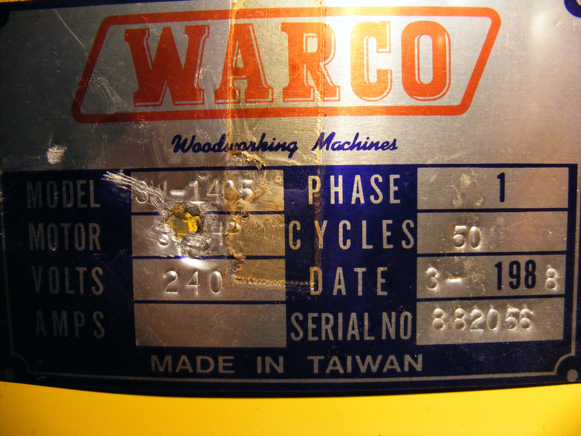

Could not find any mention of the unit on the Warco site @jordan1 if you have a link
I note @Wallace your top wheel has a LOT more balance drilling than mine, & mine is under the tire not on the face, could you post a photo of the drive through the door on other side please
