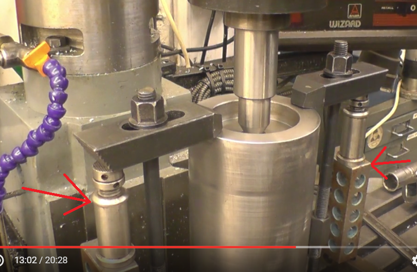

They are as has been said "machinists jacks" these were given to me by a retired machinist
Very nifty - I'll keep my eye outThey are as has been said "machinists jacks" these were given to me by a retired machinist
He made them as an apprentice
They will be at least 60 years old
Ahh... I thought they might be mini hydraulic units.
Good - I'll make some! All I make in my garage are more tools to keep the other tools company![]()
If you do this make sure it's decent quality 8.8 or 10.9 studding rather than no-name stuff made of cheese, otherwise you won't get much clamping pressure before it strips.or this is my version of clamps and work holding. the threaded rods are M6 and the clamps / T nuts are 1/4" thick.
