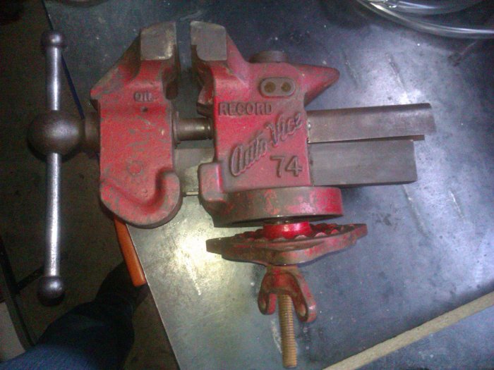

B breezer Member Messages 768 Sep 30, 2012 #1 Bought this yesterday from a local autojumble - i understand most of its features - stake on top, anvil point, swivel base, bending formers etc but the two holes on the side (not the oil hole) im not sure of their use. Can anyone advise? Jim FB_IMG_13489123911644440.jpg 68 KB · Views: 731
Hitch Moderator Staff member Messages 13,480 Location England Sep 30, 2012 #2 Are they shallow holes, riveting maybe? Retaining screws for the anvil part....?
B breezer Member Messages 768 Sep 30, 2012 #3 Retaining screw for the stake is around the other side.
madkayaker Pro sparkey Pro Welder Messages 13,678 Sep 30, 2012 #6 Same vice as I have. The holes are different size and threaded. What there for have a clue!
Shox Dr Chief Engineer to Carlos Fandango Messages 17,866 Location East Yorkshire Sep 30, 2012 #7 More to the piont what did you pay for it
Shox Dr Chief Engineer to Carlos Fandango Messages 17,866 Location East Yorkshire Sep 30, 2012 #9 Cool, have the holes been machined out or they rough cast?

the snooper getting older by the day Messages 21,063 Location Hull UK Sep 30, 2012 #13 ok had to do something about this so of to google again and found this so it sounds like its the steel plug for holding cylinder heads, the plug looks to have 2 different size threads vice.JPG 65 KB · Views: 407
madkayaker Pro sparkey Pro Welder Messages 13,678 Sep 30, 2012 #14 Plug for holding motor car cylinder head?
