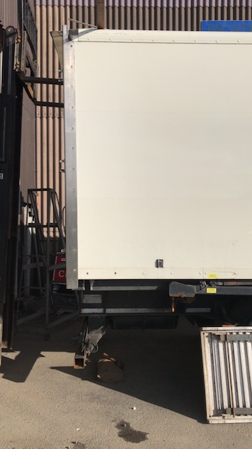

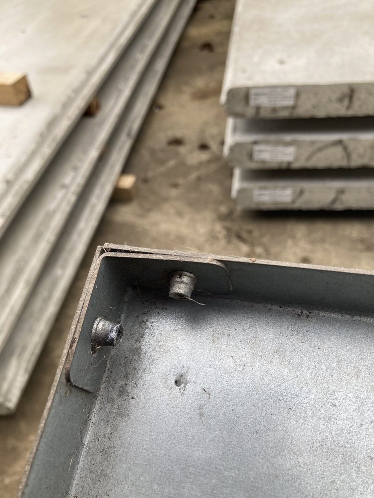

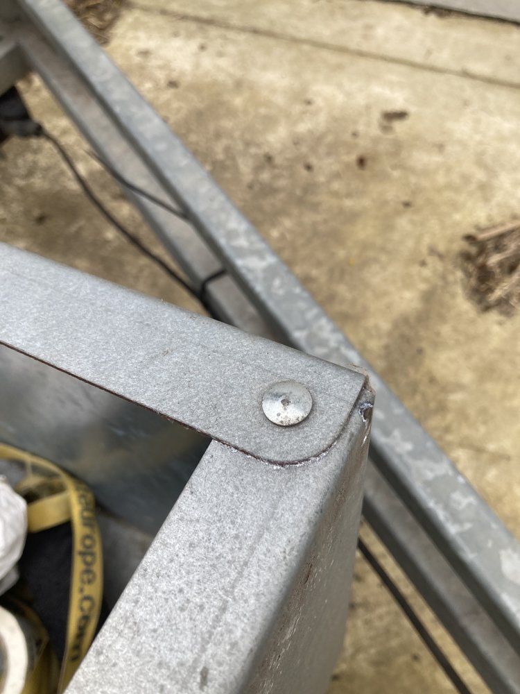

Any ideas what these are, like a rivnut but with plain dome head?
They are Huck bolts, Leyland Nationals are held together with them.
Colin
There's a few different makes. And YES you need a Rivet puller. I cant even pull them with a Lazy tong.View attachment 388007

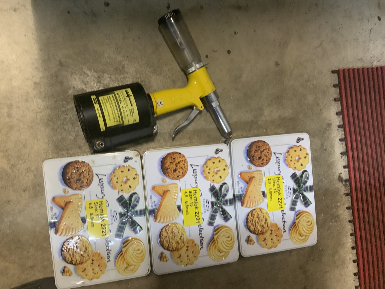

Lord give thanks to eblagAs said, special things with a special (expensive) tool to install them.
I've got a substitute that screw up if you need some
Rivets were skip dived, and the gun was poorly listed for 25quid.Lord give thanks to eblagRivets were skip dived, and the gun was poorly listed for 25quid.
What about the biscuits?Lord give thanks to eblagRivets were skip dived, and the gun was poorly listed for 25quid.
