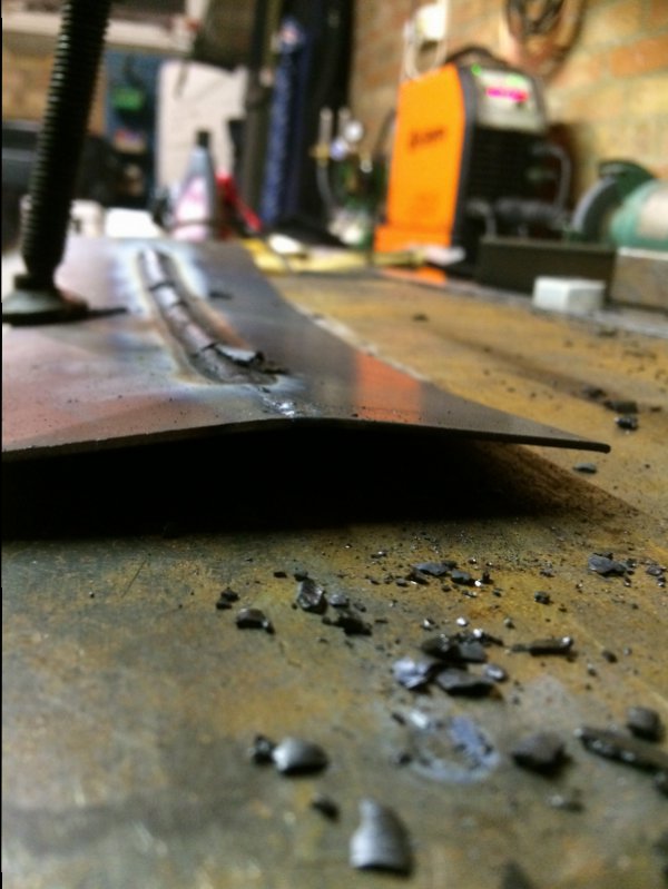

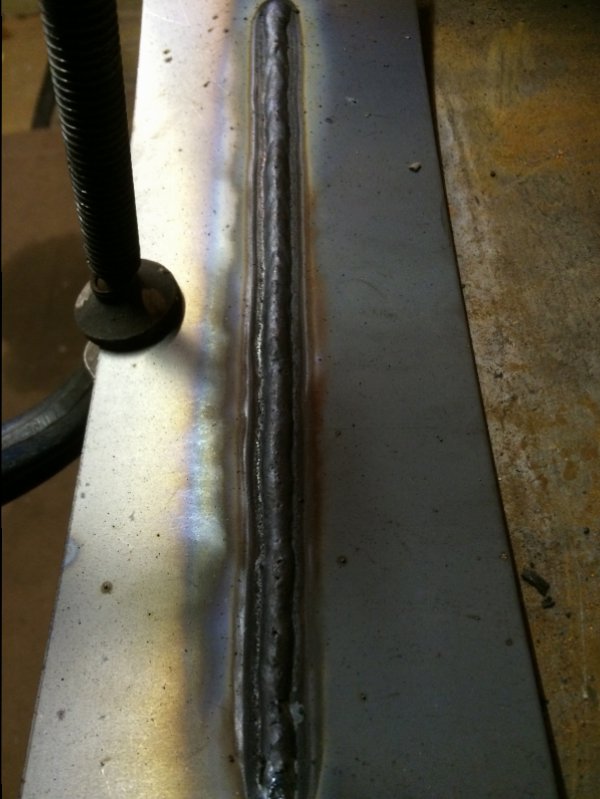

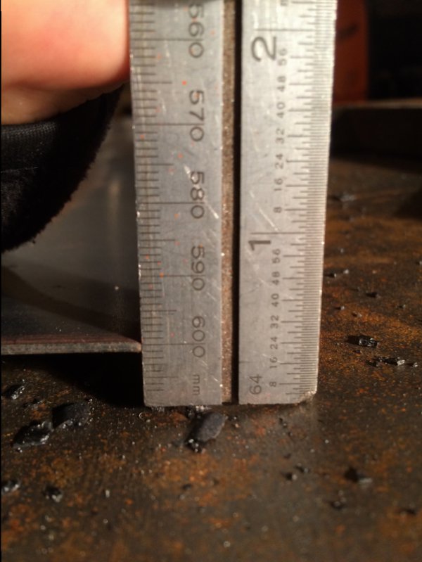

I've welded a cracked garden spade, which was about 2mm using 1.6mm 6013 rods on an Aldi buzzbox (the 160A fan one, not the newer one) at about 55A. The crack ran the full width of the blade about halfway down. Weld's still holding despite using the spade to dig holes in soil.
As said above - a heat sink behind and not being too bothered about the repair being neat. Definitely practice on scrap first though to get an idea of just how quickly 1.6mm rods burn down -it's all slag and barely any metal. I've used 2.0mm rods too on 3mm steel with far less bother though. I don't think 1.2mm is worth even trying - that's firmly in Mig/Tig territory.
I certainly wouldn't do it on anything that it'd matter if the weld failed on. A dodgy repair to a garden spade so I can finish putting some shrubs in until I can get a new one is fine though
