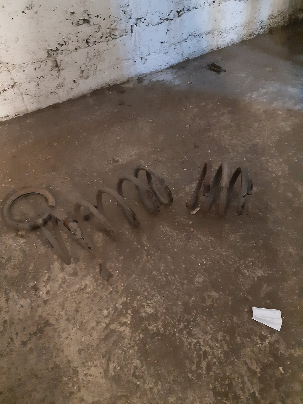

Also, A combination of age, lack of current use, heat/cold cycles over Winter etc. Couple that with deterioration of the plastic coating allowing water ingress and you have the perfect recipe. Oddly, they uually break right at the start of a journey & seldom while 'on the move'.But they do not break.
]. 2 in 3 weeks on mine, plus one each for the neighbours on either side of me [both Fords - one rear & one front]. The recovery garage chap said they've had quite a lot in recent weeks/months too.But you drive on smoooth French tarmac, unlike in the UK.Also, A combination of age, lack of current use, heat/cold cycles over Winter etc. Couple that with deterioration of the plastic coating allowing water ingress and you have the perfect recipe. Oddly, they uually break right at the start of a journey & seldom while 'on the move'.
Ohhhh, yes they do [pantomine voice]. 2 in 3 weeks on mine, plus one each for the neighbours on either side of me [both Fords - one rear & one front]. The recovery garage chap said they've had quite a lot in recent weeks/months too.

I had both rear springs replaced on the e60 last Wed after the o/s one was found to be snapped when I went to change onto my Summer alloys/tyres [I know, later than planned but weather & other factors intervened

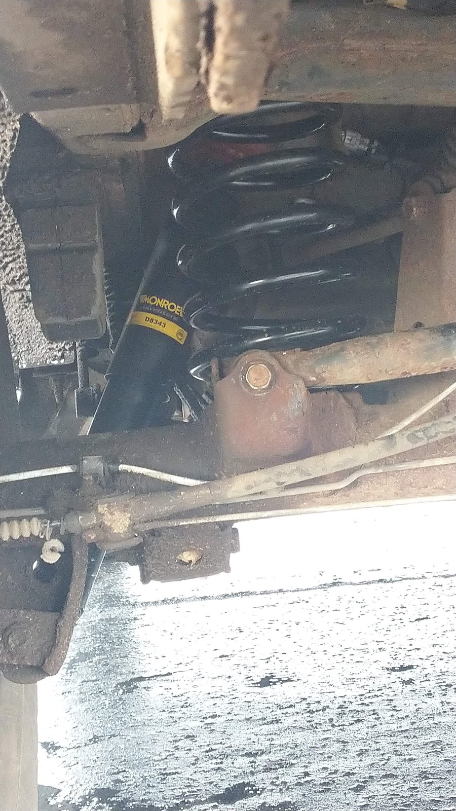

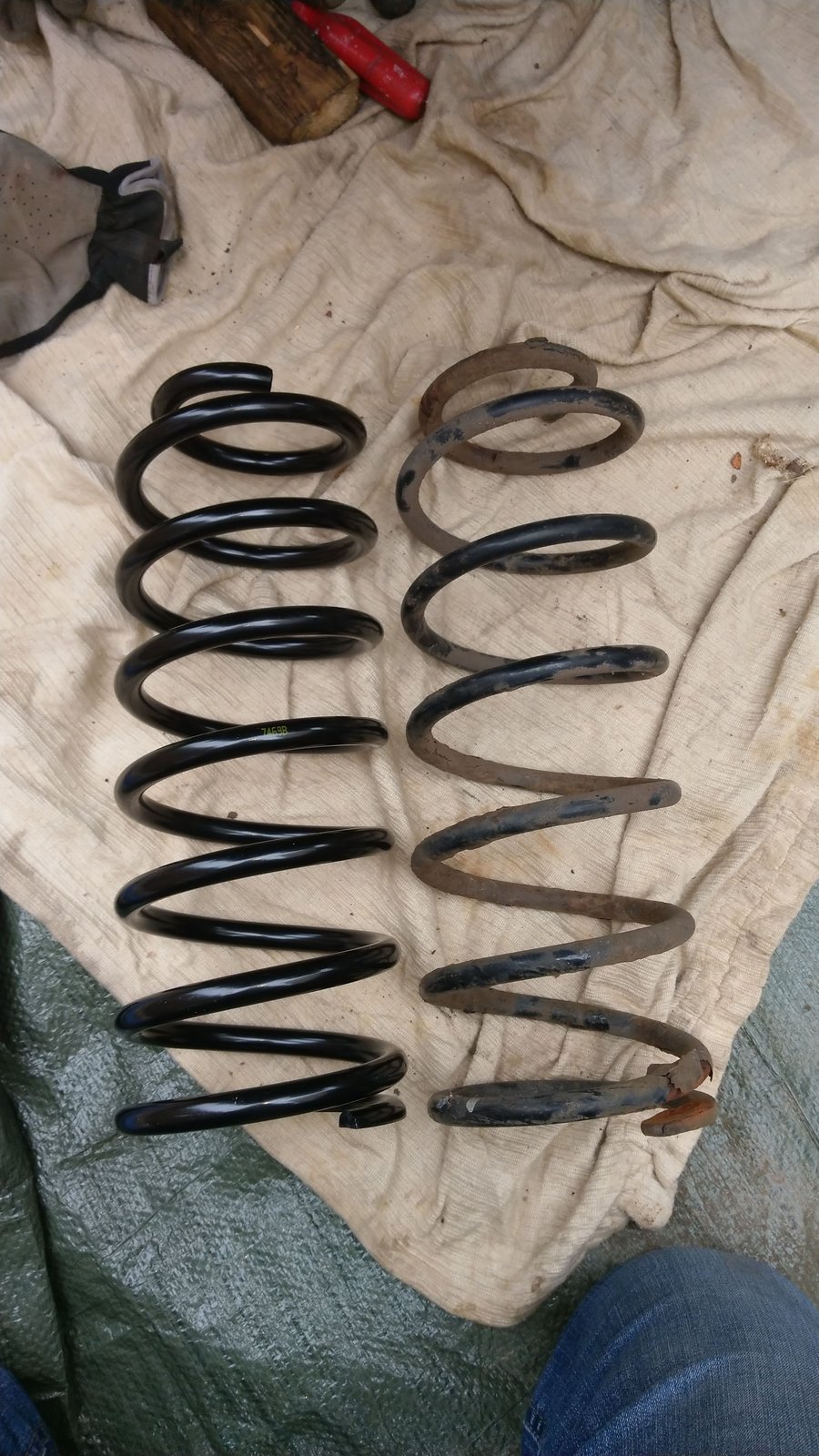

I've recently change the rears on my Surf but if I'd only done one side it would be sagging about 2" lower one side!
They don't look much different but it rides about 2" higher now.
