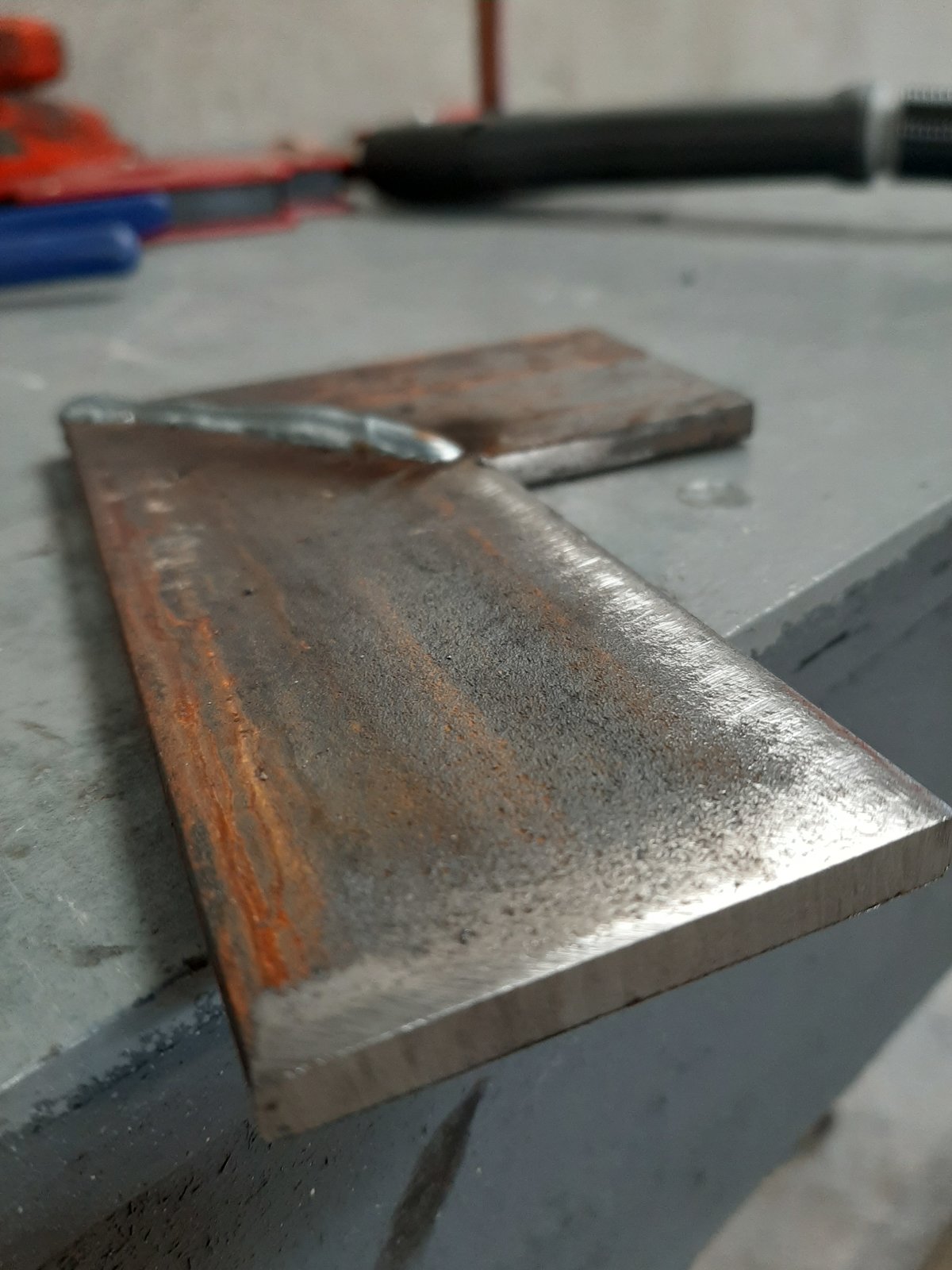

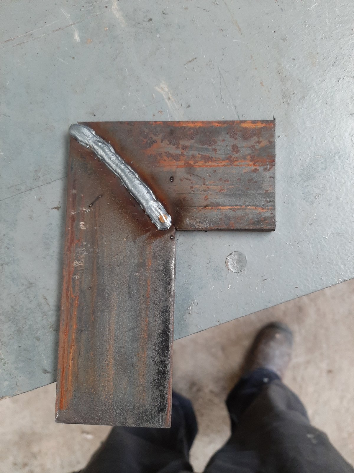

D Davey223 Member Messages 83 Location Ireland Jul 23, 2020 #1 What am I doing wrong 20200723_191848.jpg 292.7 KB · Views: 174 20200723_191906.jpg 207.3 KB · Views: 161
MattH Member Messages 4,515 Location Cornwall Jul 23, 2020 #2 Not enough heat and moving too slow. that’s thick, I’d be on 200A to weld that. what set are you using.
E Ed. Member Messages 1,069 Aug 10, 2020 #3 Did you remove the mill scale ? and it would be better if you "veed" or beveled the edges to be welded, it does look like it needs more amps as it weld bead appears cold. If your machine is maxed out then beveled edges will help greatly.

Morrisman Forum Supporter Messages 9,063 Location Staffordshire, England Aug 10, 2020 #4 No weld prep?
Barking Mat Cuddler of hedgehogs. Messages 13,593 Location France, Brittany. Aug 10, 2020 #5 Cleaning it will help.

Munkul Jack of some trades, Master of none Messages 7,808 Location Cumbria Aug 10, 2020 #8 Laying a weld on top of metal and expecting it to "sink in" and look good. You have to have somewhere for the weld itself to sit!
