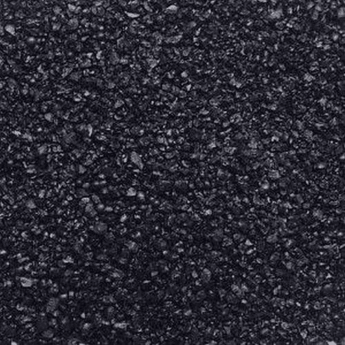

One year I used 12k lbs of medium black beauty (coal bottom ash) doing large beams.

its preferable to keep a constant 90 psi pressure up without dropping otherwise it alters the ratio of media and air and gets less efficient
