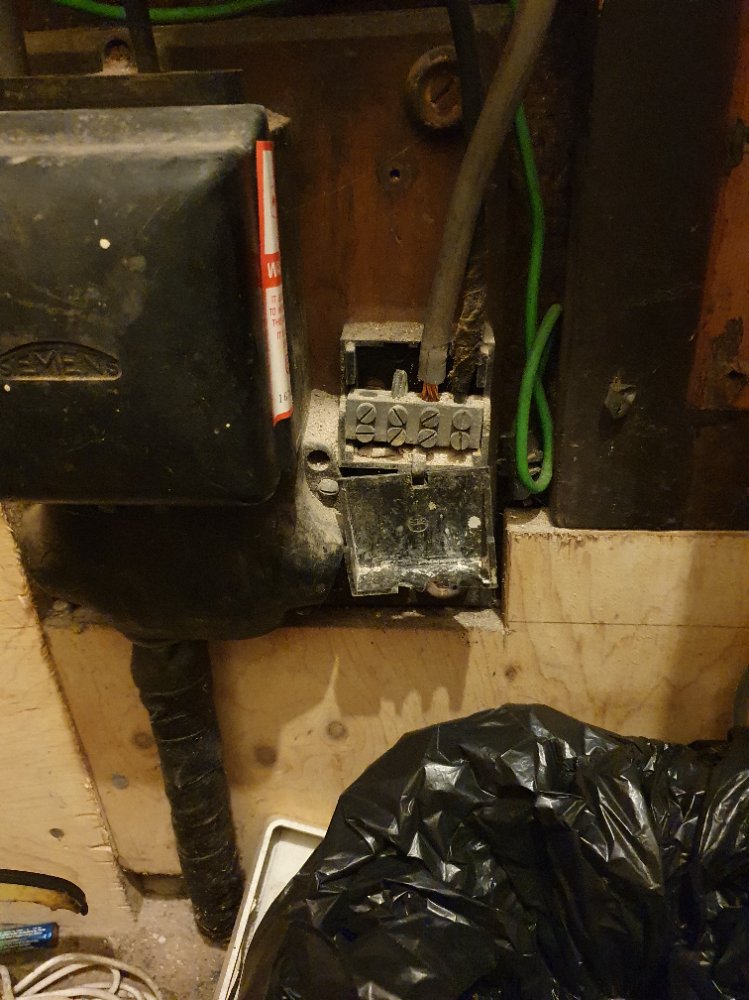

Perhaps the inspectors dog wasn’t allowed in the cupboard?Who has been doing the "checking" ? Stevie Wonder from his home in the US? Or is this one of those "drive by" inspections?
i done a yearly inspection myself at the decoration, carpets, appliances and general maintainance of the property etc but never put my head into the meter box, i mean who does
The green house !Where’s the unmetered MICC cable going?

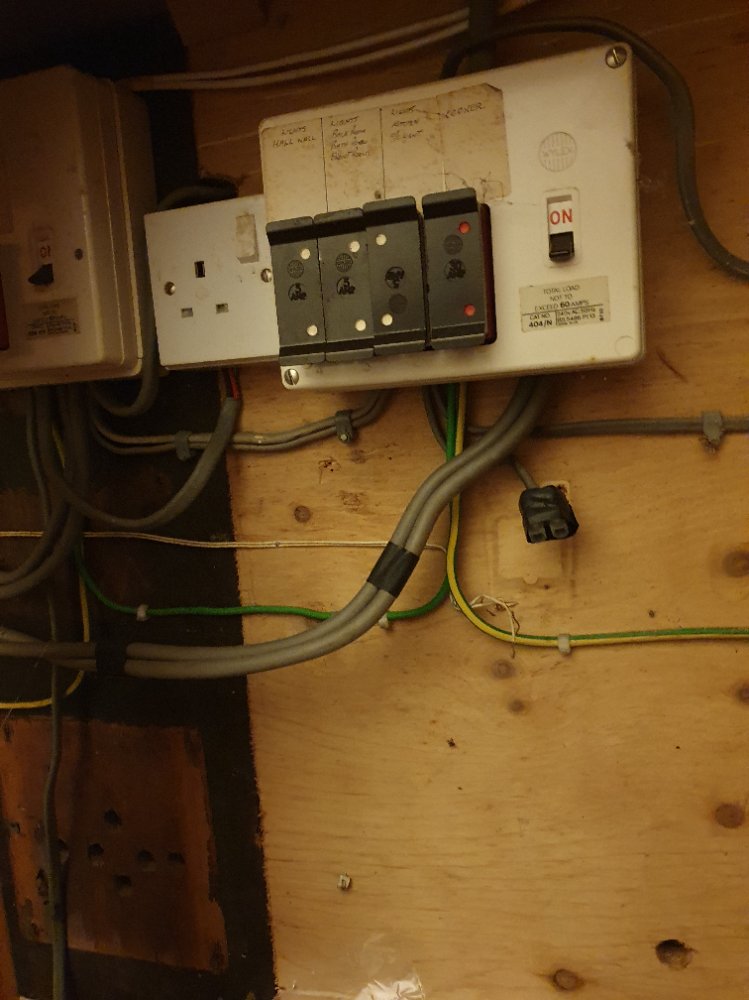

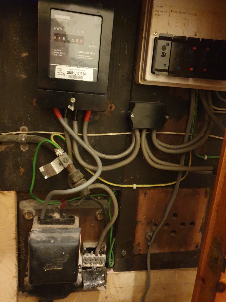

going by that it needs the whole lot checking overBit of a mess that!
The broken service cutout cover should be sorted by your supplier, the rest needs a new dist board or two.
Time to fit a smart meter![]()
note the right hand 5 amp white fuse
the whole lot should have been rcd protected many moons agoyes i did in the mid 80,s....been a rental since in the hands of a few letting agencys...i now live in it from 2 weeks agoDidn't you look at it when you bought the house?
get it sorted asap preferably without carpets and junkyes i did in the mid 80,s....been a rental since in the hands of a few letting agencys...i now live in it from 2 weeks ago
