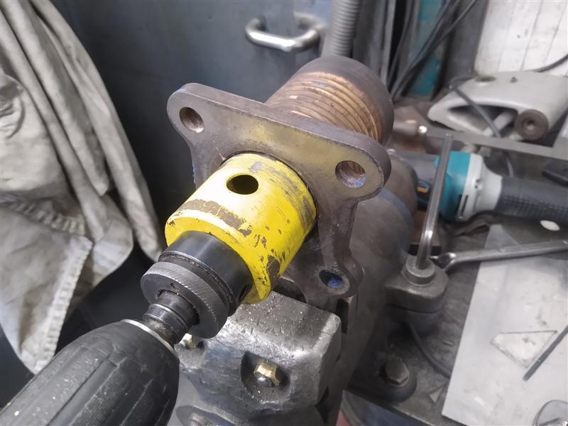

I knew I could never weld that back in place so I had a think and thought there might be a chance I could weld to the rounded top of the first bellow. So to get access I cut the pipe below one of the bellows and drilled the weld out of the ends with a tank cutter.
This released the end for good access. I cleaned it up with a wire wheel for welding. Didn't dare use a linishing pad on it.

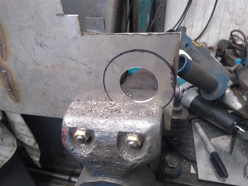

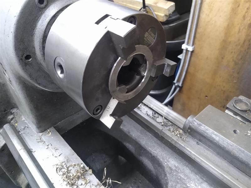

I had some thin stainless sheet so I cut a couple of donut rings out of it and turned them to size on the lathe.

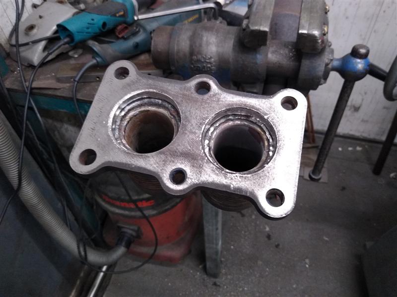

From here it was my intention to run a fillet weld around the inside to fix the ring to the inner tube. This turned out to be impossible (or at least beyond my skill level) because no matter how I tried the lip kept burning away. This was with a 1mm tungsten and about 40amps with the pedal fully down. It melted away before I even got to full power. Still, it came out ok.
Now it might not be obvious but this is a twin downpipe and to get access I had to cut off one bellow at the weld, so this one in the pics was welded on the bench, the other was welded in place (which was a lot more tricky, damn exhaust are difficult to position). Anyway, after welding both I then welded the loose one back onto the pipe.
