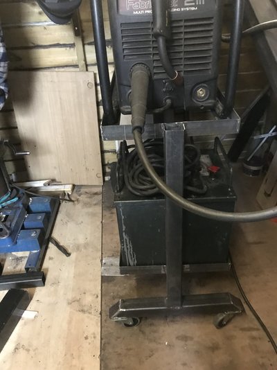

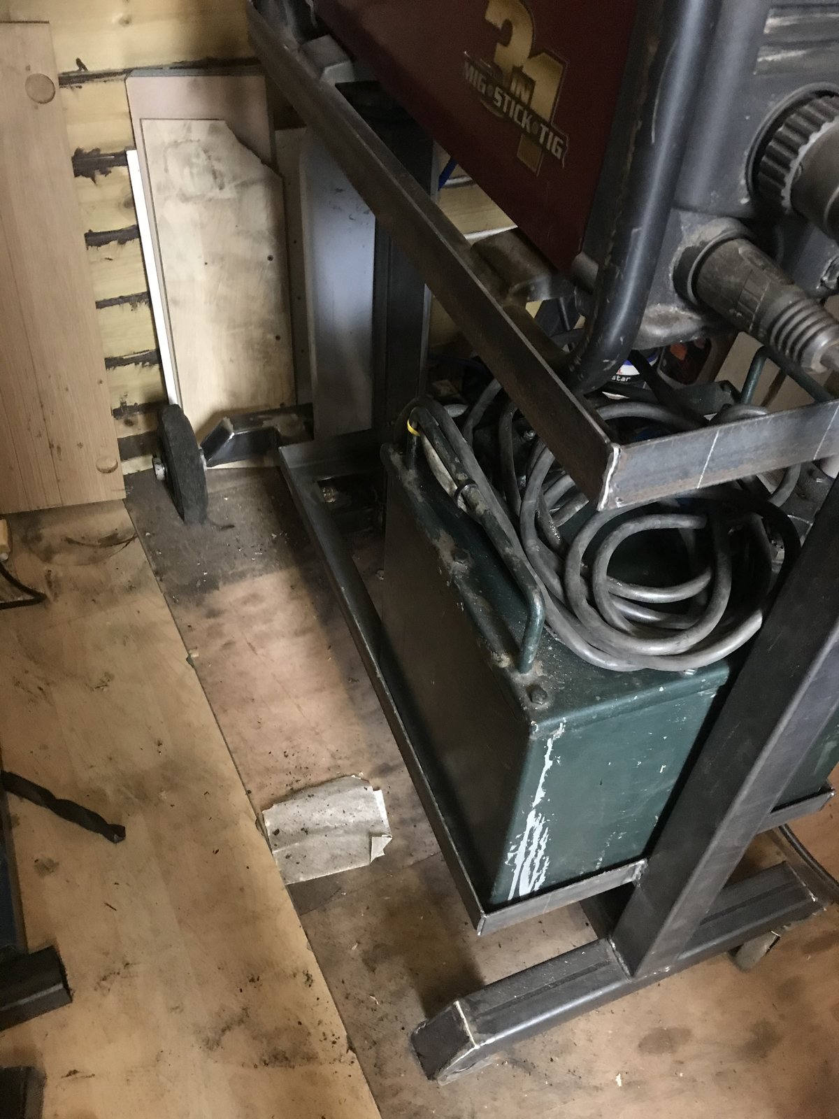

yes mate its mate out of 50x50 box section and 40x40x3mm angle iron least I can move it about and I can see the difference in my welding to the other crap one i hadAt least you have a low centre of gravity![]()
yeah the hoops are better ill see if I can bend the 10mm round bar I've got im in a shed you see not a great deal of room be nice to have a lot bigger place but im only a hobby man learning how to weld lol I can see how I've progressed from when I 1st started using the MIG welder and arc welder more practice and more practice is the key i thinkoh, and a pallet truck is my mode of transport...notice the drawers...them and the welder tray all on roller bearings....

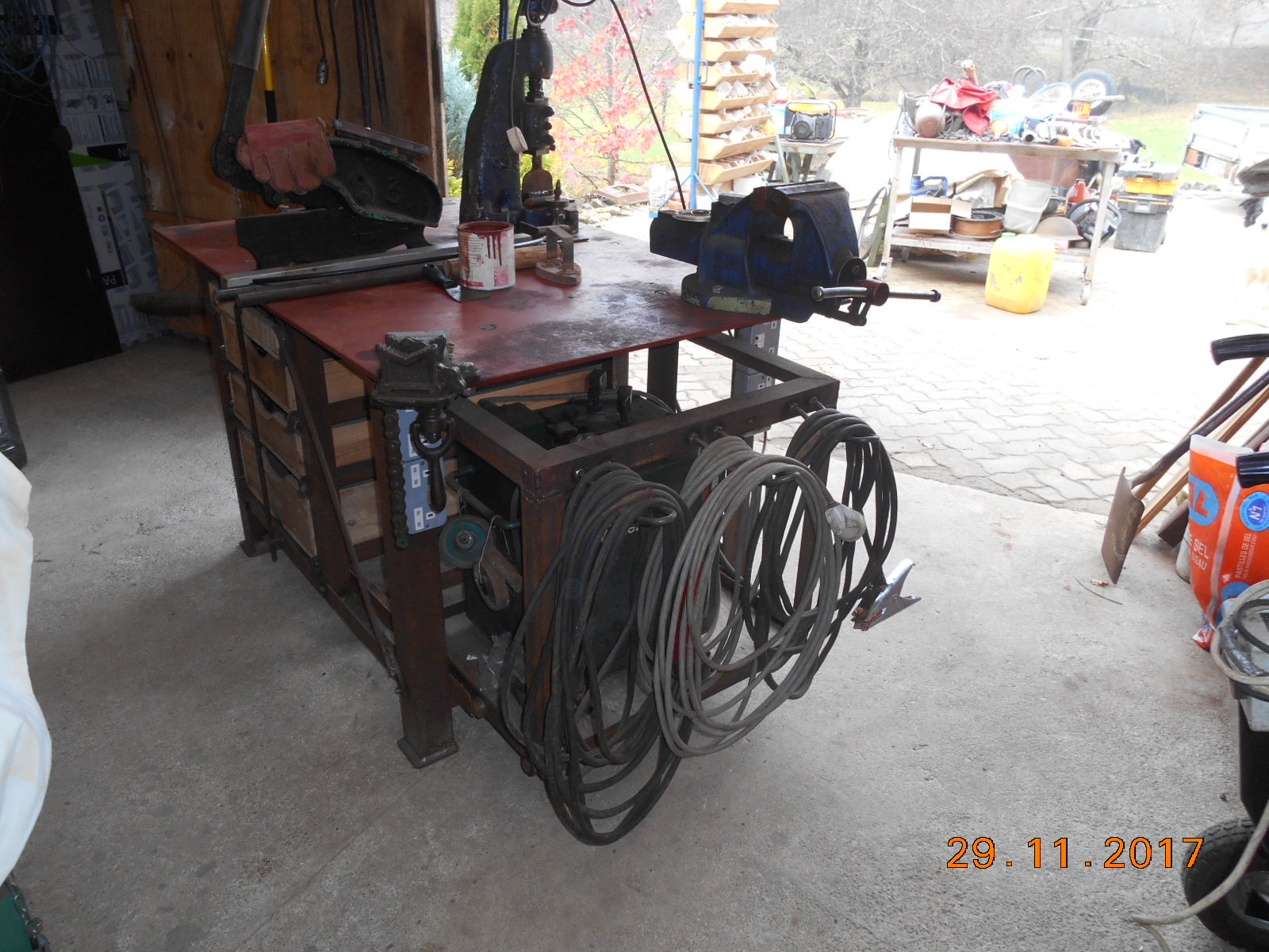

it weigh's about 1/2 ton with the tooling...

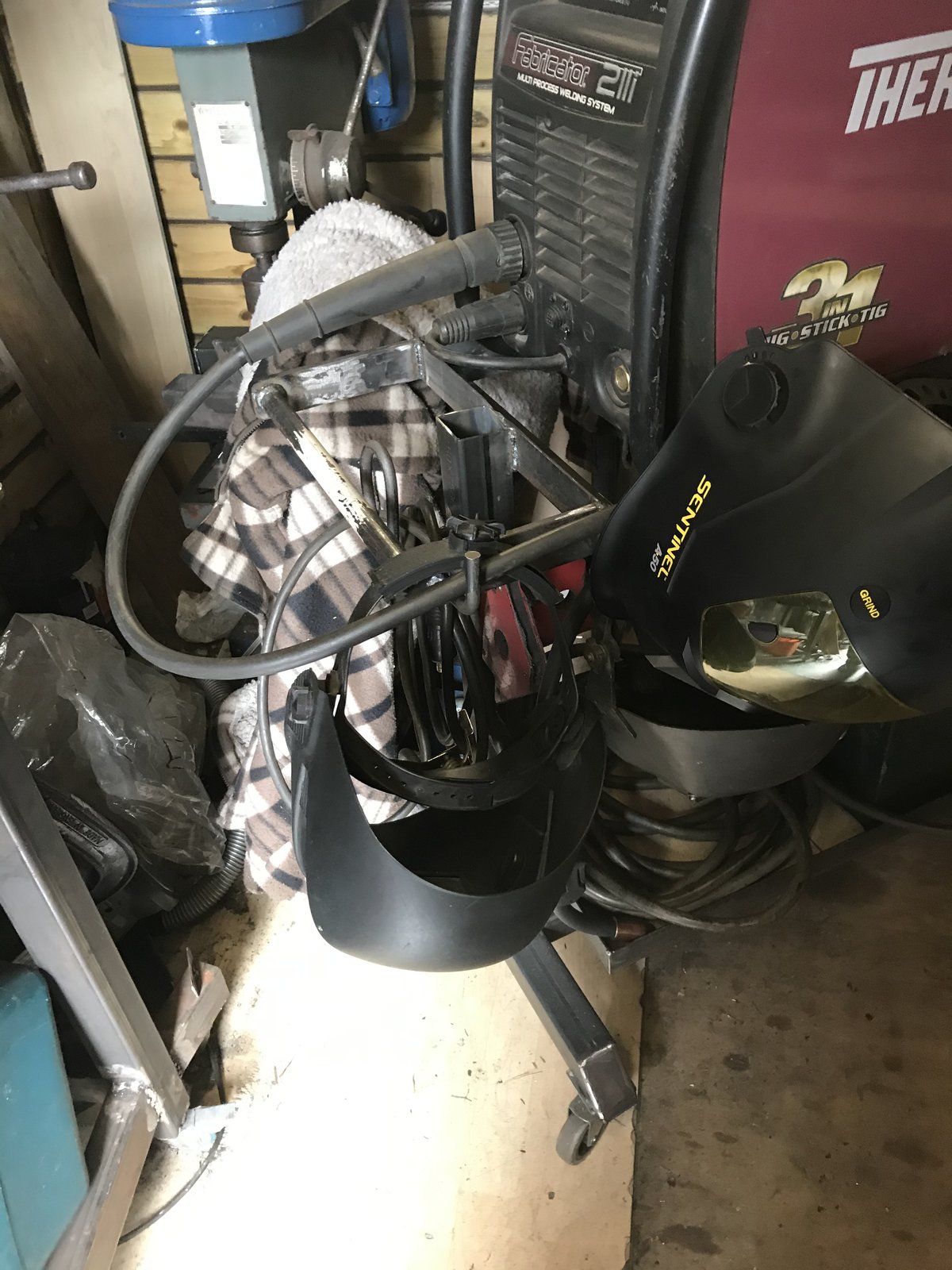

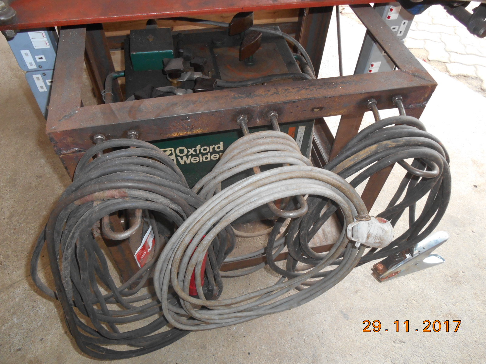

slightly different but the wire loops work better than hooks....u dont get snagged on ur overalls...
not quite a trolley and not often that clean.....hahaha
