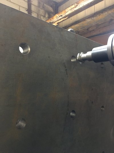

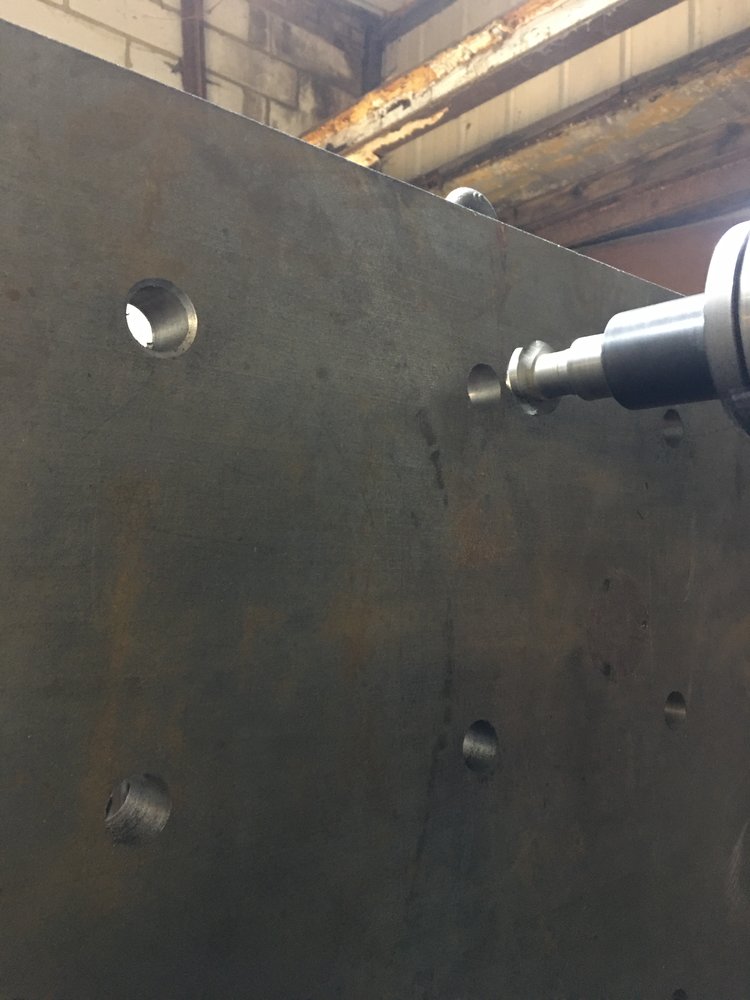

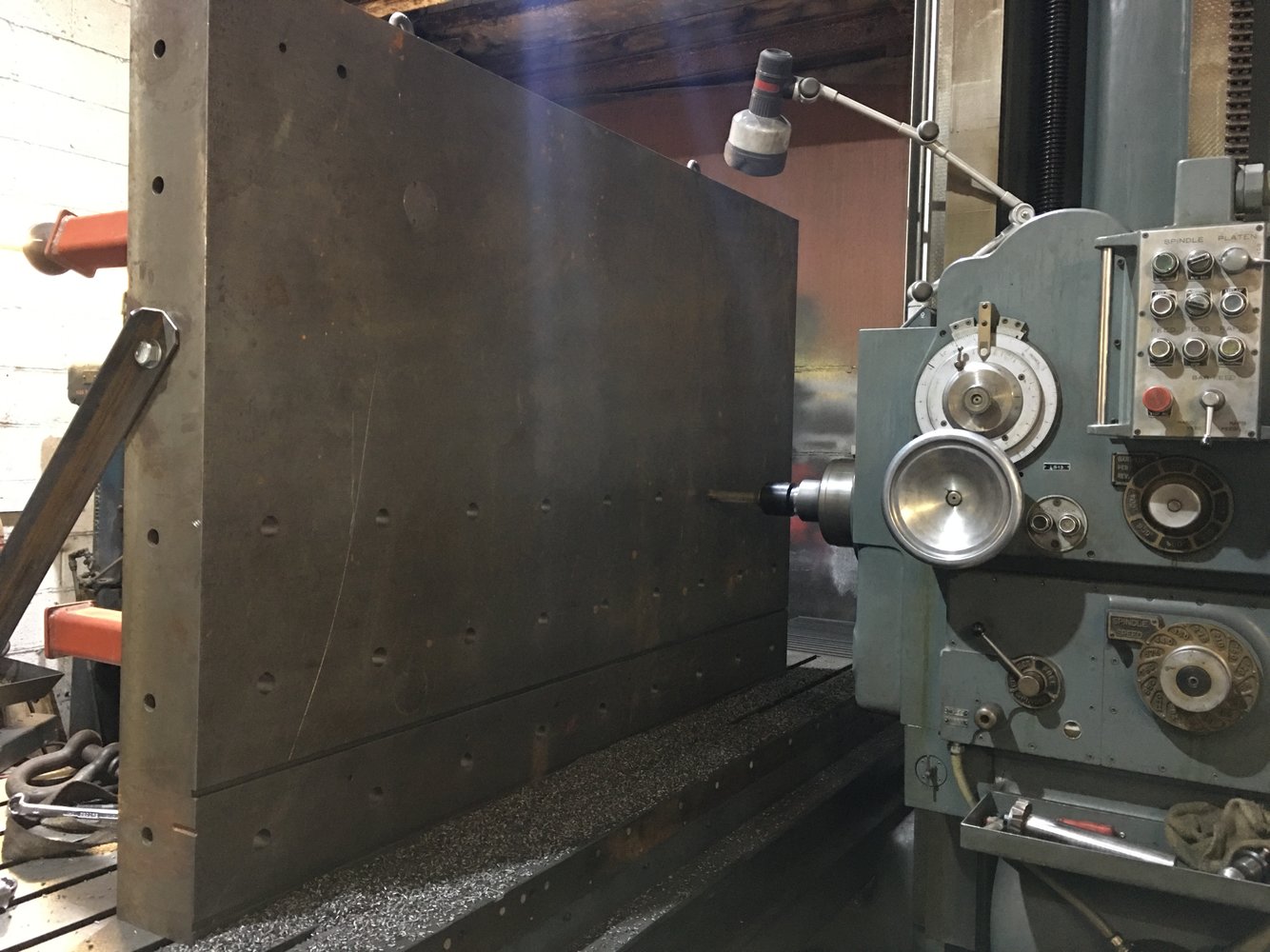

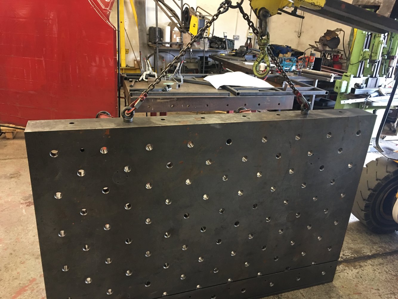

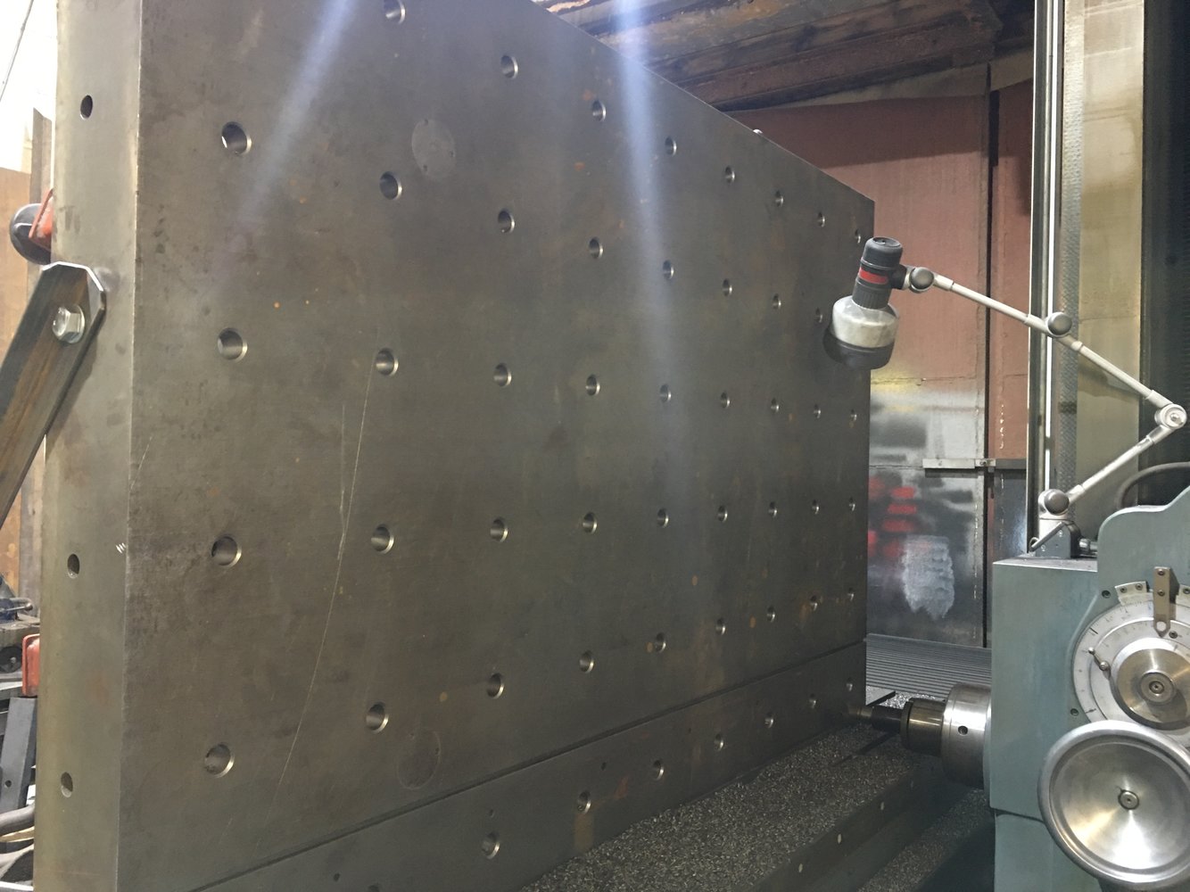

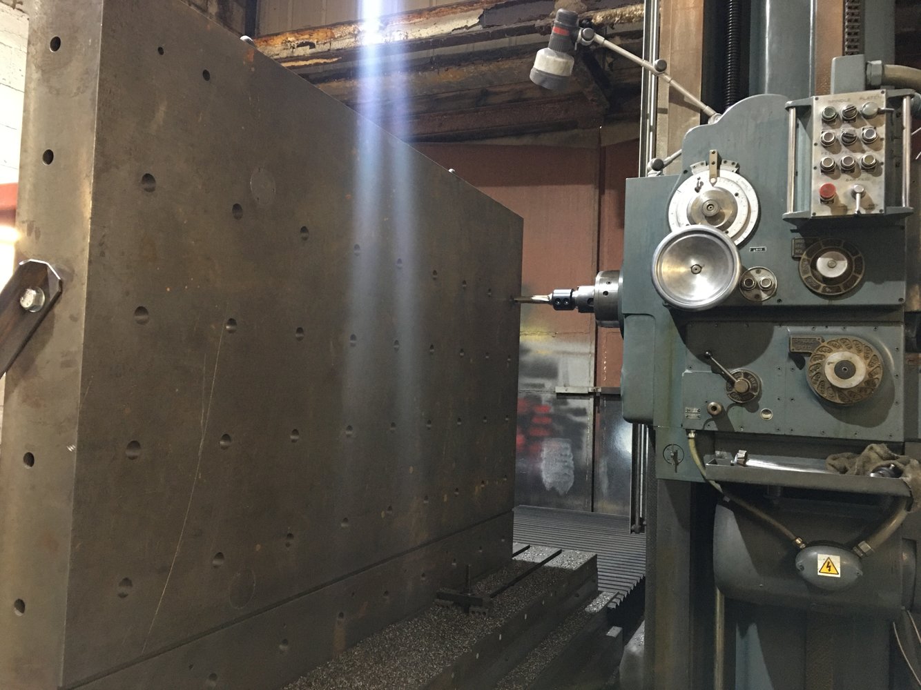

A neighbour has removed a old cmm with its heavy bed plates.
I’ve started machining them for fixtures.
200mm centres as there’s a lot of webbing to avoid
28mm pins
