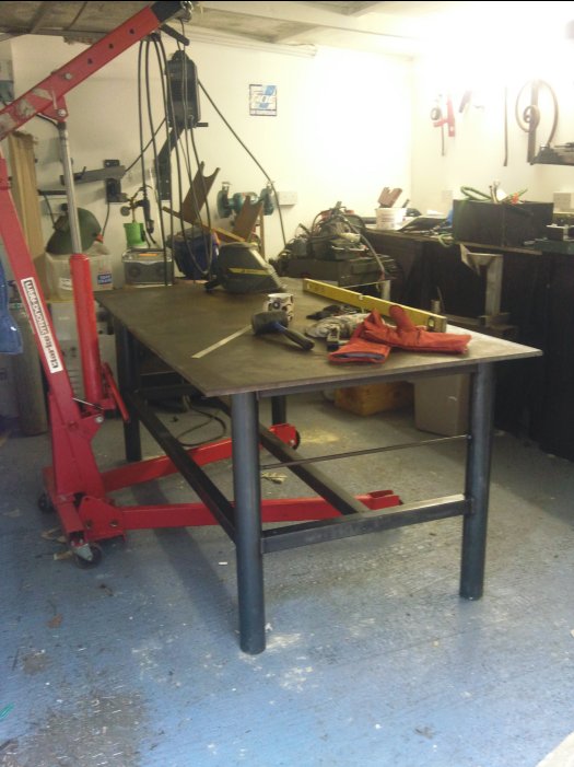

The force goes down the legs into whatever it's stood on, tables don't go round corners so why should there be any need for diagonals ?
Not sure we understand each other. What I was thinking was the table has no geometry to prevent what happens in the picture.
Only thing stopping that is the vertical height of the welds on the end of the tubes. My query was to whether that would be enough.
