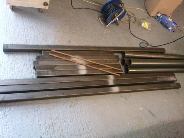

Anyway, the build, steel turned up this morning. SHS (box section) is 50x50x2.5, CHS (tube) is 76mm 3mm wall. Top is in the background, 15mm thick, 2x1m.
After cutting.

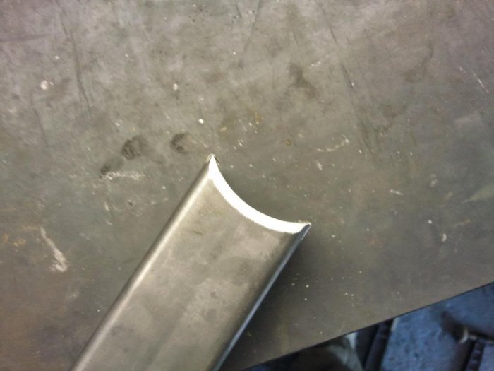

Ends of box notched.

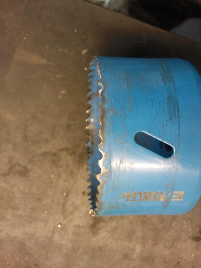

The resultant mess made of a cobalt holesaw (also destroyed the gearbox on the drill, would have used the pillar, but i`ll be ******ed if I know where the chuck key has gone, it was welded to a chain, that in turn was welded to the drill)

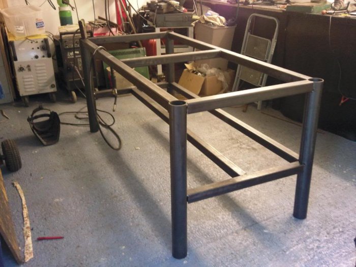

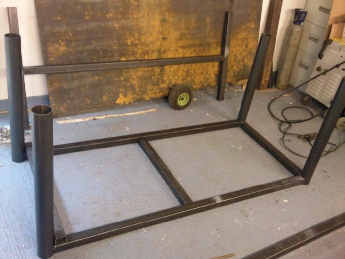

Dry assembled
And tacked ready for completion tommorow
