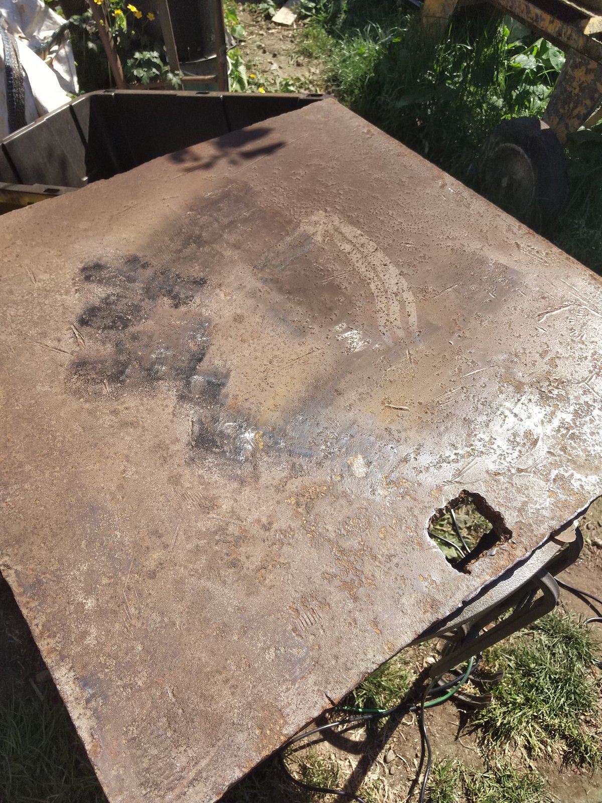

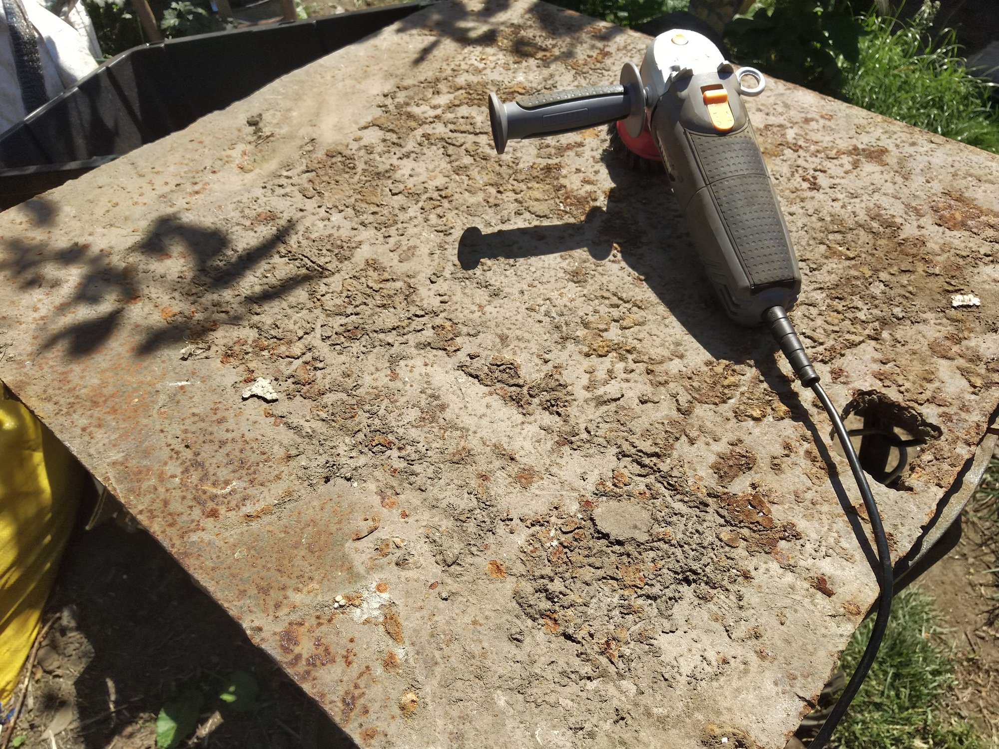

A *long* time ago - probably 20, at least - I "found" 4 pieces of 18mm roadplate.
One of them was converted into a table for an old table saw.
The other 3, after a few years service as a workbench top, have been used as paving for the last five years.
I'm needing a new welding table to make some outrigger cupboards for the trailer, so I've dug them up.

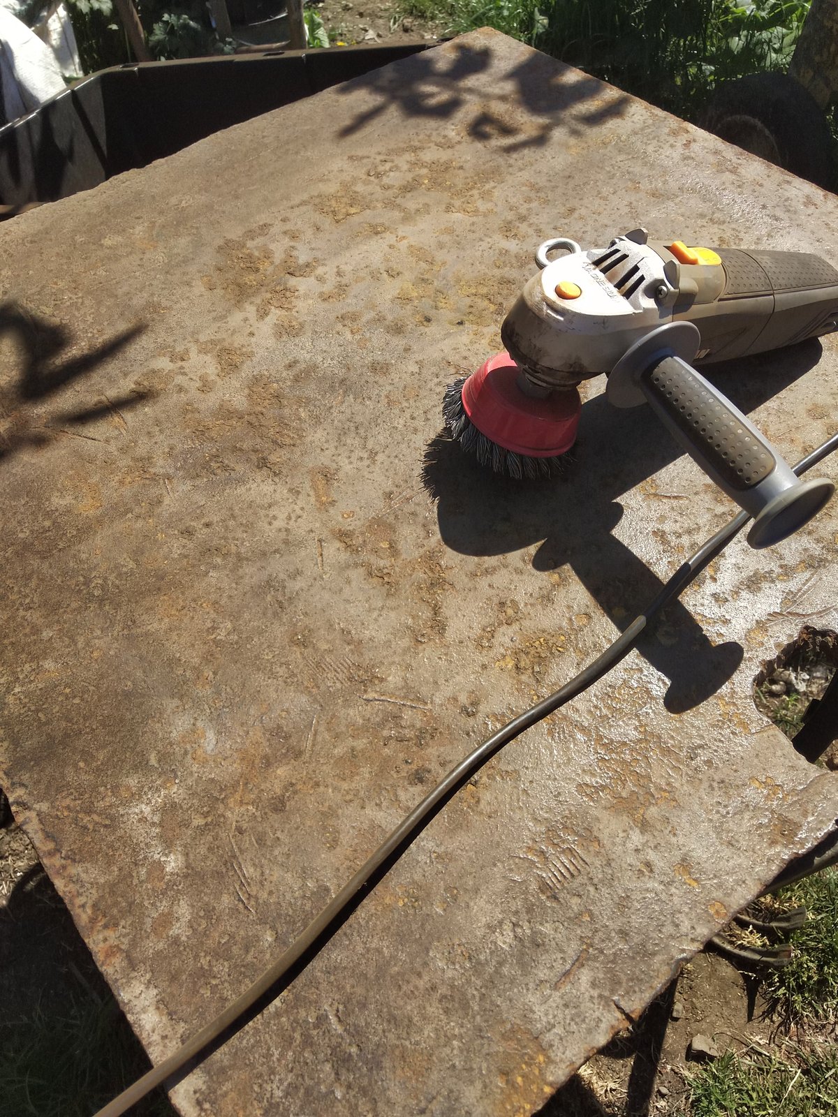

A tickle with the cup brush:

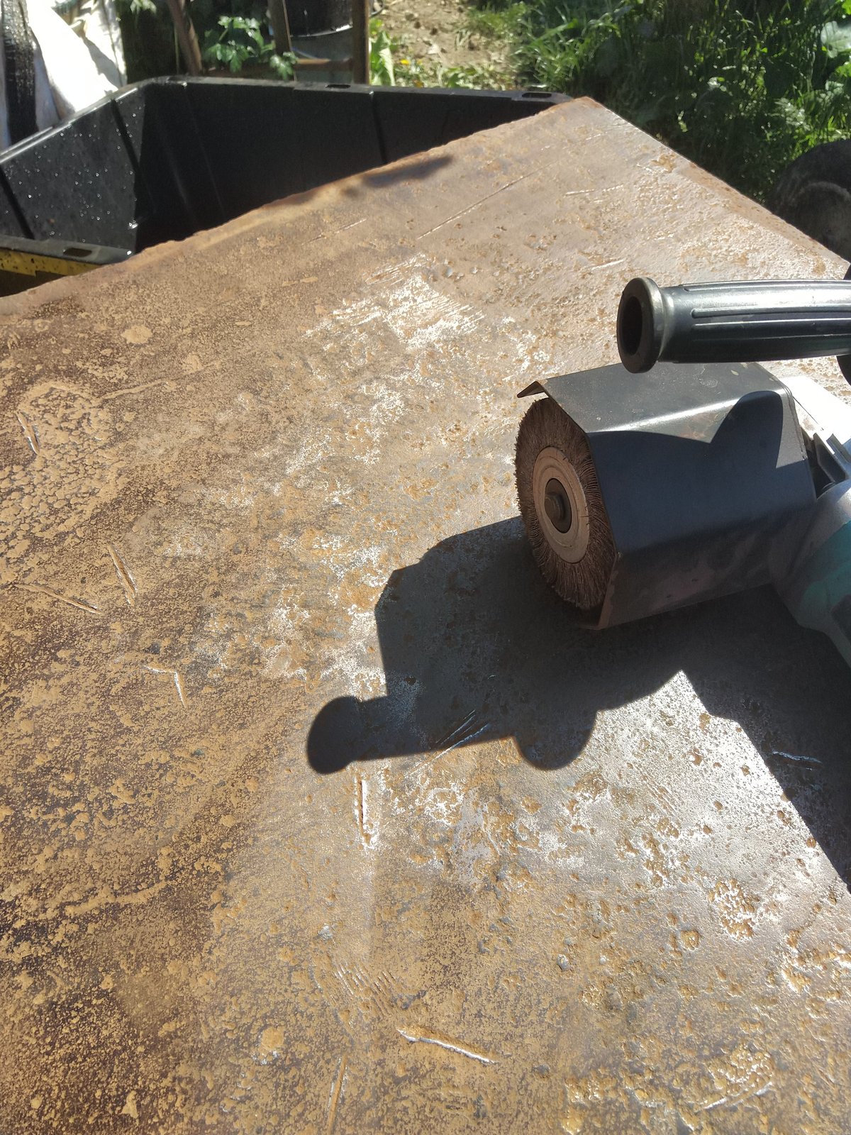

Then a once over with the katsu wide sander, using a 180g wheel.

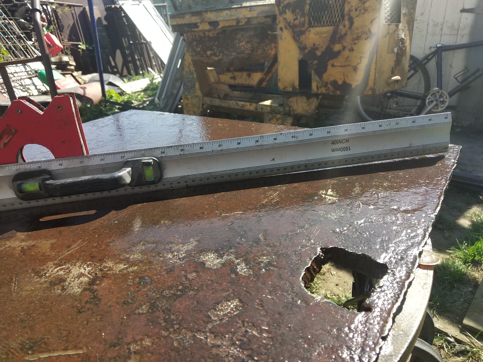

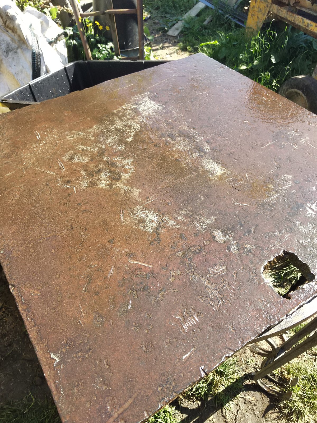

And rinsed off after ten minutes:

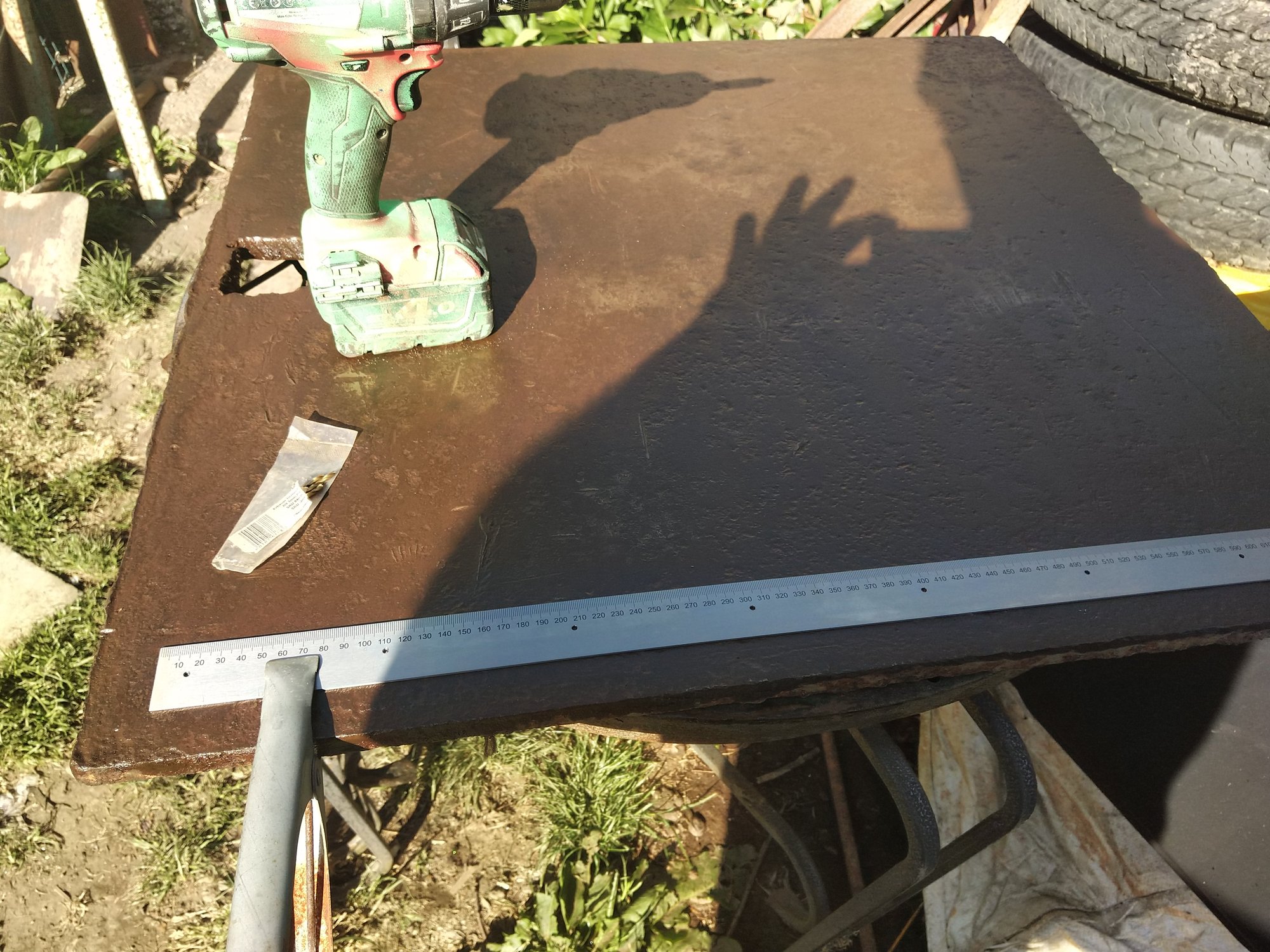

Another going over with the Katsu, and a coat of linseed oil.
Its got a 5mm bow corner to corner, which hopefully will pull out when mounted to the bench.
But its near enough for now.

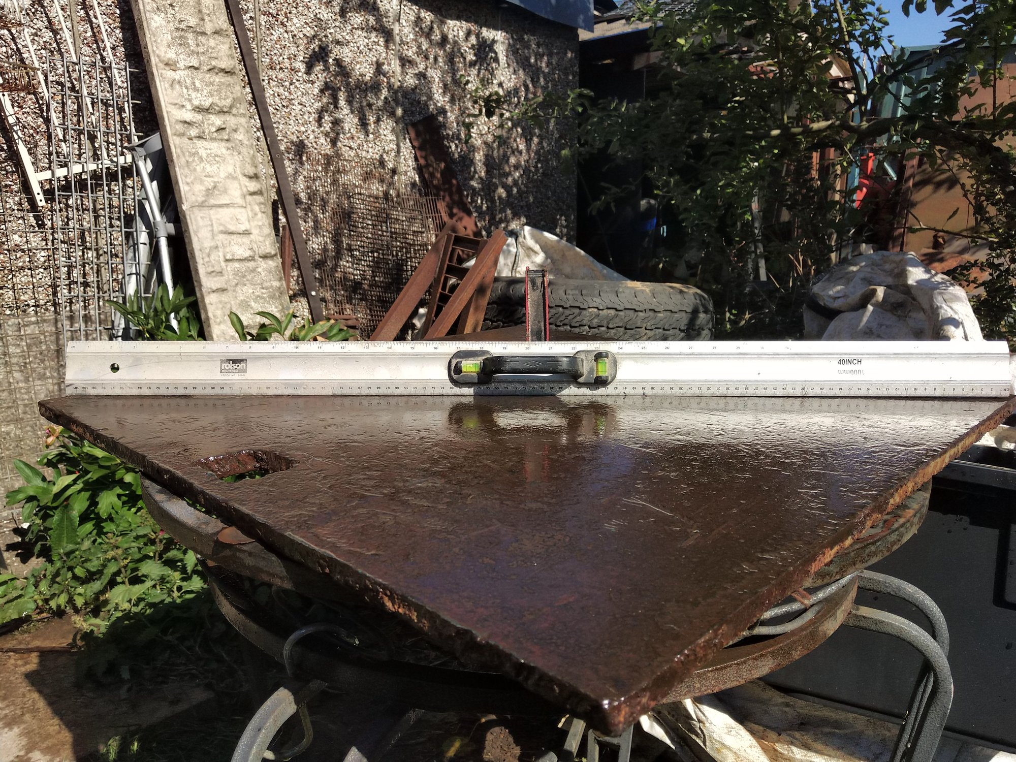

or at least until it becomes a problem.
