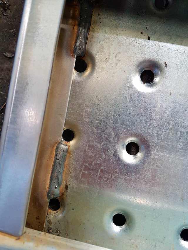

I have been experimenting with my welder ready for the chassis repairs. Initially I used the R-Tech recommended figures for 2mm steel which was woefully inadequate. I am test welding on an offcut of the galvanised steel C section after grinding off the zinc. I have kept increasing the power and have not yet managed to blow through despite being nearly at the maximum settings.
Changing to the old rusty piece I cut out, I can blow holes quite easily and need to make the travel speed much higher and weave to avoid it. Even then (of course) I am seeing excessive penetration. The issue I am going to have is joining the two pieces together, with the different settings needed.
Is it just down to the zinc coating on the underside where I can't grind it away?
I suppose that I can concentrate the heat on the galvanised steel and wipe it across. Either that or use lots of overlapping spot welds which seem to penetrate nicely?
