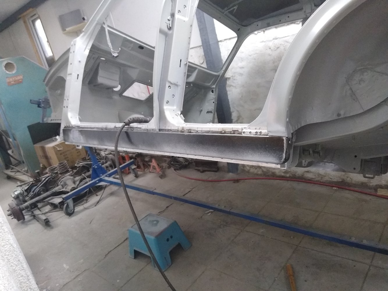

Remember MOT rules state continuous welds for repairs so tack welds every few inches are no longer allowable. However if you plug weld to replicate the original spot weld spacing then that is OK
