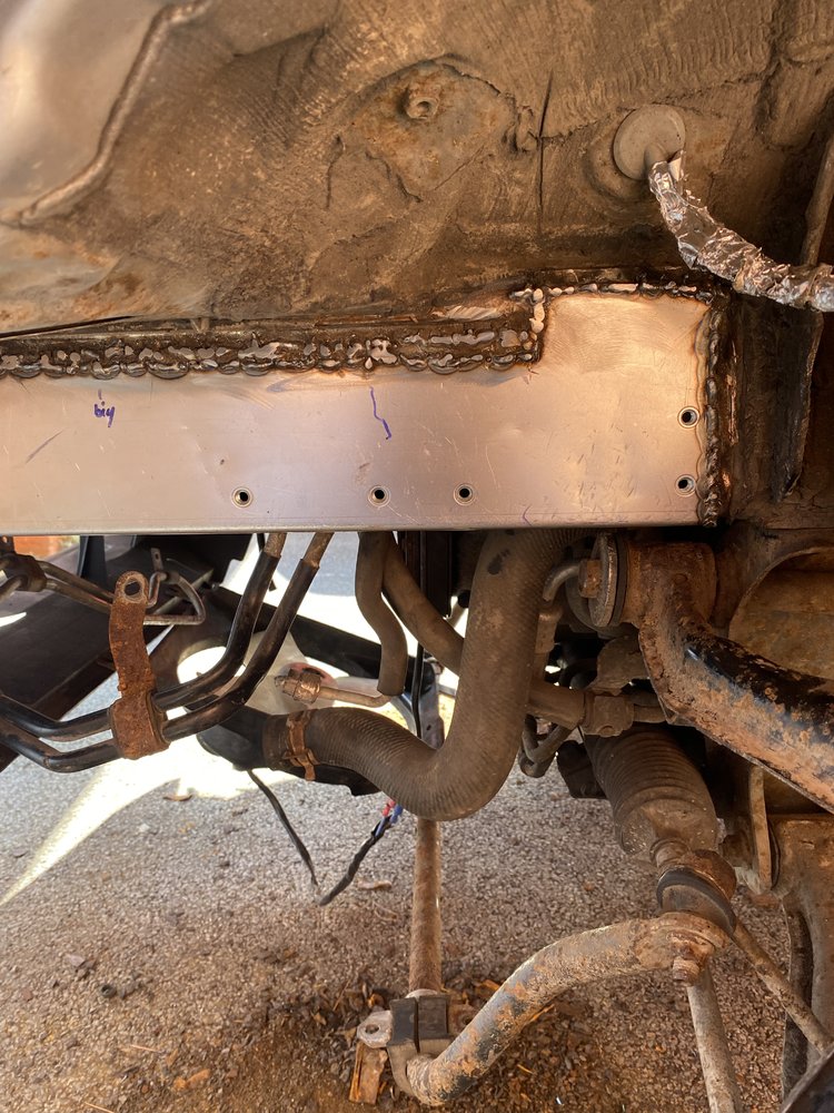

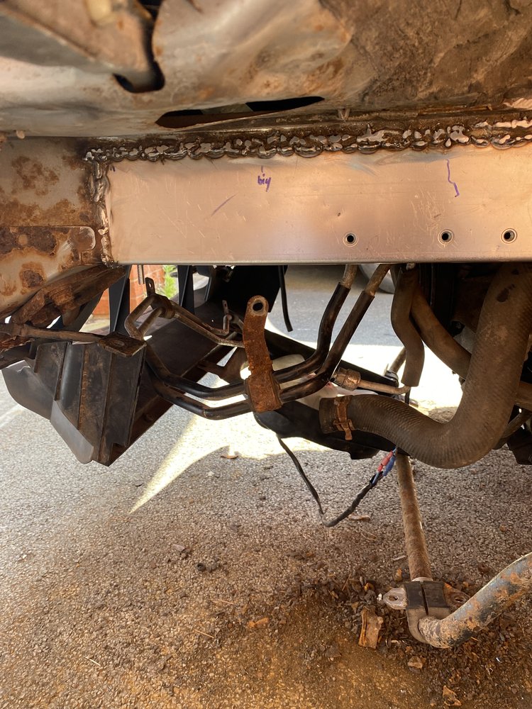

thats the thing though , its not just your life at risk is it , could be that young wife walking out with a new born or similar .I think that's pretty poor welding for a chassis rail. You need to practice more doing straight runs. I would grind those lumps off, get your settings and speed right, and wizz along it in one run. It's your life, but even if the mot man passes it, will you be happy with it?
Have you a decent helmet adjusted properly?
