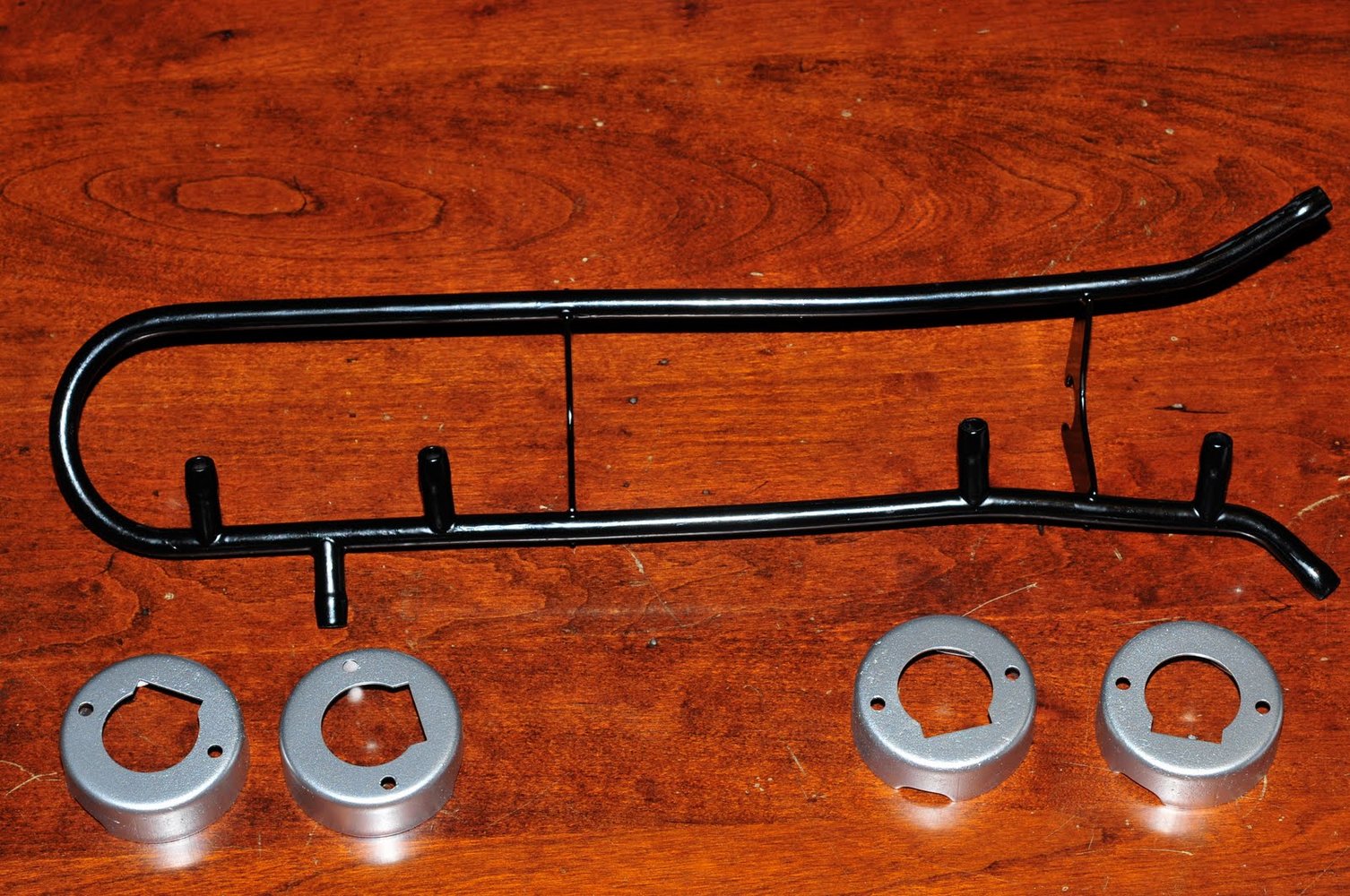

ChasesDragons Member Messages 98 Jan 28, 2021 #1 Hi all, Can you have a look at this fuel rail and tell me what kind of welding method is used to build this? Material - stainless (can you press nipples from them?) Its 8mm tube with 1 or 1.5mm thick walls.
gordon stephenson Member Messages 7,447 Location Skelton in Cleveland U.K. Jan 28, 2021 #2 Maybe silver soldered.
addjunkie Forum Supporter Messages 11,647 Location Northumberland. Reet oot in the sticks Jan 29, 2021 #3 What pressure is it exposed too
Pete. Member Messages 14,168 Location Kent, UK Jan 29, 2021 #4 addjunkie said: What pressure is it exposed too Click to expand... Old school petrol fuel rail is normally 43psi. More for turbocharged 1psi plus for every pound of boost.
Dcal Member Messages 3,839 Location Antrim Northern Ireland Jan 29, 2021 #5 Good luck, if it's a common rail diesel
ChasesDragons Member Messages 98 Feb 1, 2021 #6 addjunkie said: What pressure is it exposed too Click to expand... Good point It runs petrol, between 30 and 45psi maximally?
