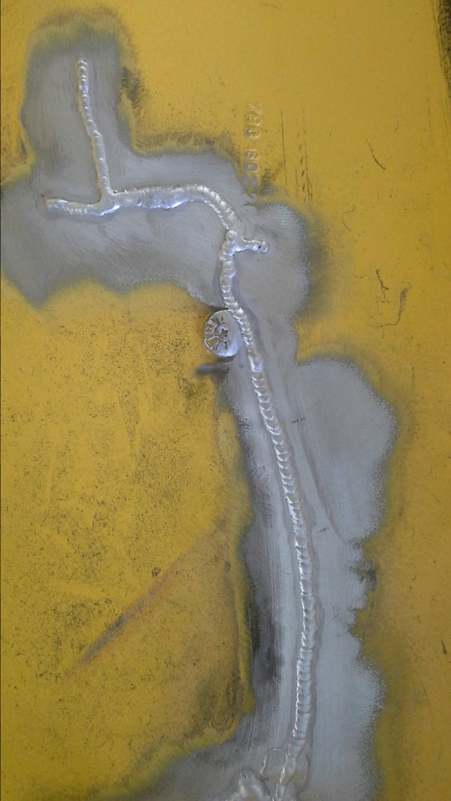

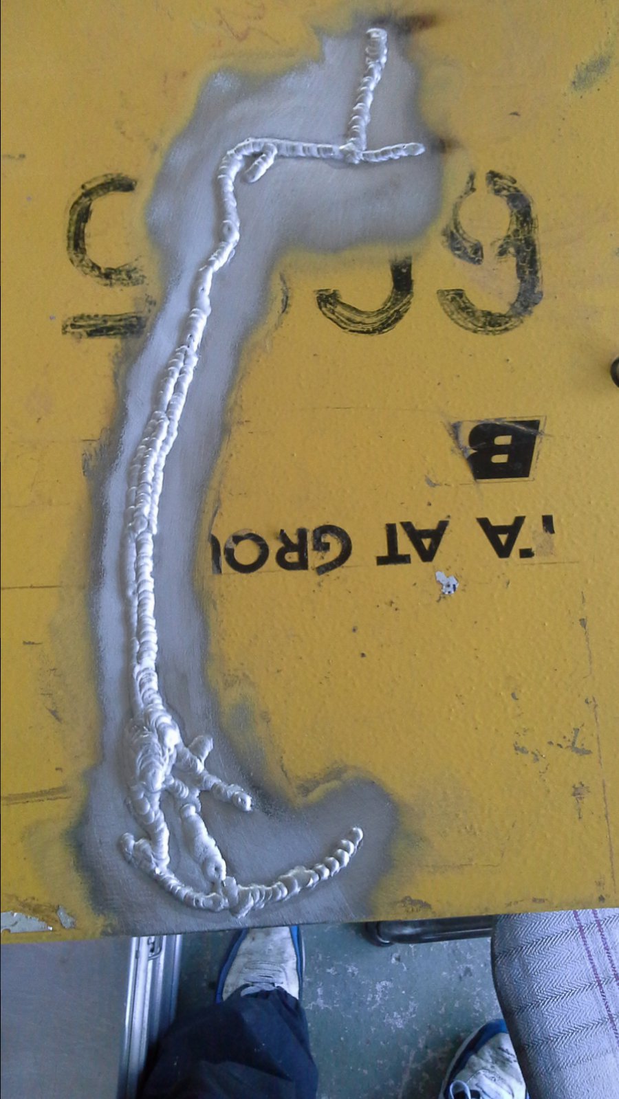

Mate!!!!!!!!!!!Right...results of my labours. My first go at cast ali. Didnt enjoy it much but got it done. @HughF & @richard thanks your settings spot on and after a bit of practice was happy to tackle the cover. Penetration good, in sone places weld showed right through so I was happy.
View attachment 107033 View attachment 107034
It's a minor thing and we all do it. The trick is just to go back and address them.Roger that, will do. Thanks for the comments, appreciated. Hugh did teach me about the end fil to prevent craters, clearly forgot on occasions
