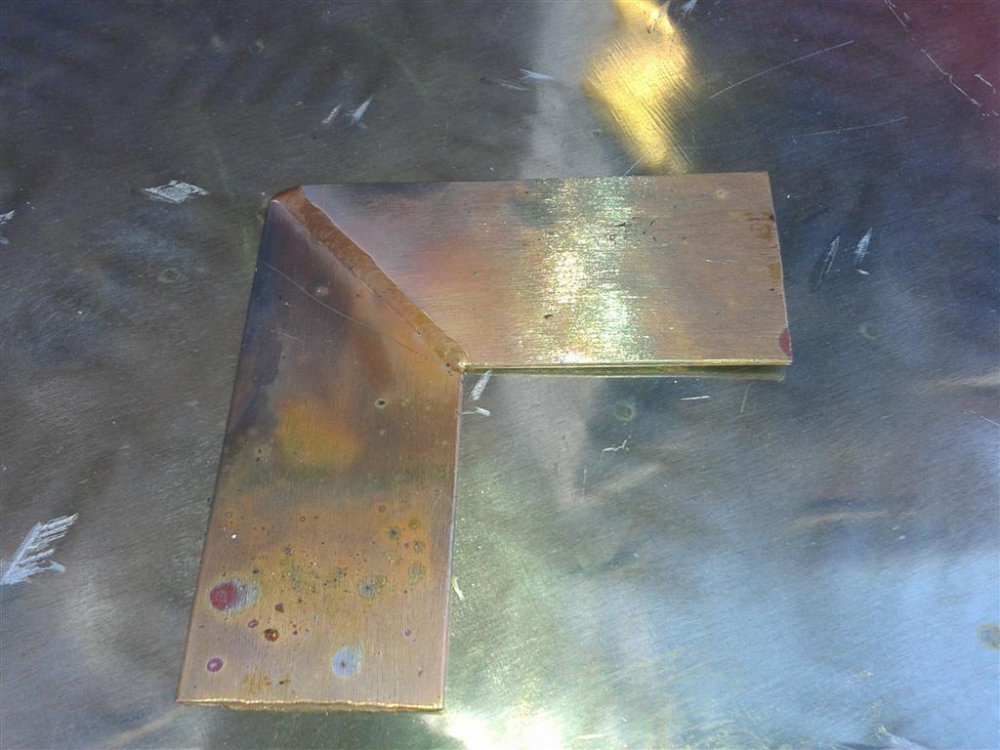

As said, unless the job is very small because of its high thermal conductivity you will need higher amps, I occasionally make some copper frames from 1.5 sheet, this is a couple of bits of scrap I used to set up the welder, filler rod was just a sliver of the parent material cut on the bench shear.
