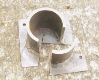

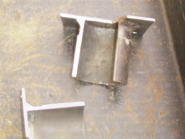

Just to clarify. We also do a test where we saw through the weld and examine with sulphuric acid onto weld to show up any defectsb. one macro section at 5x magnification
Thats called a 'macro etch' iirc.
