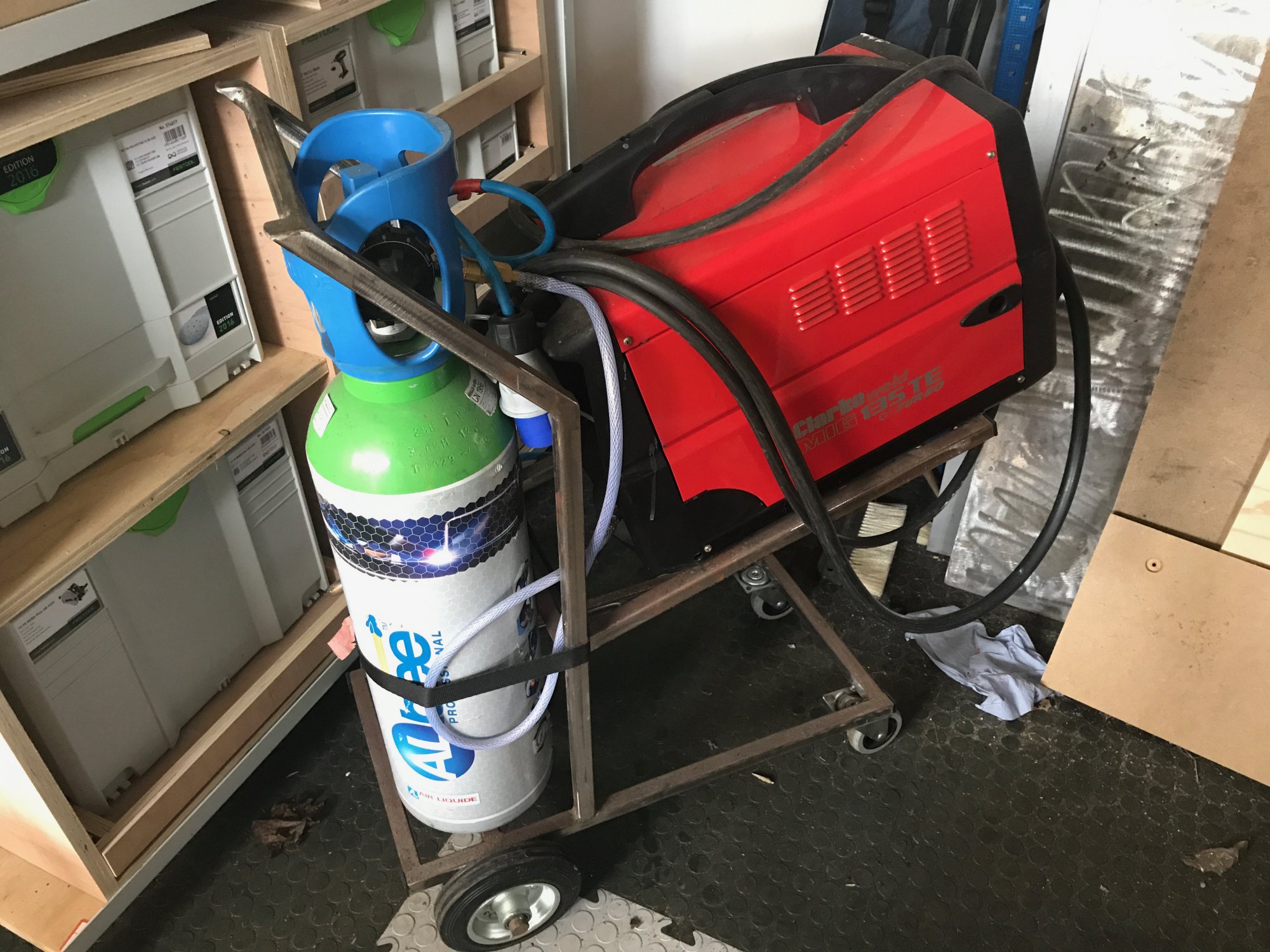

My cart was my very first project last year and I learnt some very valuable lessons the hard way. As others have said use good sized wheels/castors as even on a decent garage floor they can catch sideways, fail to spin and create a topple. This happened to me when i tripped over the leads with the whole thing crashing to the floor. Way too small front castors and too high centre of gravity = disaster :
