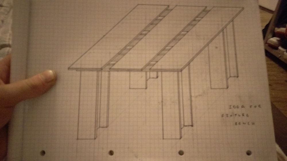

I think the seperate plates are m uch better.Ok I think I'm gonna get the top plate holes done by laser I have a few questions though what's to stop pins from falling through I take it you just clamp them in place with whatever project your working on. Also is there much point getting a pattern done like this.

I'd recommend you use the thickest possible plate for your table top or table slats. If you do decide to have the plates laser profiled, there are local suppliers who'll comfortably profile 15 or 20 mm thick plate. Thicker plate often comes in from the mill in a flatter condition, is much stiffer when under load as you handle and work with parts, albeit obviously heavier. You're sketch above looks good. If you fancy a go on CAD, try Onshape; you can very easily export files from it in a format that the laser profilers can take directly. You won't go far wrong at all with Hutchinson Engineering in Kilrea.
