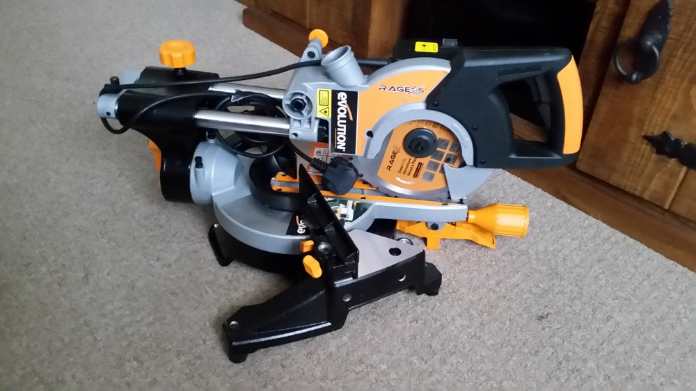

I think your right mate it's totally off square by over a mm when cut. Even if it was square I generally don't like them. Cold cut ones are better but they still make a row. I'm not in a production environment I do my private jobs and projects in my own time so the bandsaw can take all the time it needs so long as it comes off cut spot on to length needing minimal de burringSurprised by your comments there can only assume it's a bad example on the accuracy front. Dust n sparks I grant you ( bad for h+s bad for clean up time)
I keep it for if I need to chuck in the car (rarely if ever nowadays) if it's at home it's a bandsaw job. Mine is a scabby old white thing not sure of the brand. Been on with cutting some brush finish 304 box for a balcony railing last week and the bandsaw has cut all the 45's so perfect that when they meet the angle achieved is dead square. I'd not be without it now. Quality is everything to me. In fairness it was a real pita to fettle when I first built it. The blade was running off the wheels, the blade rollers were off set causing it to slope cut even the wheels needed spacing off as they sat at different heights off the bow back but after a day of fettle and a box full of scrap cuts its now sorted. Even the slow down pressure of the damper I added made a huge difference to the way it cut as too much pressure causes the teeth to dull quicker and then run off true.Don't go off the indications pressed in and if you need it bang on ignore the metal pressing clamp and use separate g clamps or similar
They are made light for transportation hence your issues of course there is some junk out there

Now try those skills on the chop saw?I keep it for if I need to chuck in the car (rarely if ever nowadays) if it's at home it's a bandsaw job. Mine is a scabby old white thing not sure of the brand. Been on with cutting some brush finish 304 box for a balcony railing last week and the bandsaw has cut all the 45's so perfect that when they meet the angle achieved is dead square. I'd not be without it now. Quality is everything to me. In fairness it was a real pita to fettle when I first built it. The blade was running off the wheels, the blade rollers were off set causing it to slope cut even the wheels needed spacing off as they sat at different heights off the bow back but after a day of fettle and a box full of scrap cuts its now sorted. Even the slow down pressure of the damper I added made a huge difference to the way it cut as too much pressure causes the teeth to dull quicker and then run off true.
Why? I don't like them and as said before mine isn't up to the job. Hens the reason I have a band saw.Now try those skills on the chop saw?
My point was the bandsaw wasn't much better if at all till you sorted it right?Why? I don't like them and as said before mine isn't up to the job. Hens the reason I have a band saw.
IDon't go off the indications pressed in and if you need it bang on ignore the metal pressing clamp and use separate g clamps or similar
