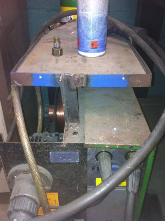

if its plugged into a modern consumer board itll probably trip as your putting voltage into the earth
The "earth clamp" on the welder is totally isolated from earth (the big round thing we live on)
You won't get any current down the earth lead as the current flows between the output terminals of the secondary side of the transformer.
The output is still isolated from earth
That is a tool tray welded to the top of my welder case is earthed and that was carried out with the welder it's welded to. The circuit that supplies the welder has all the RCD protection etc you could ever want
I don't think you are reading my posts - I'm saying it's fine and agree with what you say BUT there could be an issue if the welder is standing on an earthed welding table.
