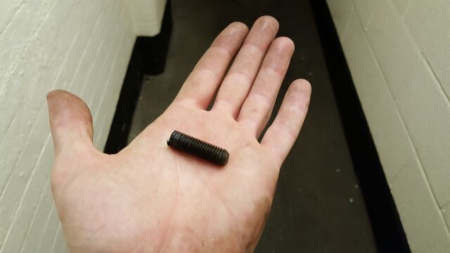

No, you put them on the shelf of your shed/garage then in a year or two when you need them you will spend about half a day looking for them and give up (cursing)Well. A real anti climax here. I thought before I start drilling or anything I would try an old trick first. I removed the blue tack dam from around the bolt and noticed about 1/2 of the plusgas (kerosene) had soaked in over the 3 days.
Dried it off. Then grabbed a cold chisel and a hammer and gently tapped anti clockwise on the protruding nib from where the bolt sheared. Turned instantly. Continued with this until it protruded enough for me to unscrew by hand.
I guess all the tension was holding the head down. Once that was released it was a non issue. No corrosion on threads. I think it was my lack of finesse removing the bolt which snapped it.
