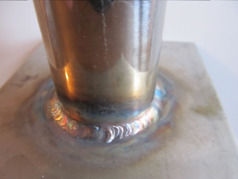

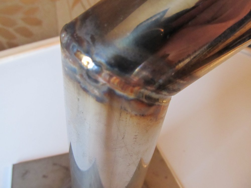

And they are a ferrite type SSMost commercial producers of stainless car exhausts MIG weld them, less chances of cracking, and I would guess costs only about 1/10th of purged TIG...............
Its 430LNb..........cheap enough like you say but not very plentiful outside the exhaust factory........thats the problemMaybe unless its a show car, he should get the lower spec material? Would probably cost half the money to do.
