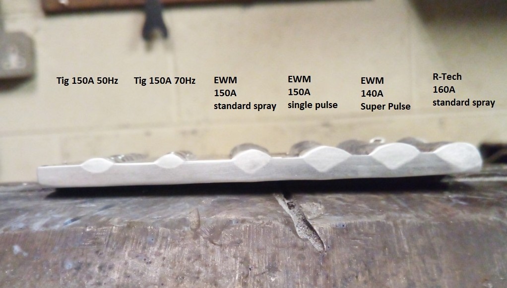

I recently did some tests with Mig and Tig welding Alu as we were having a discussion, the results surprised me a bit regarding the current required with Mig, I always thought it would be more but with the EWM Phoenix Puls it was quite low, with the R-Tech it was higher but still not as high as I had expected. I think it was around about the 160Amps for 5mm but would have to double check. If it was then you would be over 180Amps for 1/4" I would think.
Here it is on 5mm plate I think, the R-Tech one at the righ was on the edge of the plate so really wasn't the best test as it had a kind of an advantage but still.
So basically for a decent weld on 5mm Alu you are looking around about the 160Amp mark with standard spray Mig. The Pulse and super pulse Mig allows lower currents overall but likely peaks as much if not more than the standard spray.
Oh sorry, just noticed you were talking the Pro Mig 250 rather than the 180 that doubleboost was using.
So basically the current will be fine so the only difference really will be the Lift Tig functionality and maybe the synergic lines if they work for steel/stainless. They are certainly no use for Alu in my opinion so I just used it in manual.

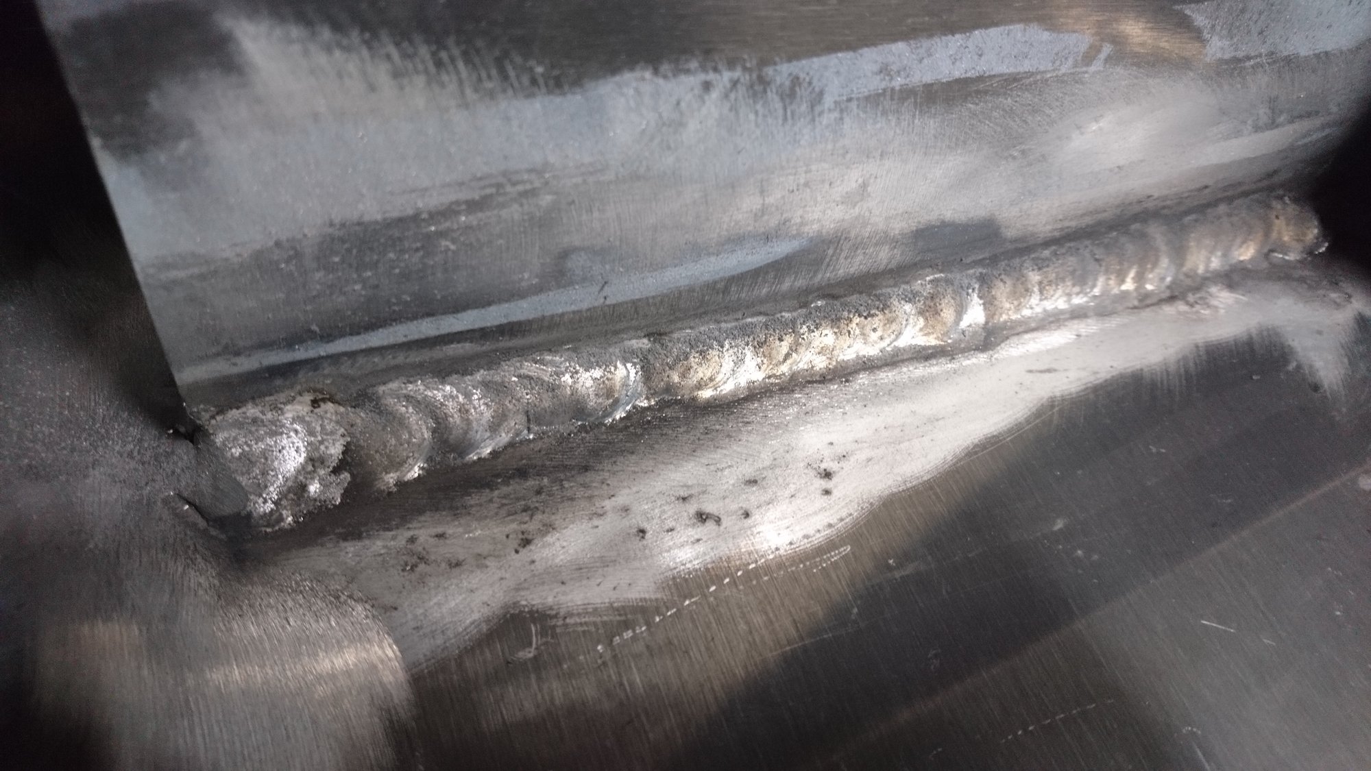

I seem to be getting quite a lot of fine white dust on everything, but no spatter. Is this normal?
It's quite fussy for you getting all the crap off especially when welding back into your tacks. Need some different brushes for the drill to get awkward corners cleared out as it seems really easy to just end up bogging chewing gum everywhere and not getting a decent penetration if it's no clean.
Had to bump the plate thickness up to 8mm as well, but it seems to be hacking it ok. Got the voltage up at about 90% of max and wire speed probably about 70%
Not sure on gas flow, will have a look next time I'm up there. Was getting loads of black soot before I upped the gas once. I need to put a proper flow meter on it as it just has a single stage reg on that came with the welder.
Regarding the stick out, what is the symptom of that? The white dust or can you see something else on the pic? I am having a few problems with it burning back and sticking to the tip when stopping the weld as it is. Is it normal to make the stickout longer when filling the crater at the end to avoid this?
Is there burn back adjustment on your welder, if so have a play with that.
The white/grey soot/dust is normal on 5083 with a standard Mig so don't worry about that.
