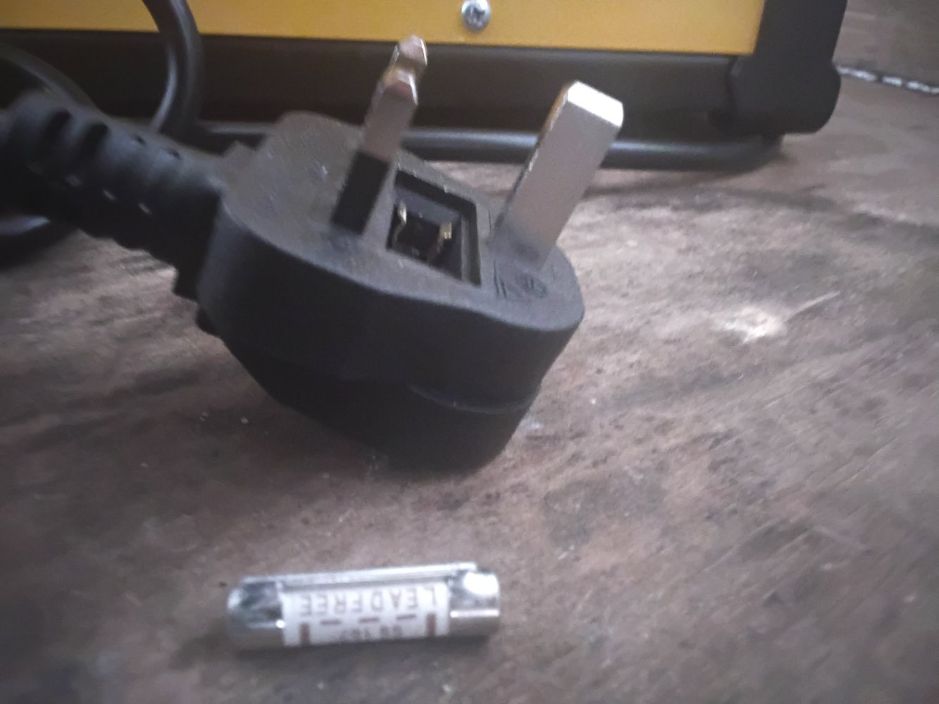

I was asked to look at this faulty Conentool pure Chinesium mini mig welder and the fuse has been bridged with wire from the factory, I read that Vevor mig welders were banned from import for the same thing , is this dangerous , is it illegal to sell and should it be reported to trading standards ?

, however it will probably not run full power without blowing. If you run it off a 16A fused spur via a commando plug it may be ok depending on the full load.
