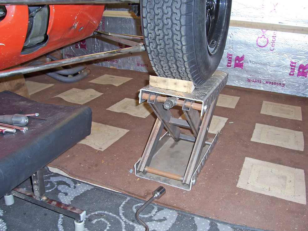

How's it work? Bottle jack in each? Peg system after raising? Other?

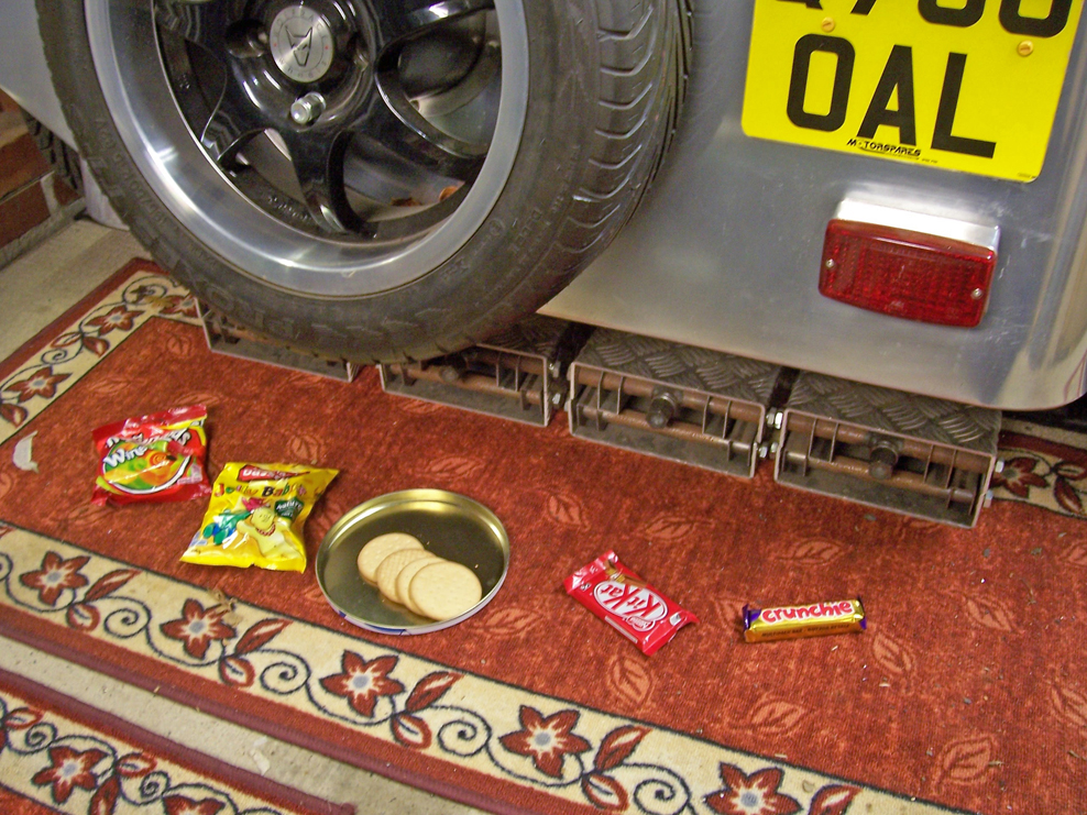

Is that Lotus parked in your living room?![]()

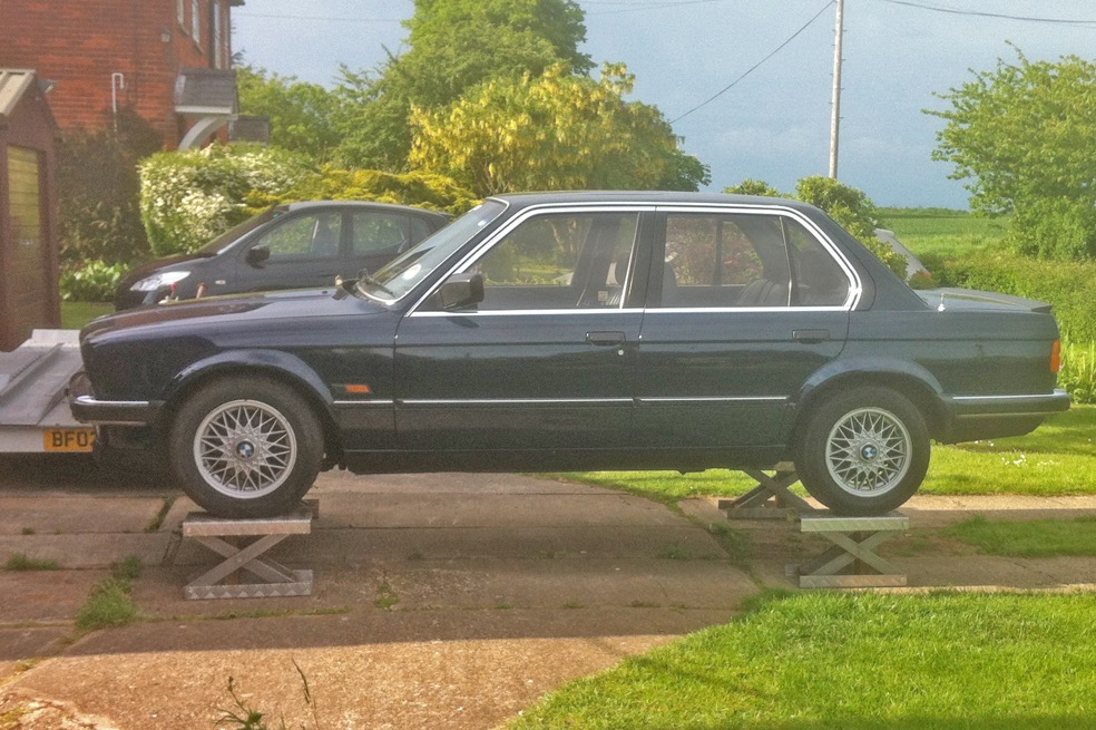

Excellent stuff - that answers quite a few questions. The only thing that concerns me is the sheer weight of them - are they movable by one person?Ive built a fair few sets of these (restoration ramps).
Cost of steel is about £250 from James Dunkerley at Oldham(? They used to be in Dewsbury).
Used about half a box of decent 2.5mm rods - so about 2.5kgs.
50x50x5mm angle with 25x25x3mm infill on the ramps
I use a Clarke buzz box 180a -never got close to max power, and never had it overload.

Yes.Excellent stuff - that answers quite a few questions. The only thing that concerns me is the sheer weight of them - are they movable by one person?
Yes.Hmmm - that could be a problem... Shame, as in all other respects they look like a neat solution. Would there be any way of reducing the size of the ramp to suit what is (by today's standards) a fairly small car? That would hopefully reduce the weight and the space required to store them.
