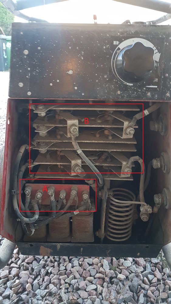

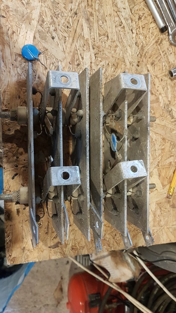

That wouldn't workReplacing any bad diodes won't be an option as they'll be pressed into the seat sinks, not stud mounted.
Plus they are best 'balanced', or more will likely fail.
I suspect the OEM assembly will be fearsomely expensive! You may find an economical solution using a generic rectifier, connected only to the the high output dinse socket that you need, e.g. https://www.ebay.co.uk/itm/1PC-DQFI...225620?hash=item3b45451494:g:vMgAAOSwAJxe1bme
Or you could make one for £5.
Replacment Rectifier for MIG Welder
I have a 250 Amp single pahase Mig Welder which had a diode short circuit in the rectifier. The replacement rectifier was available but...www.boatdesign.net

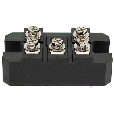

We need a three phase rectifier
He needs three of those two connected in parallel between for the 190A side
Ad just One for the 100A side
1PCS MDS 150A 1600V Three-phase Diode Bridge Rectifier Module Board MDS150A L | eBay
Find many great new & used options and get the best deals for 1PCS MDS 150A 1600V Three-phase Diode Bridge Rectifier Module Board MDS150A L at the best online prices at eBay! Free shipping for many products!
