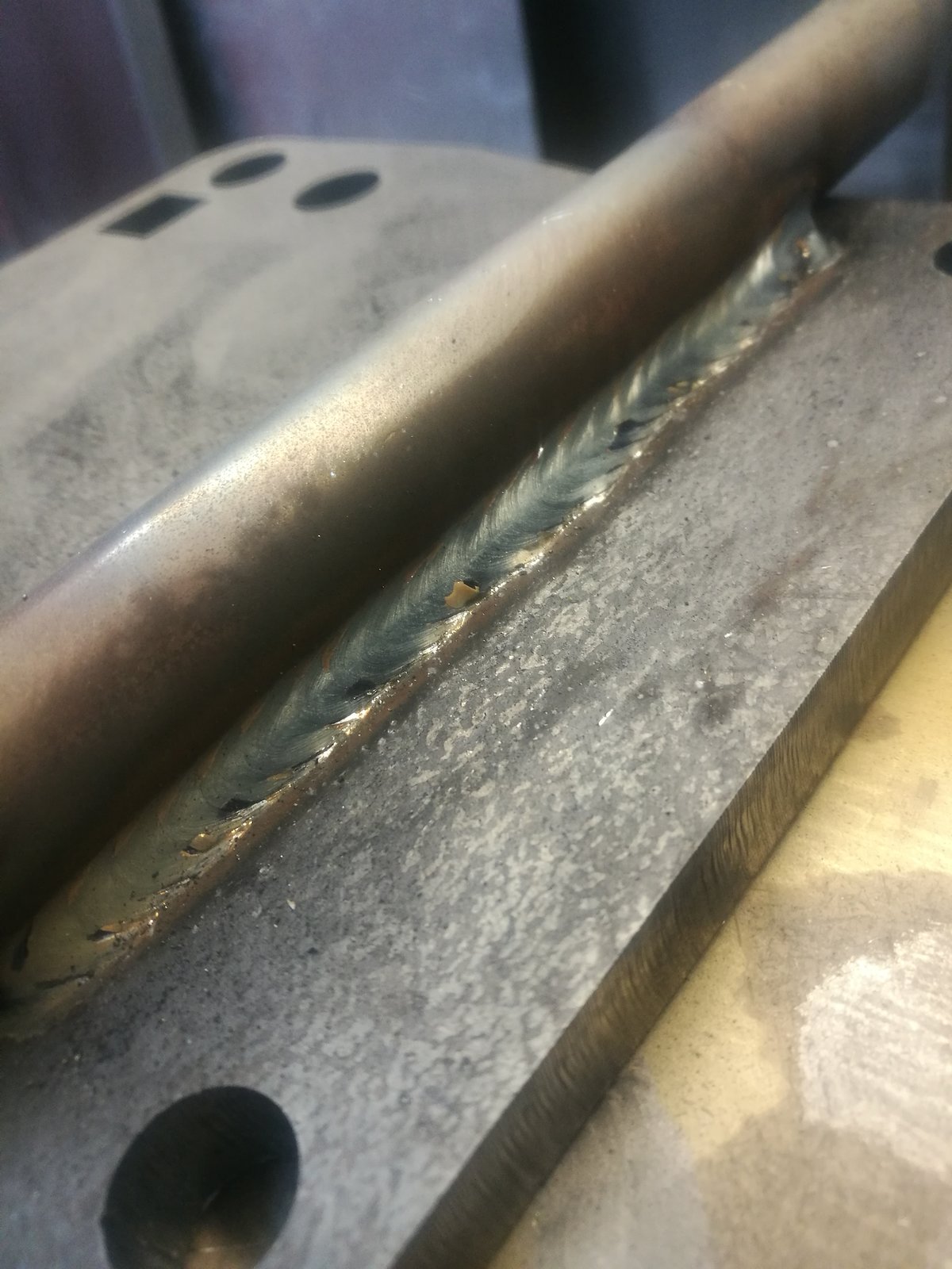

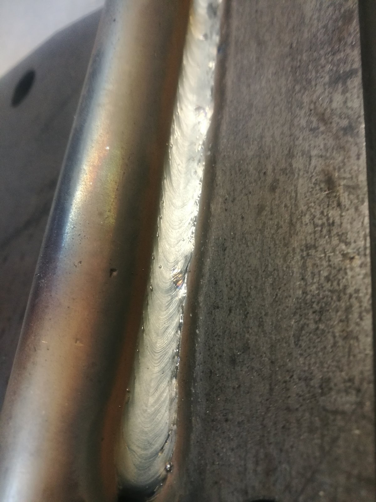

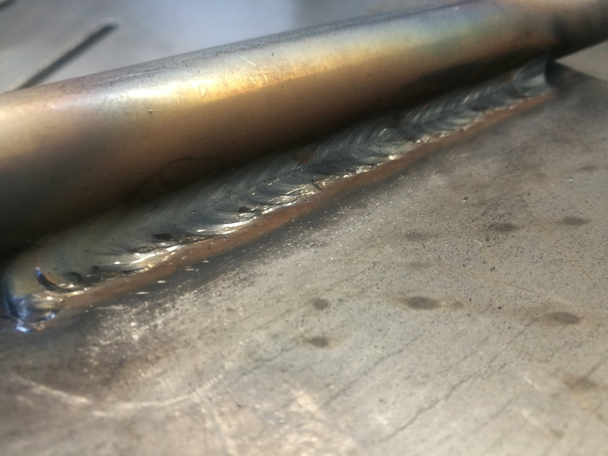

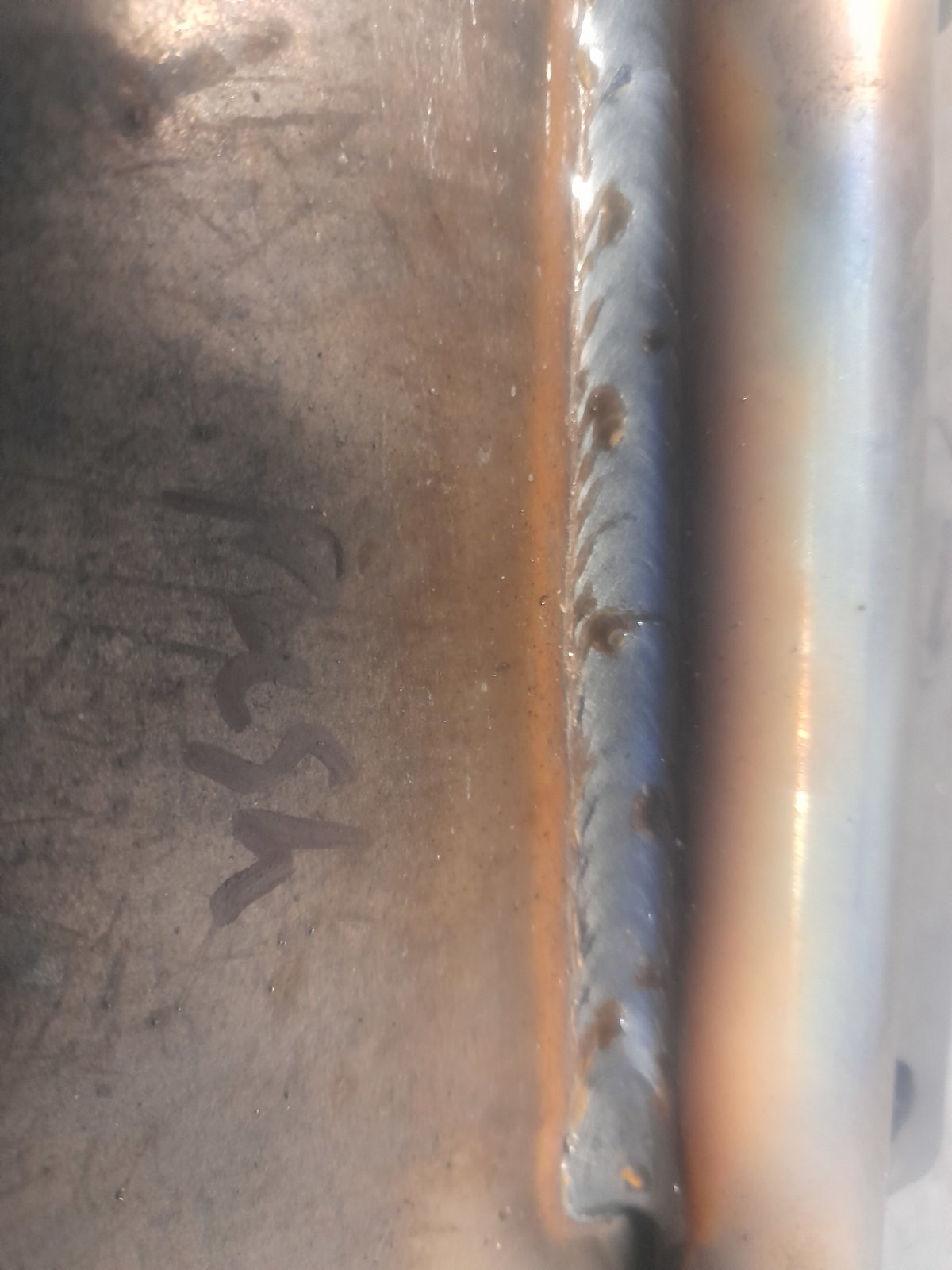

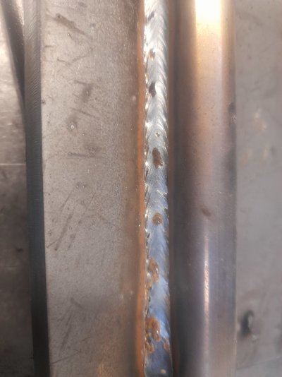

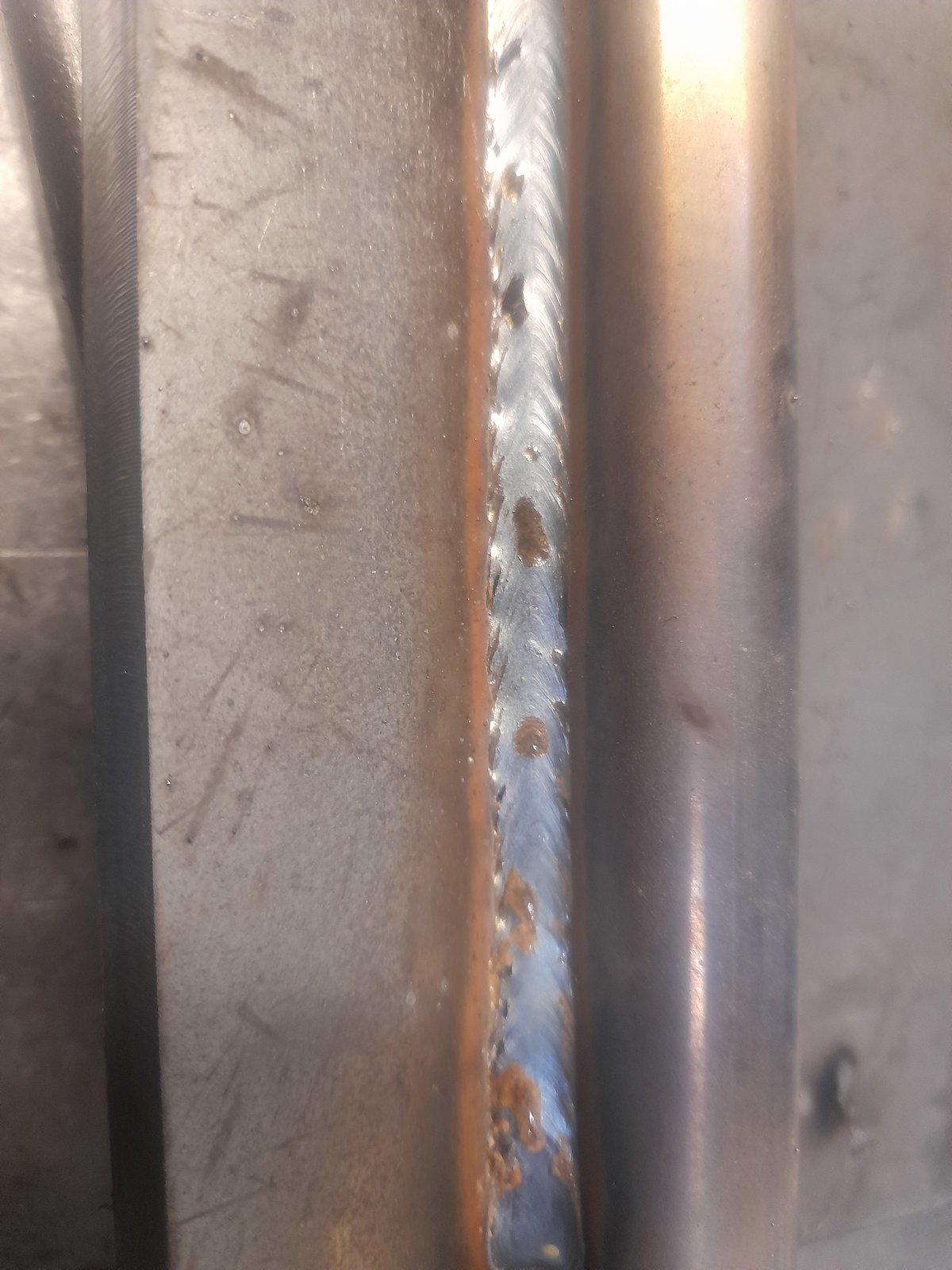

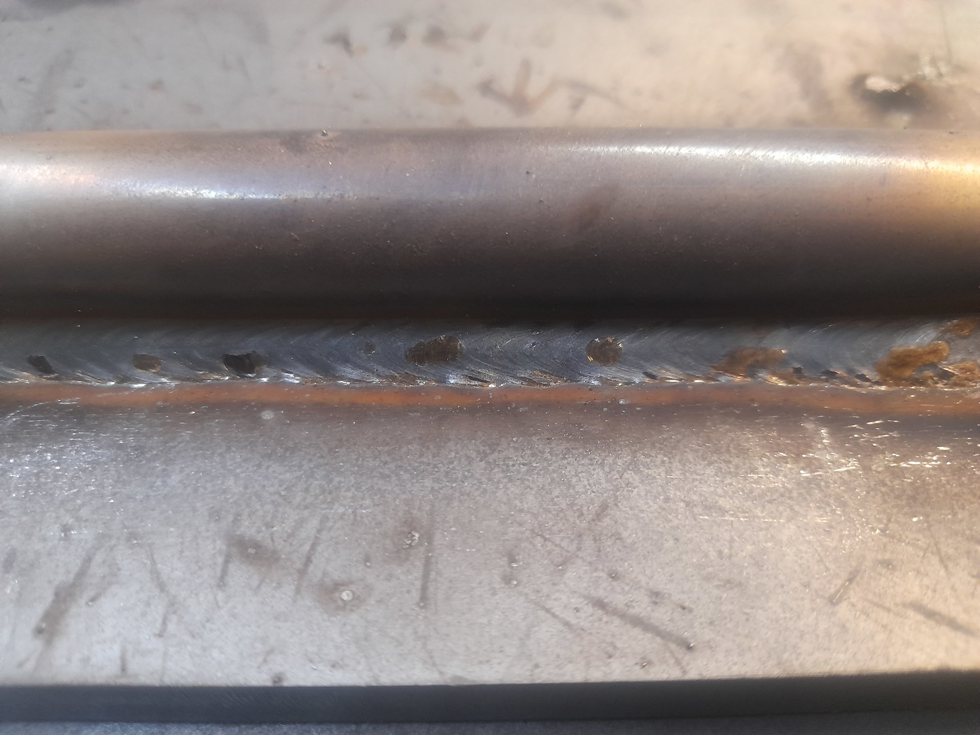

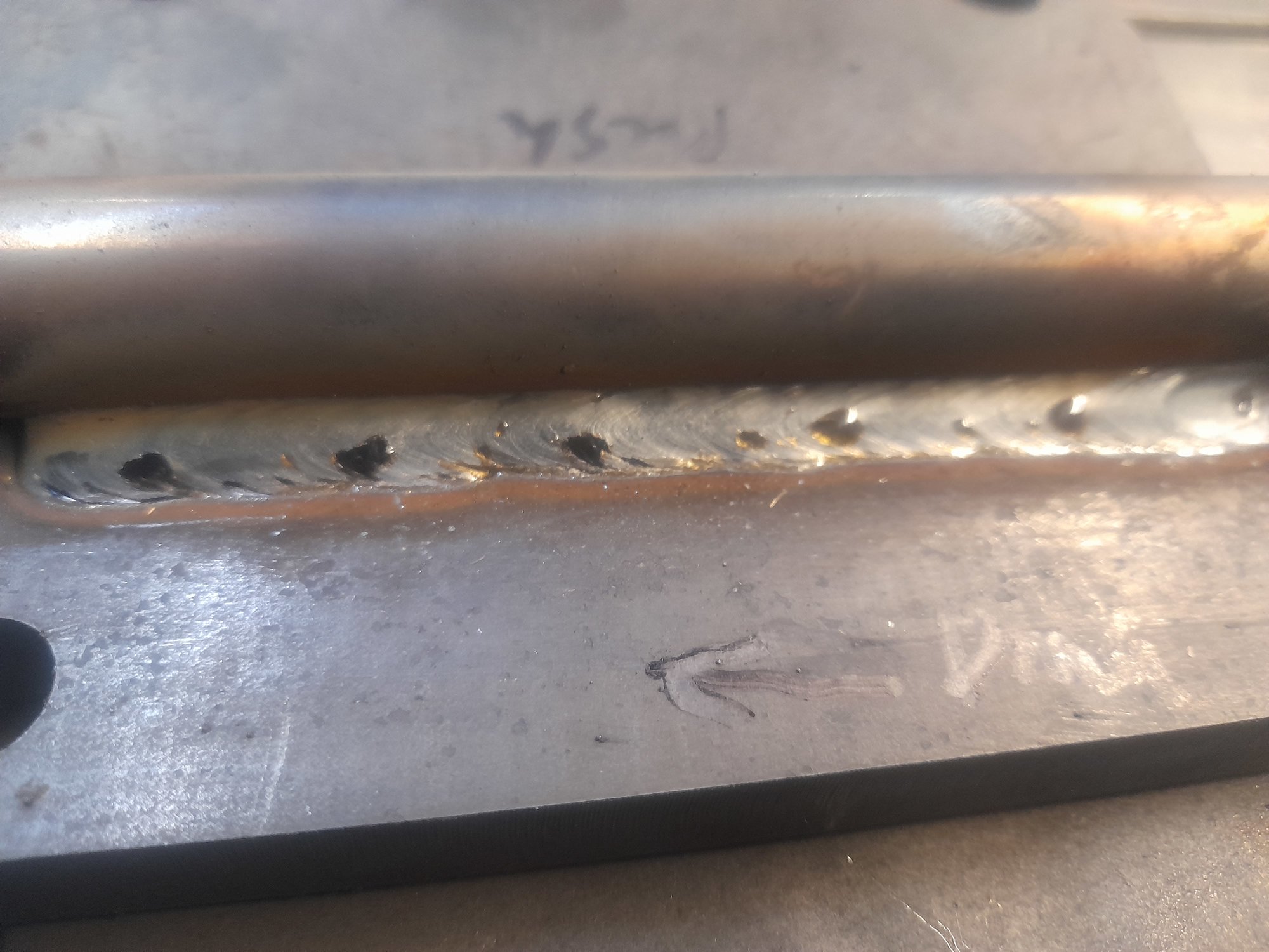

Pushing reduces penetration and increases weld width. If you need deeper pen pulling is always an option. Its not bad practice.
It also lessens the chance of the arc moving outside of the gas shield because it stops the torch angle becoming too flat plus you are travelling into the gas rather than away from the gas.
