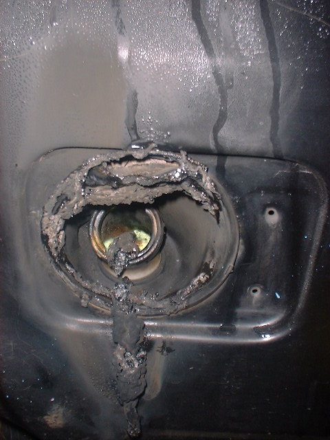

For a bang you need fuel, air and source of ignition, they come full of fuel, so blowing air in then adding adding heat doesn't seem ideal. if you add water all the fuel is pushed out, then air goes in after the water and before the spark. Not saying anyone is wrong, clearly no one who has posted here has been blown to bits, it just seems to me water is a much safer way.Why?
I was told the odor substance (Ethyl Mercaptan) was absorbed by the steel, but I may be wrong??Can someone attempt to explain the science behind "going at it as soon as possible", please?
If we agree that steel is not porous, and that it can't suck in the fumes, why would a tank be more dangerous 4 days after being filled with water and blown with air, than it would 1 hour after that happened![]()
We need proof.It worked and didn't blow me up

OK I wasn't going to say it because as stated I am firmly against this practice. I did however used to work on various vessels that contained such fuels etc many moons ago. What we did is filled them up with either water or dry fine sand (obviously the latter is not much use if it's a fuel tank fix.
Still it contains enough chance of dropping a clanger that for the sake of rolling a cylinder I recommend it's not done
So many such unthought of risks in this hence my thoughts. Do enough of them and a miss hap is inevitableOne thing that might be worth considering. After removing the valve make sure all the LPG has boiled off before adding water, otherwise the boiling gas could freeze the water and trap the gas inside the ice. Applying a grinder, plasma cutter or gas axe could thaw the ice releasing the gas. You'd have gas, ignition and air all in the same place and an explosion would be the result.
