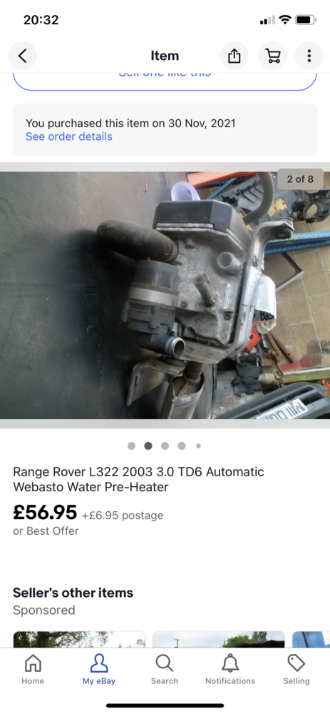

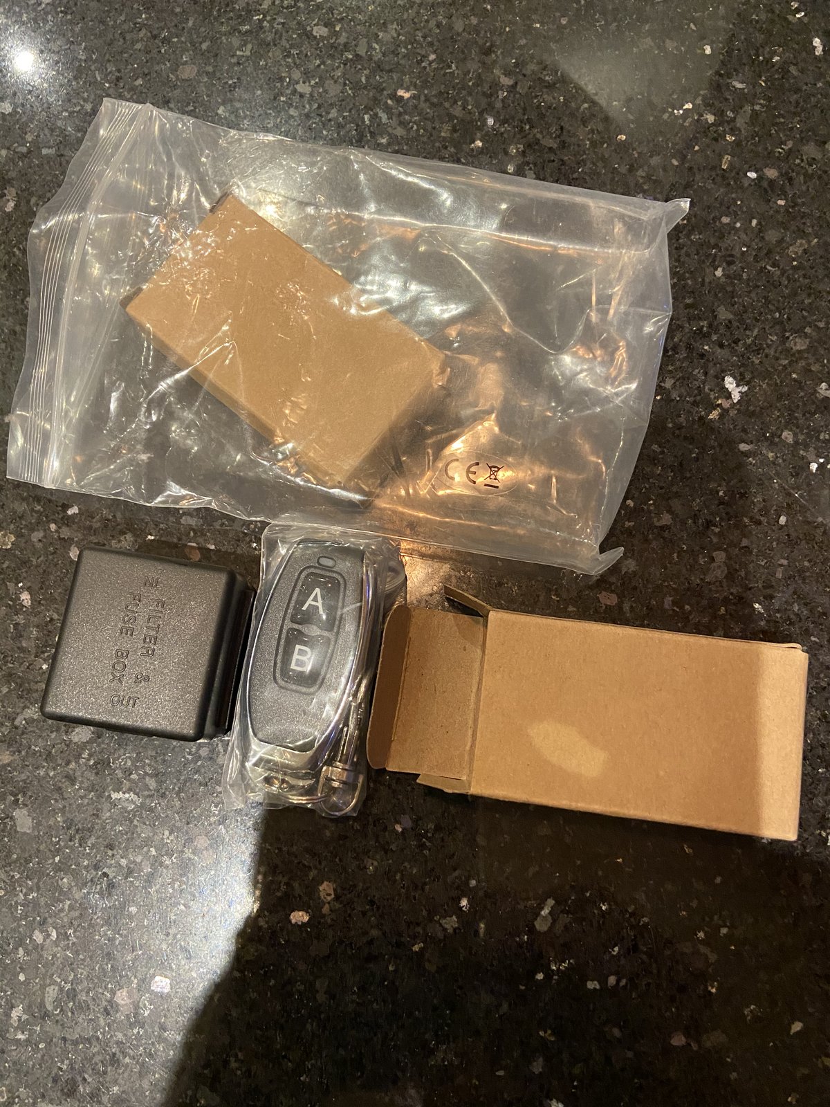

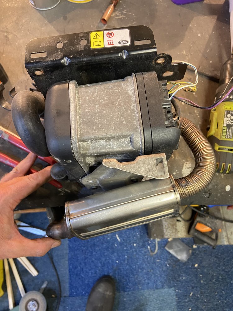

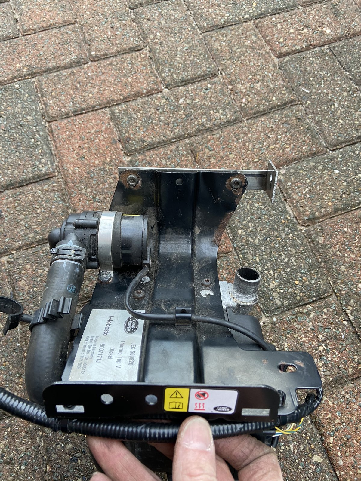

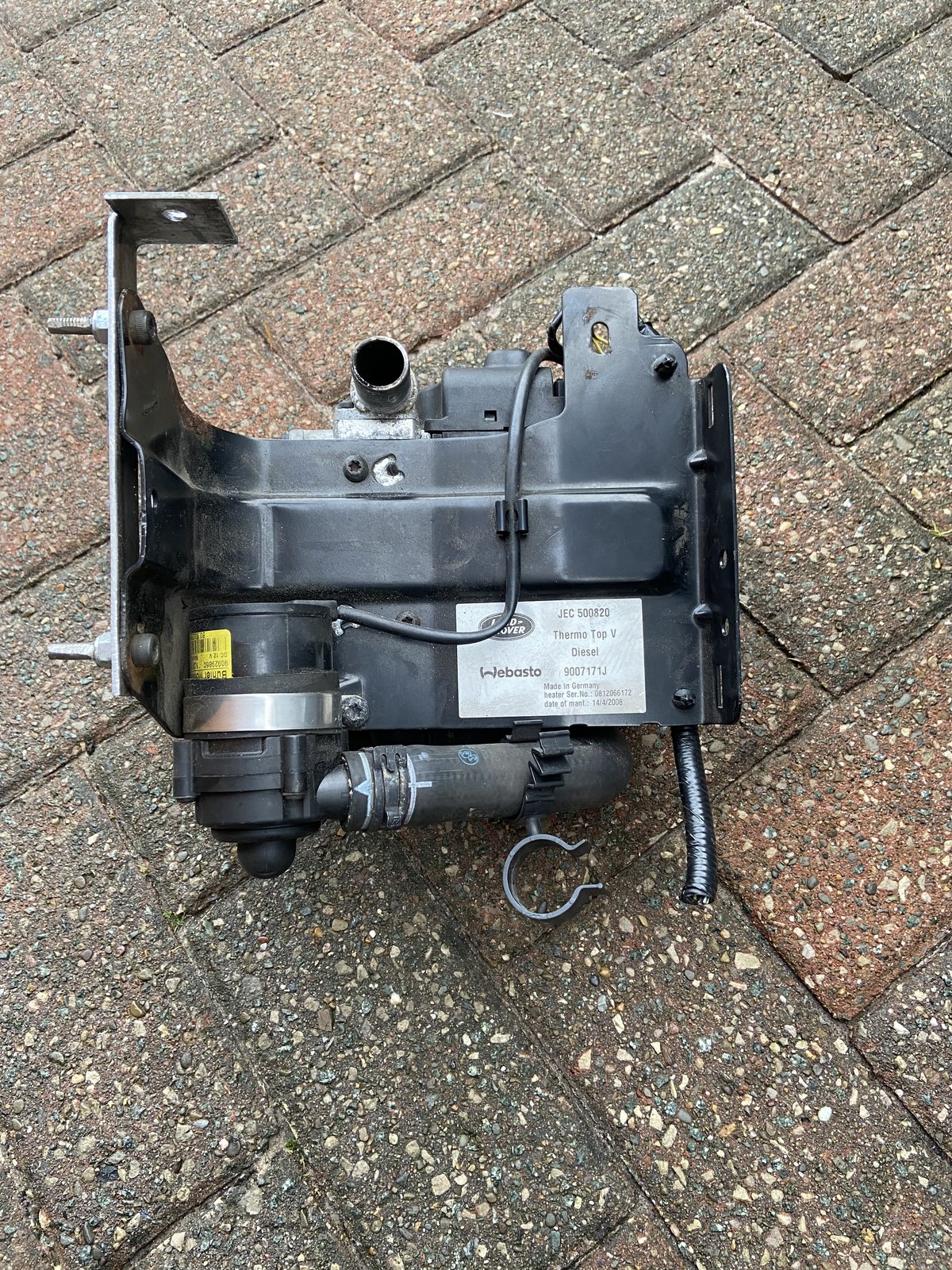

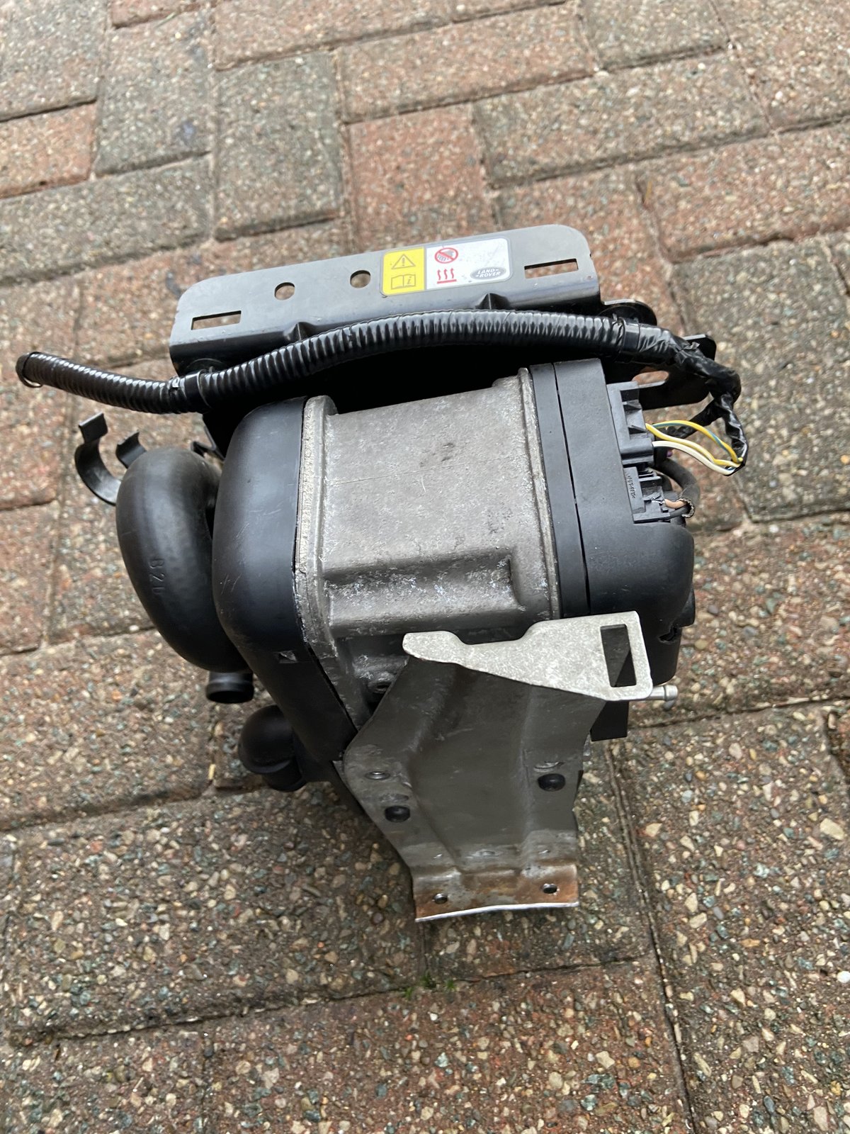

first gather your bits. You are looking for a diecovery 3 thermo top V, NOT a vevo. Try and get one with the connectors and a length of wire fitted. Got mine off ebay for £60 posted.
then you need off of ebay

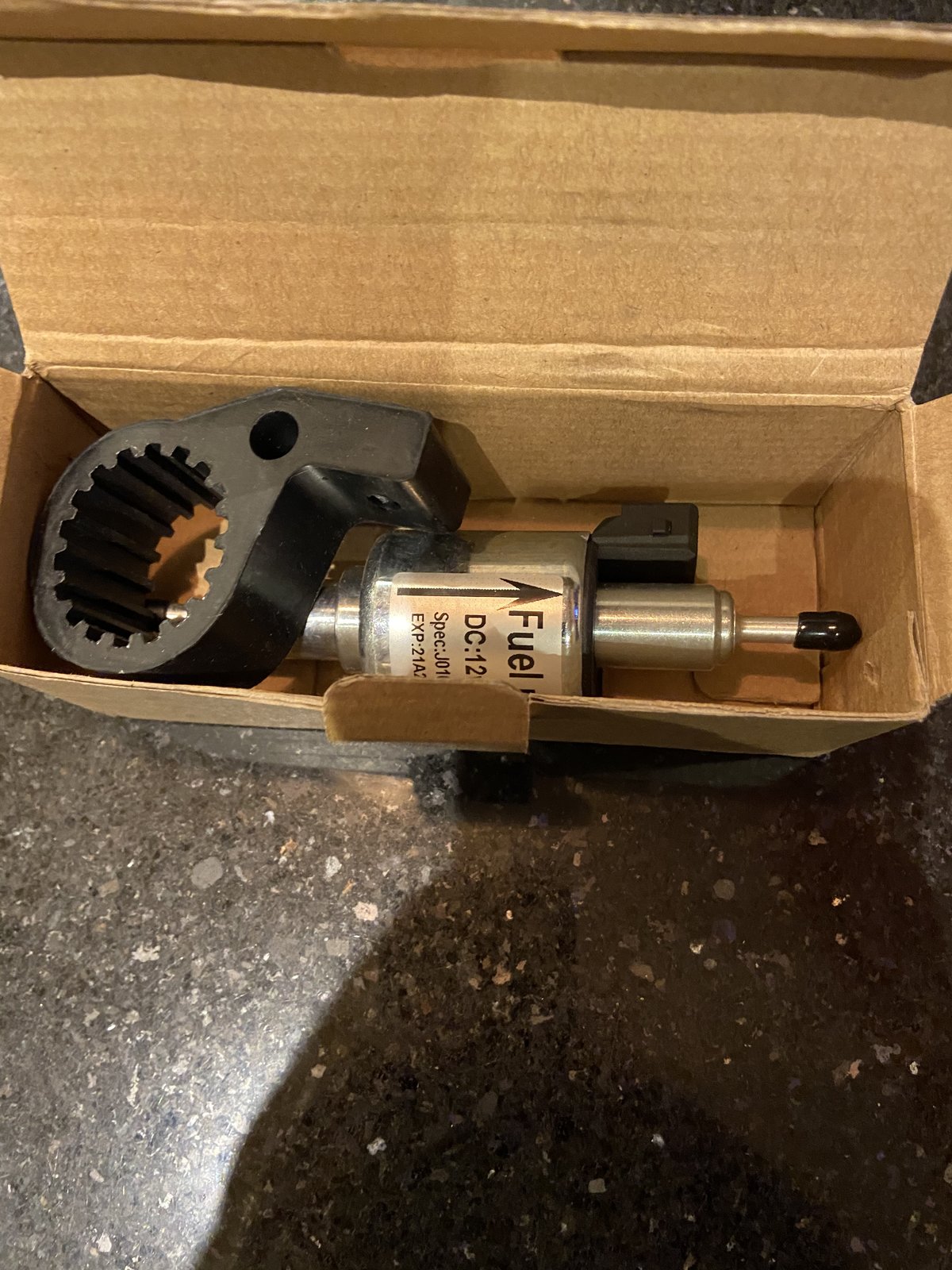

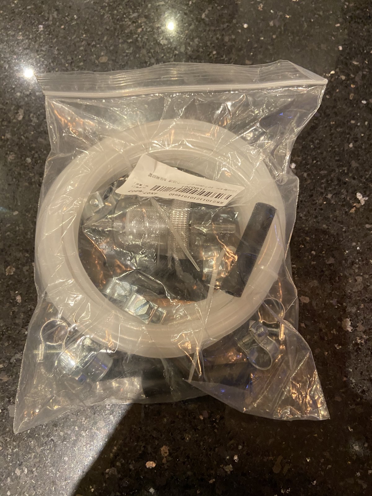

5m fuel hose clip filter pipe line kit £8.29
12v car air diesel oil fuel pump 2-5kw webasto eberspacher £9.16

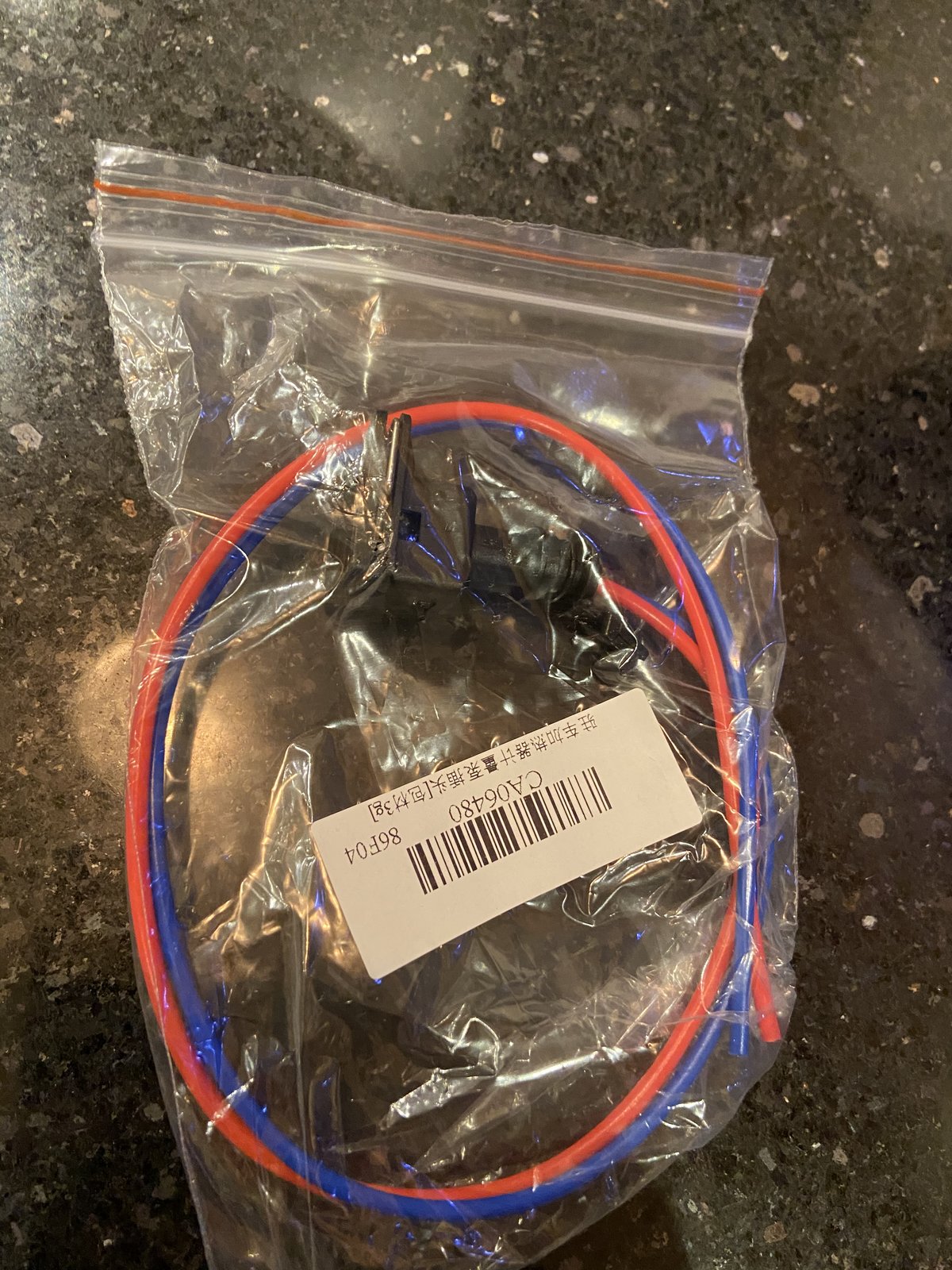

2 pin webasto fuel pump plug £2.61

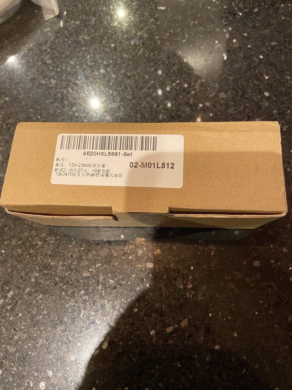

Wireless remote control transmitter 1ch £8.99

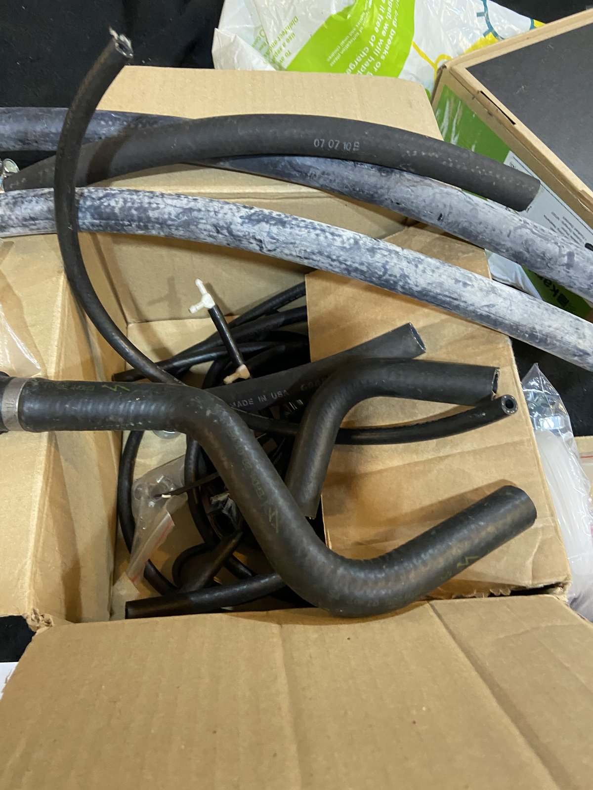

16mm heater hose and couplers. Tip , look for rover 75 cdti fuel burning heater hosePCH119334. They appear on ebay new old stock or rimmer brothers stock them. This will furnish all the bends and pipe you will need (ive still got some left from my last install)
