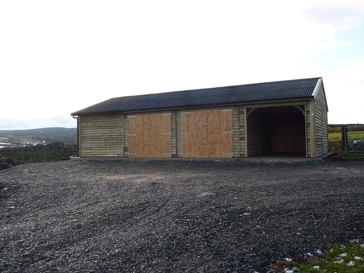

Never used sweet chestnut, but have a red cedar greenhouse, weathers well and looks nice as it weathers, dread to think of the cost though to clad a garagre. There is a building local to here clad in larch, looks a dull grey now it has weathered in, suspect it may also be cost prohibitive too.
Back to weatherboard, my father used to have a holiday home, which was basically a posh shed. 3x2 frame with thin polythene over the outside of the frame, then tanalised weather board. Inside is lined with rock wool and plasterboard. It was externally reboarded in 1978 the summer I left school. Then in 85 a small fire, so this was when the cardboard type lining was replaced with plasterboard. The weather board where not burnt was removed and new polythene installed.
I past there a couple of months ago. Stopped to speak to the old neighbour. The boards are still in decent condition and have not been replaced. So bascally tanalised 1/2 inch planned weather board is now 40 years old and still looking good.
The shed I replaced when I built mine was initially the village school prefab built in 1919, so im pretty sure with regular coats of shed paint mine should out live me.
The polythene or membrane in my case are just to stop driving rain and damp from getting in, also reduces draughts massivly.
A frame with membrane over the weather board would be fine, just like any shed, but you could line with osb and use rockwool inbetween to keep cost down
Thanks for advising on that
I'm toying with the idea of weatherboard or feather edge with the breathable membrane such as Tyvec behind it, then the framework with insulation (maybe Celotex) between the studs followed by plywood over the top.
Might I ask what OSB is? Does rockwool insulate as well as the likes of Celotex?
Lastly, I'm guessing the feather edge boarding was tantalised? With this in mind is there need to further the protection i.e painting or creosoting?
