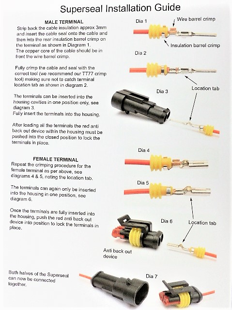

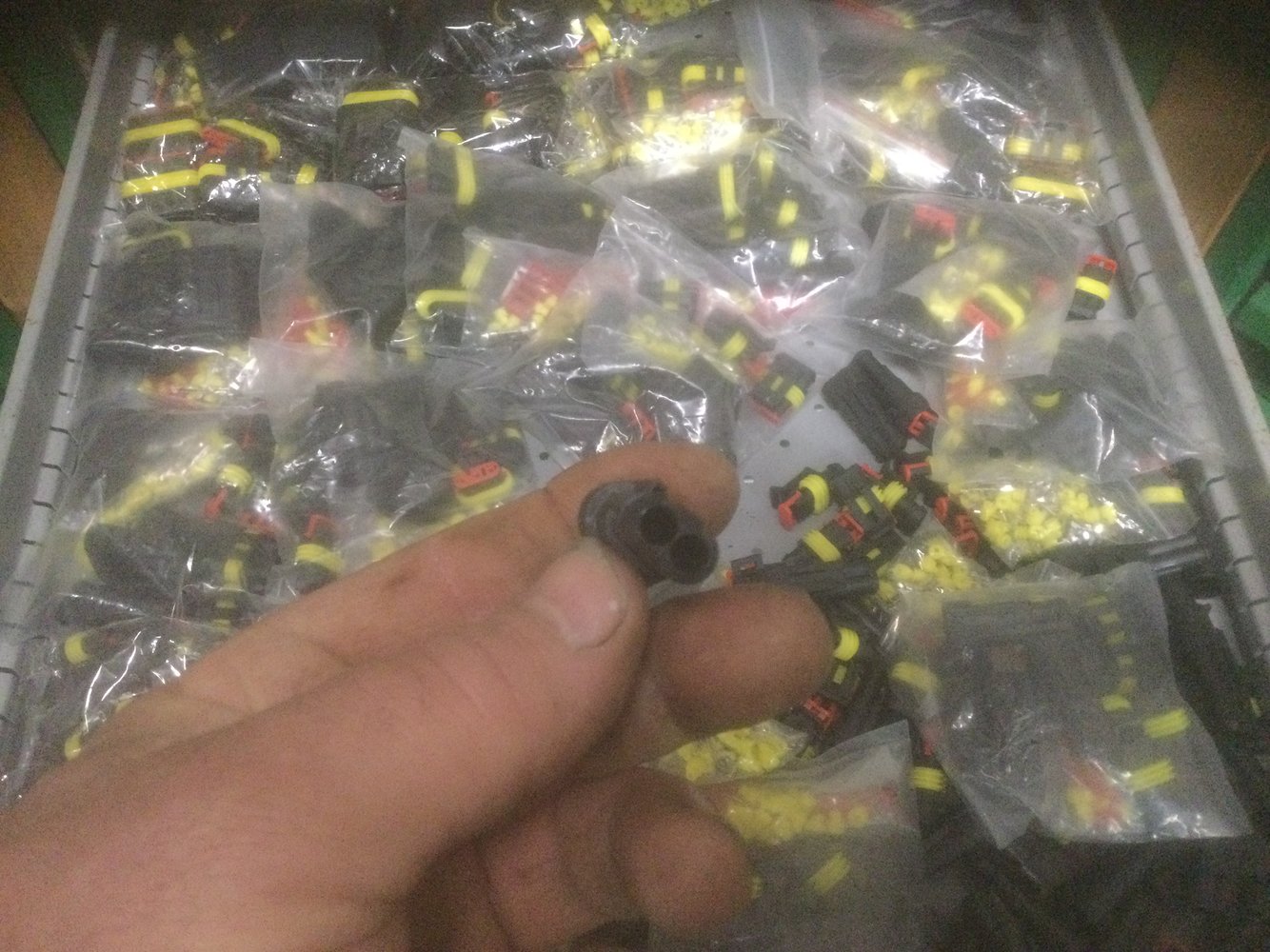

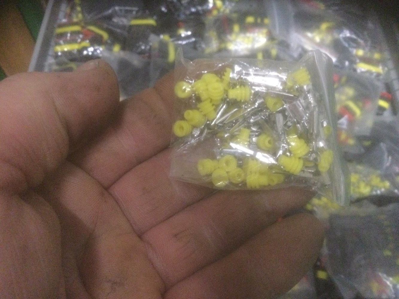

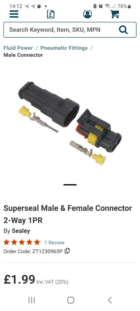

With the ones I got you fit the seal first and apply a smidge of leccy grease, push the cable through and fit the crimp, then pull the cable back to locate the tabs.
Bob
Those are exactly what I have Bob
