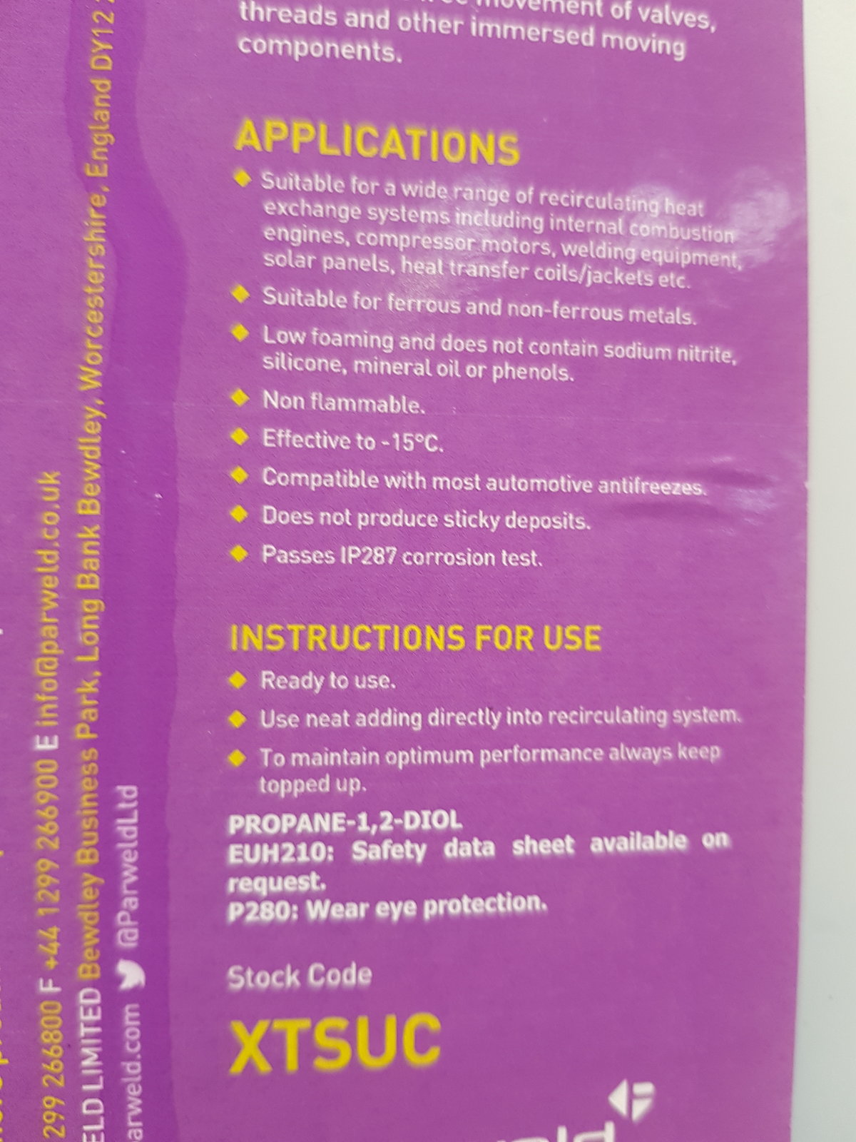

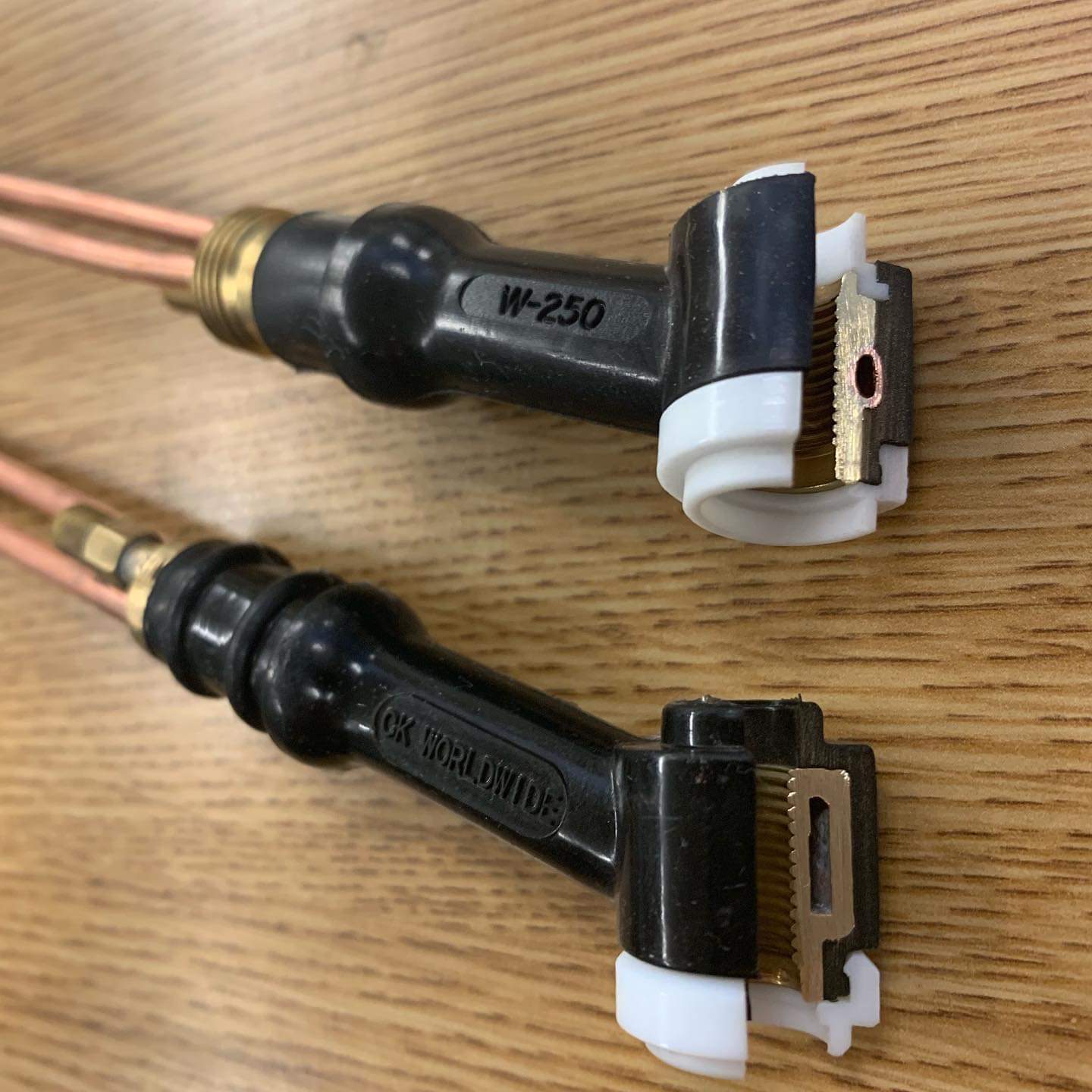

I now have all the parts for my water cooled tig torch assembled, just need the fluid to fill the system...
I have tested the system with straight water for leaks, but drained it off for final installation
All the oem specs say use our fluid (the only oem fluid I've seen is pink), I can understand this for warranty purposes, but what do we use in the real world?.
Straight waters not a good idea in the winter due to freezing, so is there a difference between pink (possible oem spec?) and blue car antifreeze or do I bite the bullet and buy a commercially available cooler fluid.
Please advise me.
