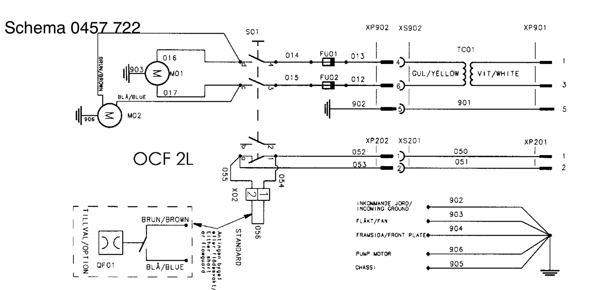

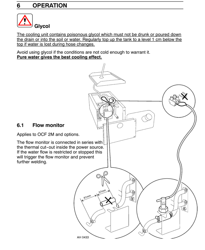

I am delighted. My Tig welder has never worked properly. I just found the problem before I was going to send it off for repair.
The welder works fine sometimes but not others so I gave up on it.
For some odd reason no arc or gas in AC or DC when the water cooler is ON!
Works fine when it's off.
Very odd?
Perhaps a flow switch wired the wrong way?
Very odd?
