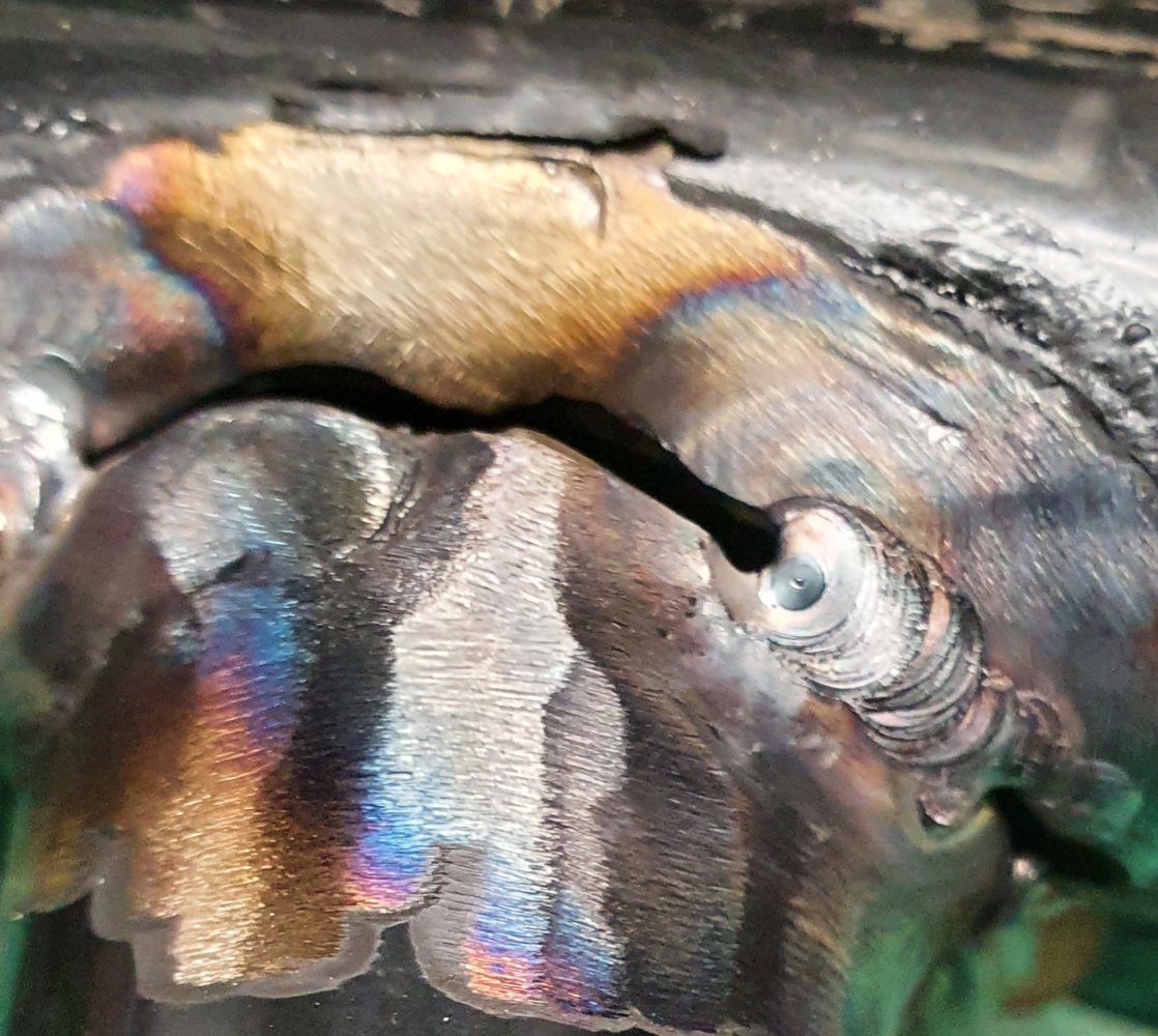

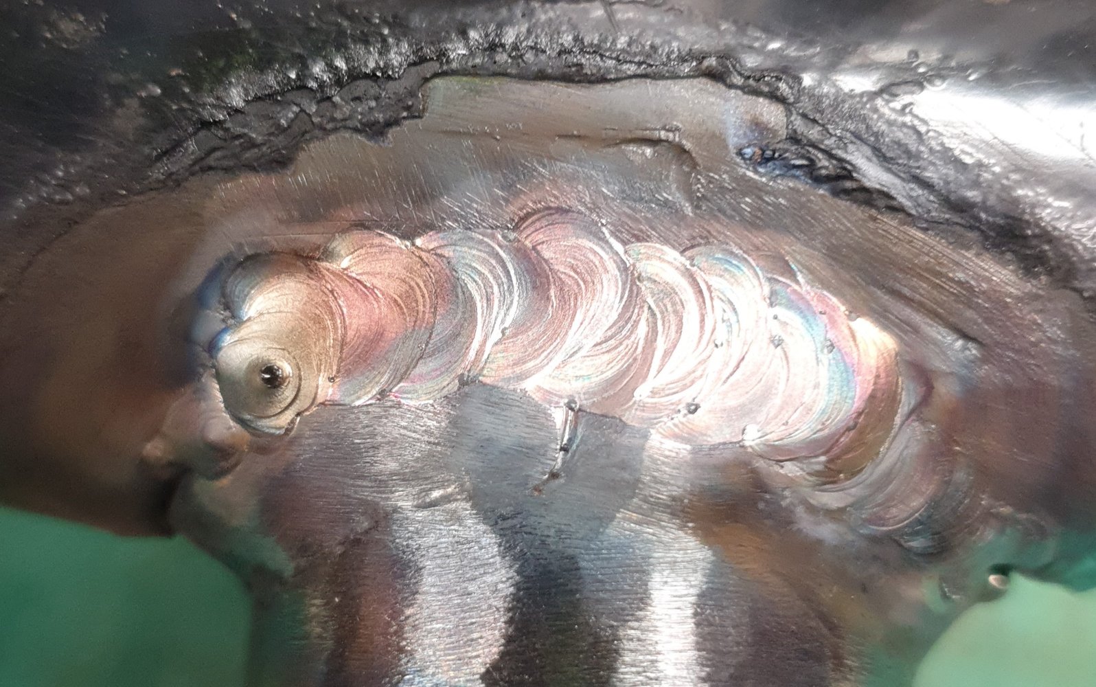

Hand on heart that is the one and only beadVery good, now lets ee some you haven't ground back and then washed over![]()
Arc length is very good

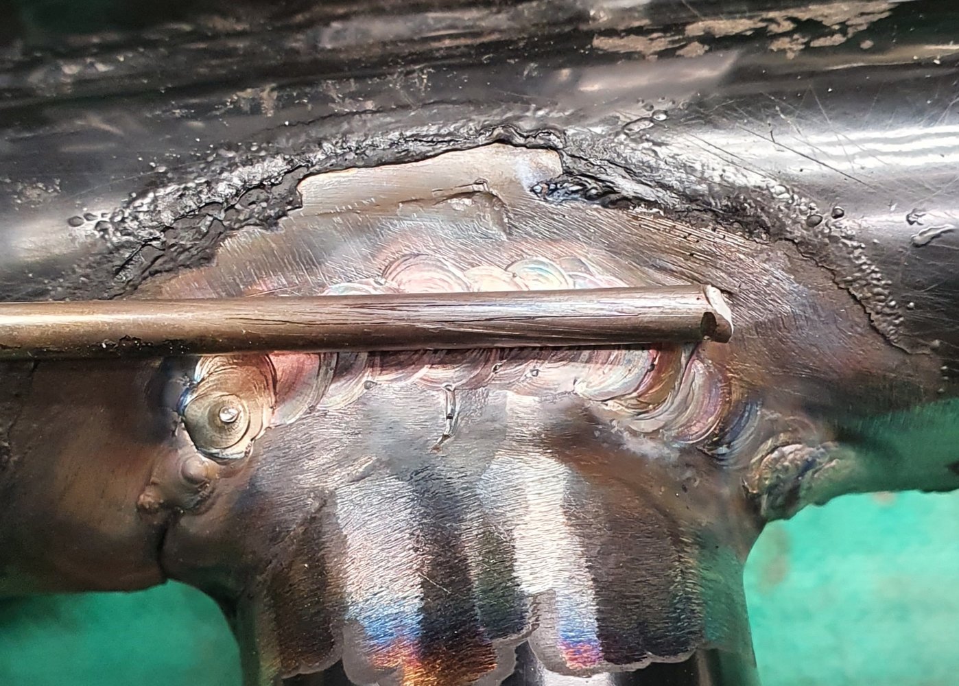

gap was about 3mm hence the piece of 5mm rod which happened to be high tensile but flowed beautifully.Part of a chair, I put a curve in the rod so it fit better and did figure of 8's to blend it with the base metalis this a motorcycle frame? laywire means that you had the rod flat on the gap and welded with "small circles" over?
