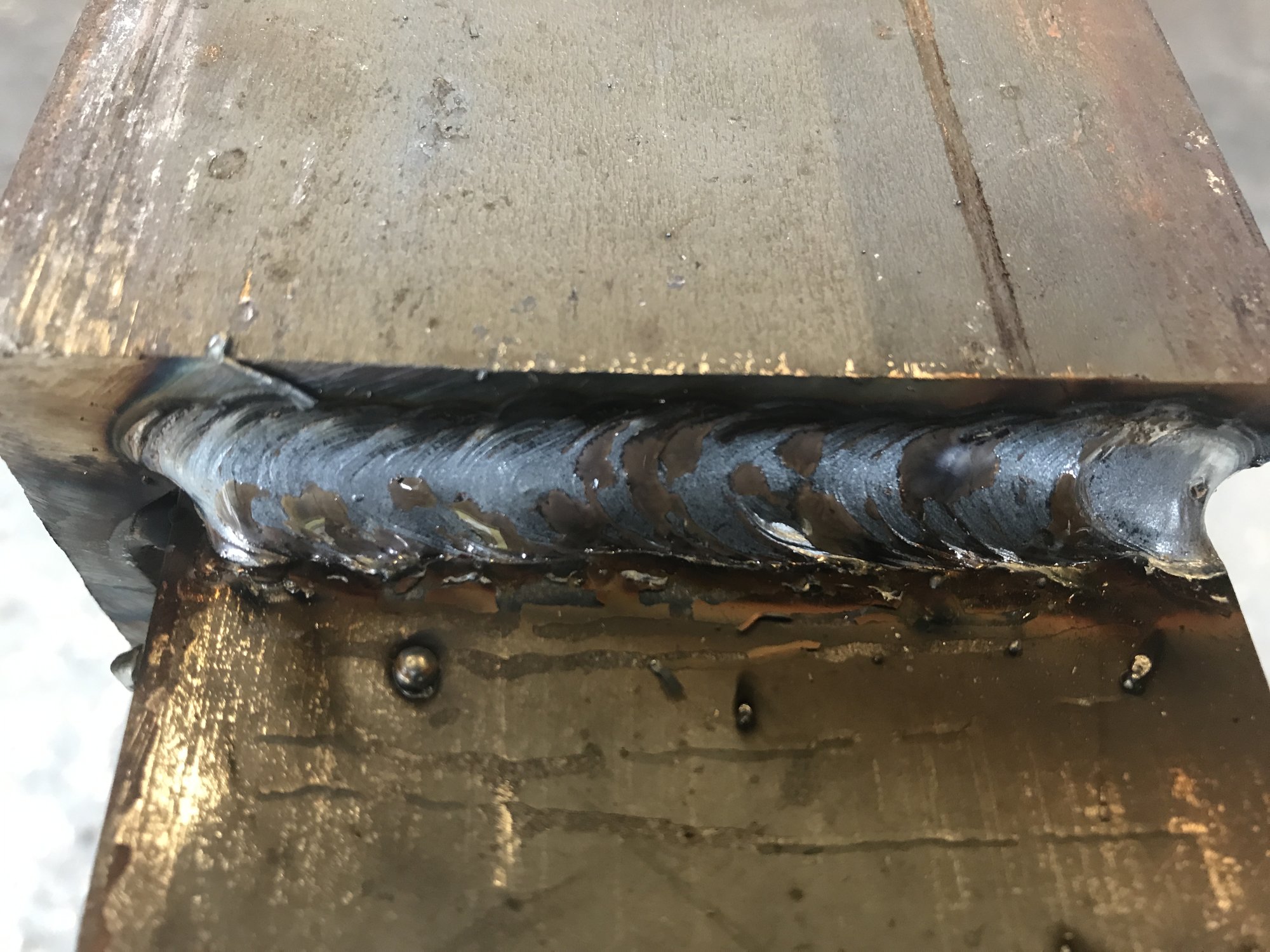

Well done mate.Got a bottle of hobby weld 15 coming, maybe have more chance now going forward....![]()
If it's an argon mix it will make all the difference.Exactly! When phoned this morning i asked for someone with knowledge on it this time instead of sending out wrong gas again by someone that has no idea!
Fortwilliam, im only going to be doing odd bit of welding now & again, more a hobby than anything else, and if this gas doesn't help who knows!![]()
Just slowly drop the feed speed down and leave the power the same for now.12mm thick steel, if i back down wire speed then do i back of power also?
