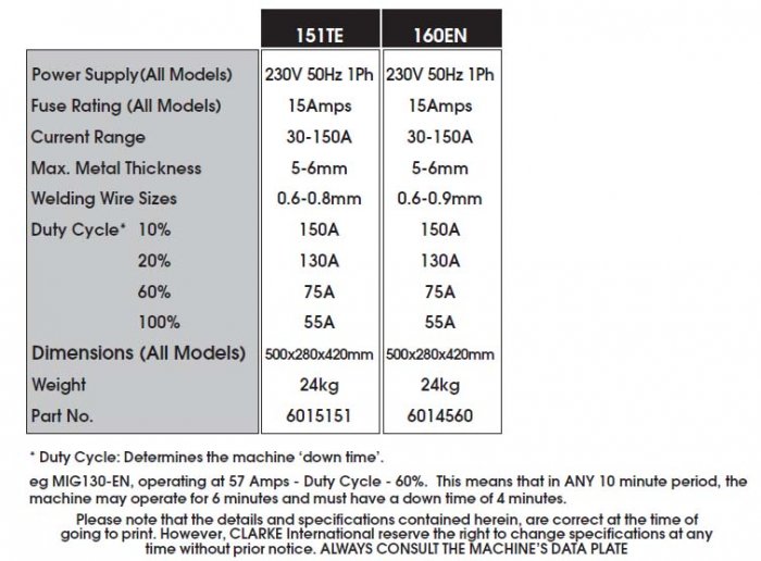

Have a read of the Clarke 160EN manual here and familiarise yourself with the machine. How much is he asking and what comes with it?
It will run fine on low to mid settings but as you crank up the power the 13 amp fuse will stop you by blowing. PITA. So limiting what you can do. A 32amp socket is a good move. Have a read of the Clarke 160EN manual here and familiarise yourself with the machine. How much is he asking and what comes with it?
'Migs 151TE and 160EN are NOT provided with 13 Amp plugs. These machines MUST NOT beconnected to a standard 13 Amp domestic supply'
