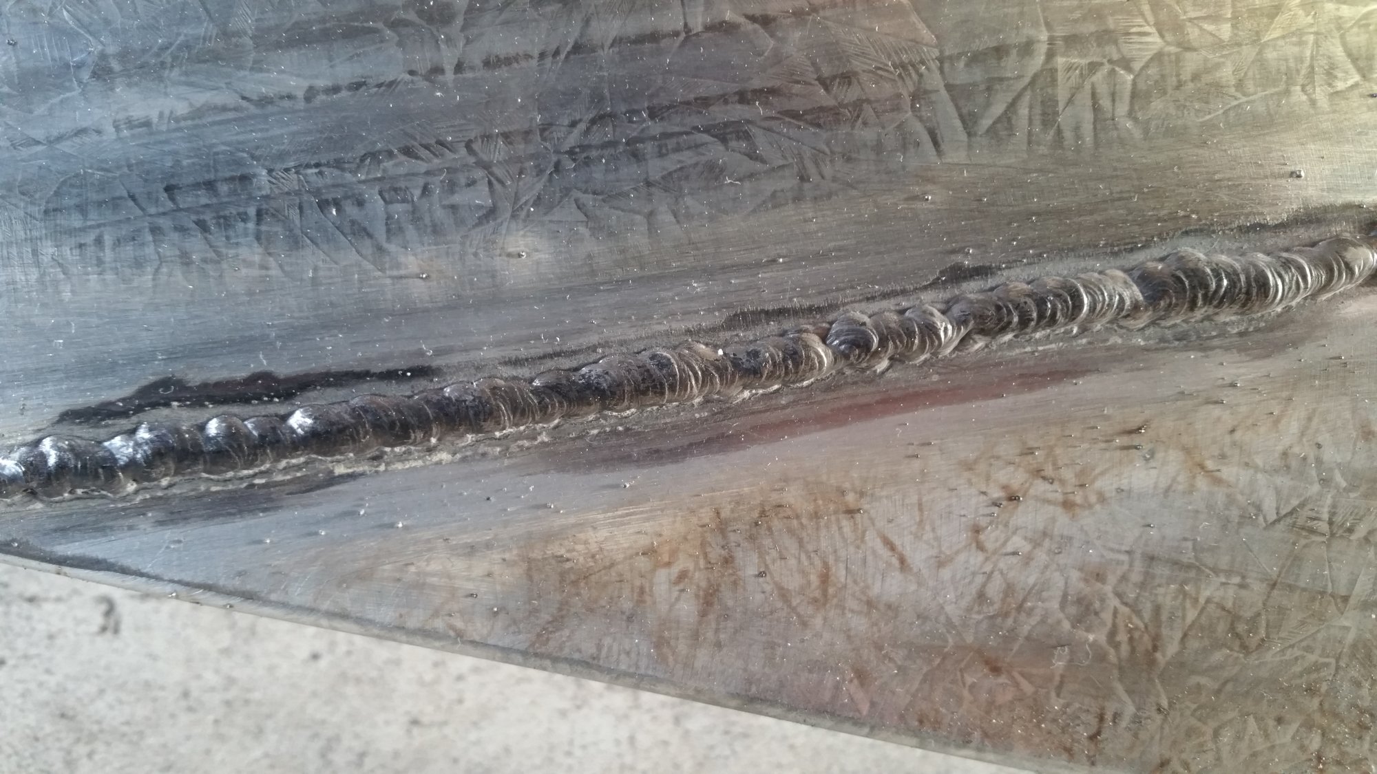

    So I ended up buying a mig weld razor 205, did lots of practicing, the suggested settings just blew holes through the patio tube I am using. Played with the settings and got to where I was happy, which was a lot lower than the suggested settings, then after lots more practice decided to go for it and weld my project which wasn't nearly as neat as my practice runs. If I can upload a pic maybe someone can tell me if it looks like it has welded properly albeit not very pretty

    That was using E71T-11 flux cored settings were 13volts 2.8 wire speed
