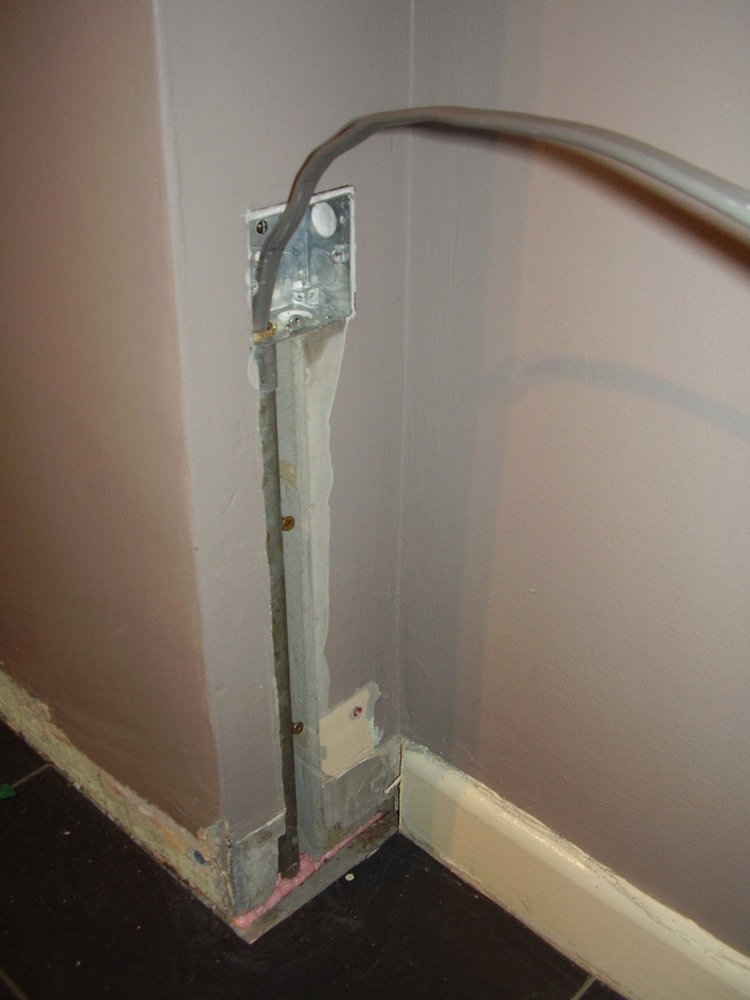

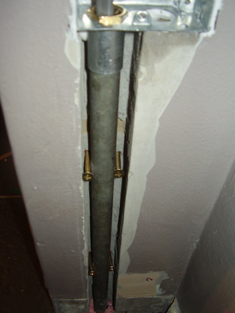

I had a really fragile corner where I put a single socket for a fridge. Mortar between the blocks wasn't great, plaster was a bit hollow. I cut out a slot for a bit of tube with a multi tool and it didn't even worry the celcon blocks. Soaked in PVA and mortar filled firmed it all up.
