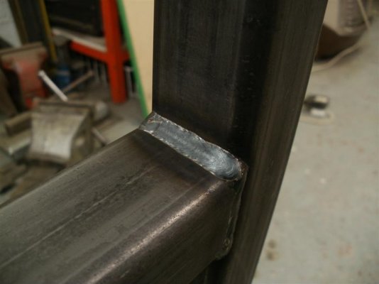

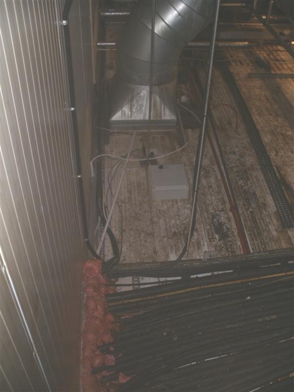

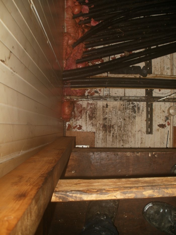

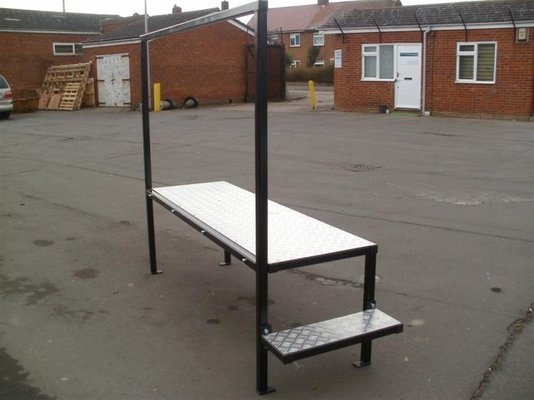

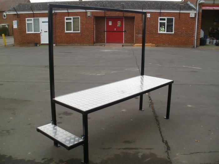

A little mild steel job this week for a change, customer needs a walkway to span these cables in a roofspace above a food factory, at the moment they have to walk on the cables to enter the roof space not really a good idea,
Access is very tight so the job is made to bolt together, there's deliberately no mid rail in the handrail to allow access to a control cabinet just out of camera shot.

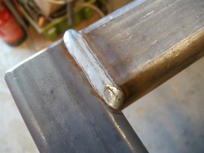

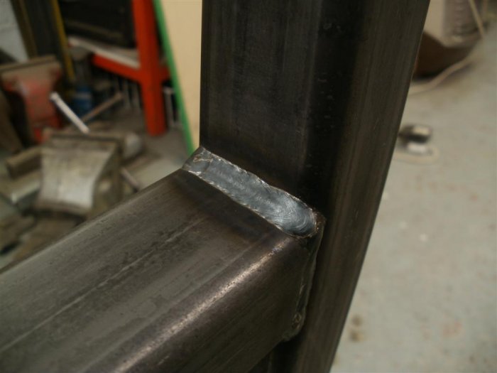

And just for you mig-weld fetishists a couple of the welds, Its made from 40 x 40 x 3 SHS, with a 2mm aluminium deck pop riveted on
I'll stick some pics up when they are made as a comparison!
wtf... talk about transfer modes and they look at you with kind of a blank expression on their face!!!!!!!
