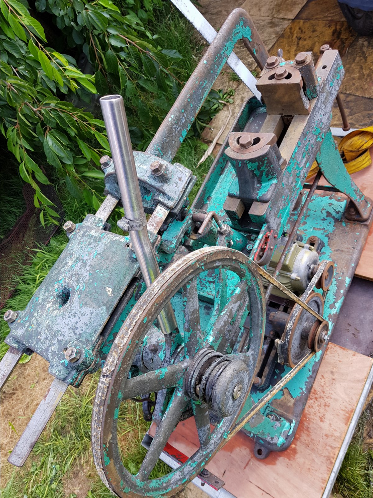

You are making me feel bad, we have one sitting outside ready to come into the workshop now i have the new doors fitted.Today I got my power saw outside my work area. For a good steam clean. Removing all the years of crud . All cleaned and covered in duck oil and ready for me to start the dismantle and repaint.

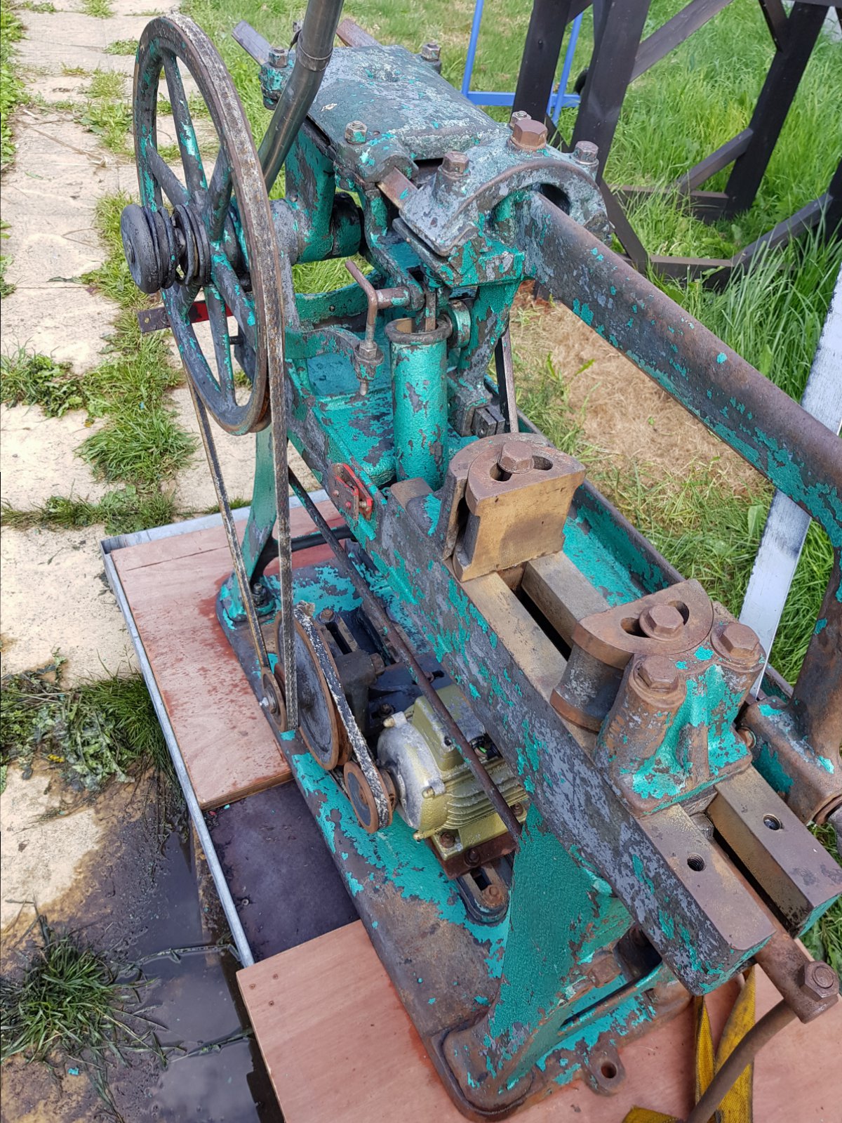

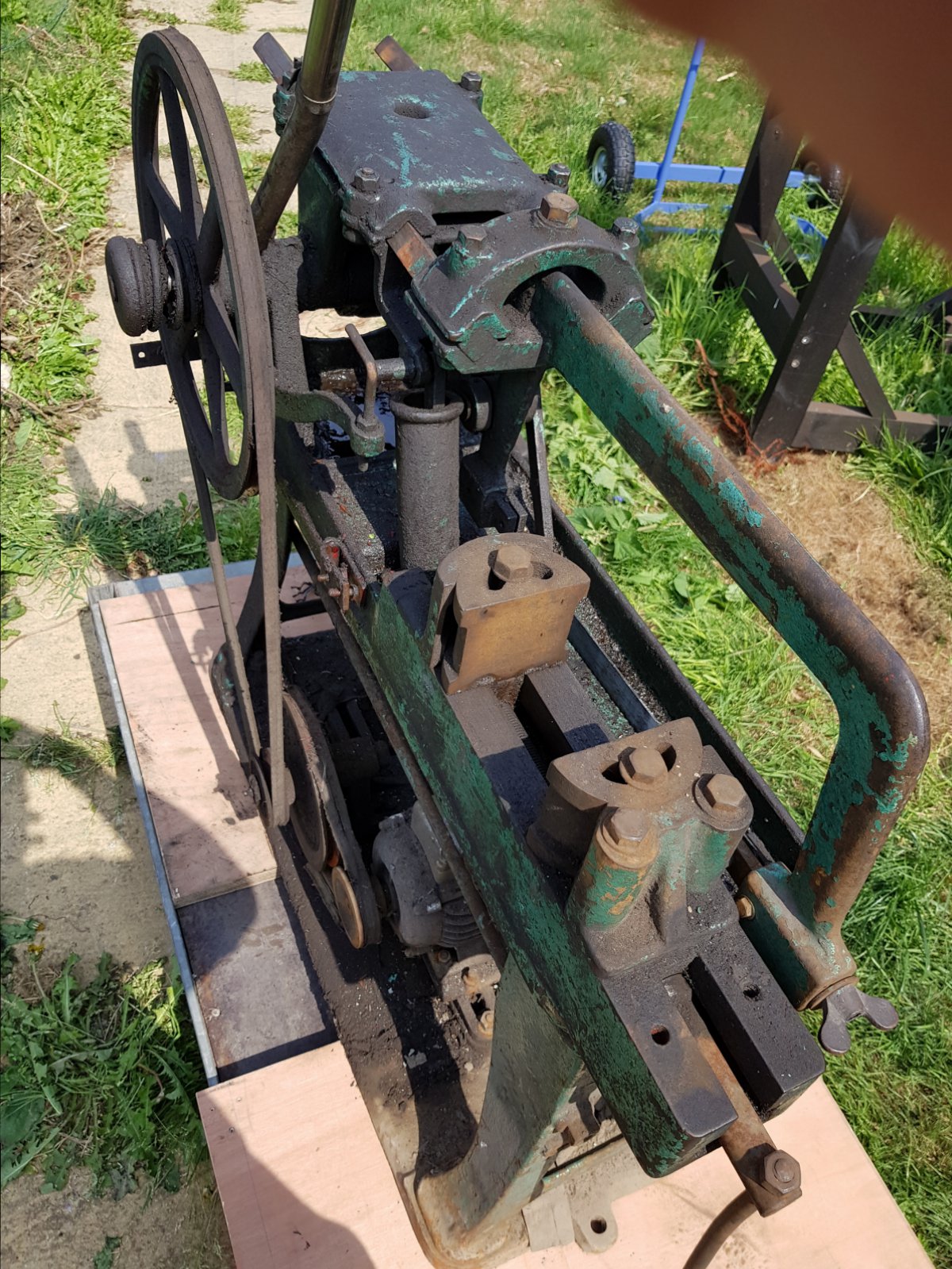

Today I got my power saw outside my work area. For a good steam clean. Removing all the years of crud . All cleaned and covered in duck oil and ready for me to start the dismantle and repaint.View attachment 113220 View attachment 113221 View attachment 113222
That's a good idea. As later on for a future project it will require some 22.5 degree cuts.From your pictures I see that you have adjustable jaws allowing you to cut angles. We had a similar one at work & once we had it set for cutting square we put a hand hacksaw cut across the fixed & swivel jaws & the same for 45 deg, that way you can set the cut angle without messing around with combination squares by just lining up the 2 hacksaw cuts.

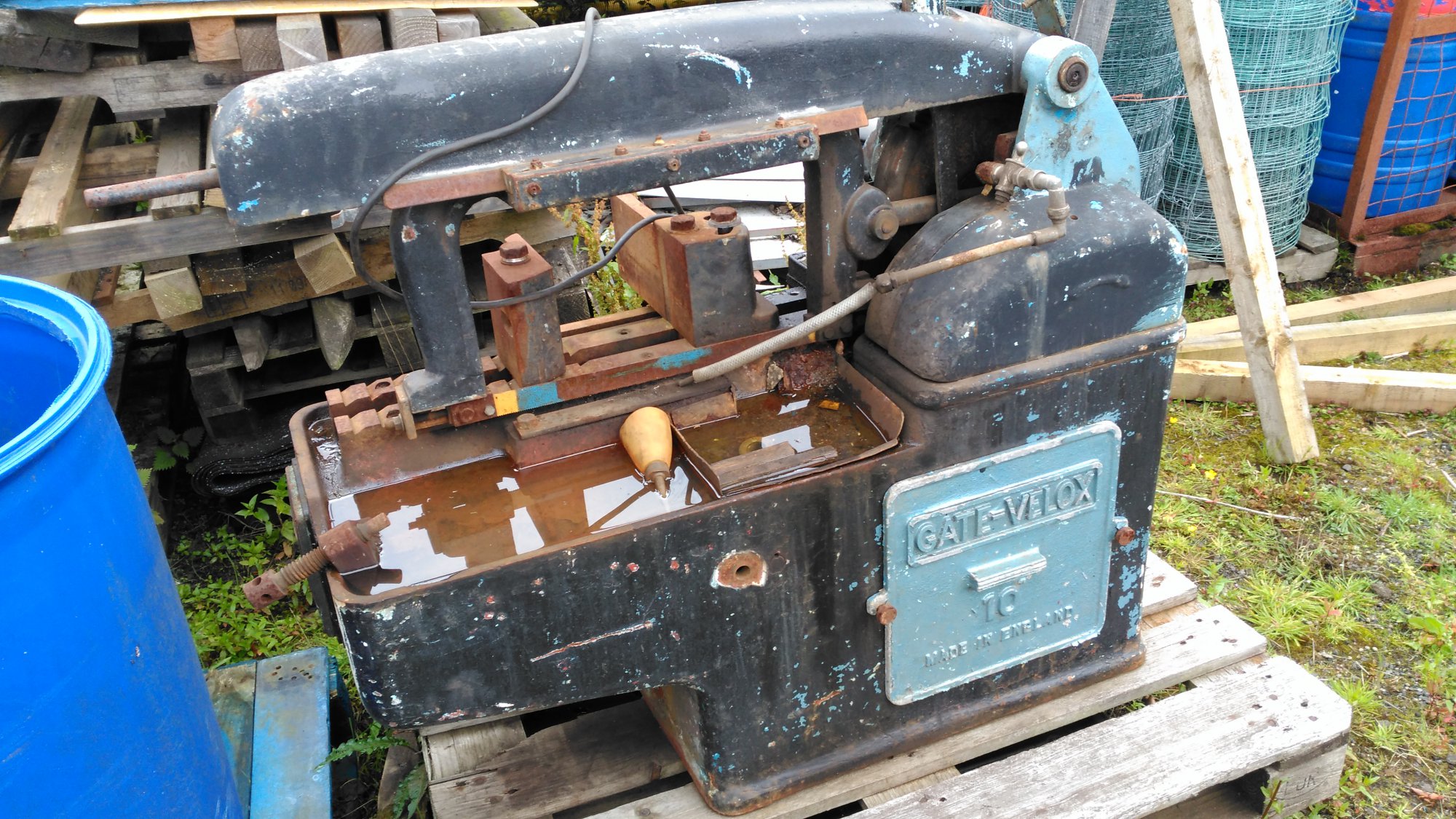

Nice.. looks in good condition to....Wee pic of the one sitting at my dads place....
Wondering what/if the advantage of using these over a chop saw? Less heat and narrower blade I suppose...
You can clamp a few pieces together, set it to cut and walk away and do something else, when you come back it's all cut for you. Plus quieter and no sparks to worry about.Wee pic of the one sitting at my dads place....
