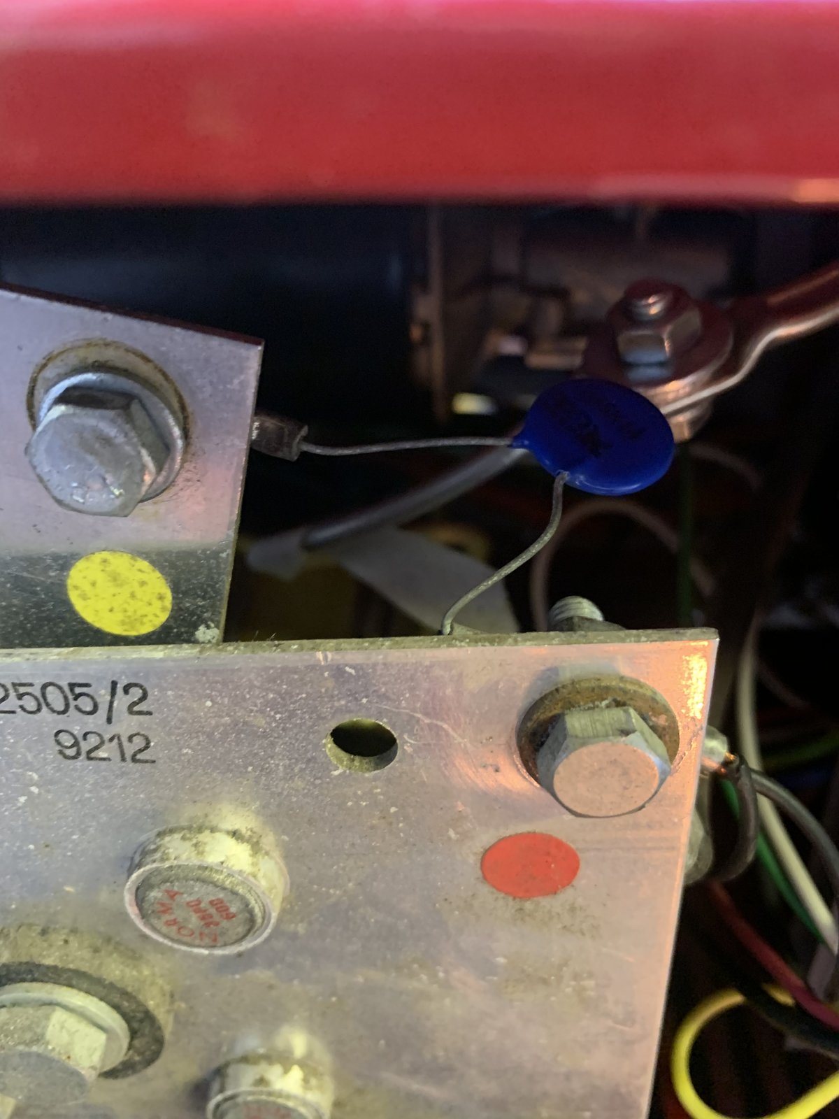

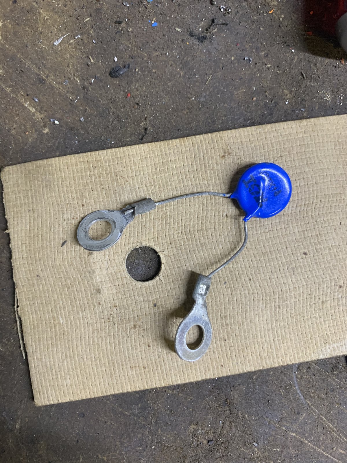

Ok been messing and found two diodes have gone but in my haste I can’t remember where this guy lives
Thanks seadog for the reply - Iam still learning - upload pic to make sure it’s rightBetween the positive and negative terminals at the output of the rectifier.
Ok thanks a11r , so I take it the red spot means positive ? And it won’t reach the inductor so would it go on the earth lead instead bud ? Thanks forAs it goes over the rectifier DC output, one plate or tag will feed the torch (+ve), the other (-ve) will go to via the inductor to the earth lead.

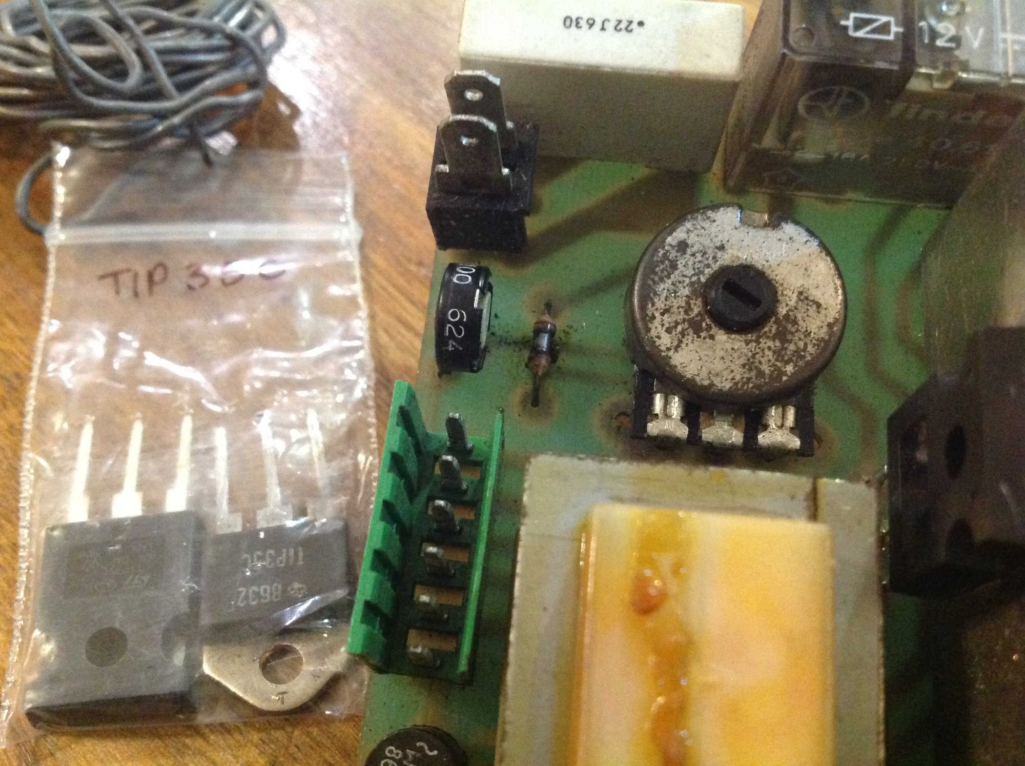

Help lol , I have nice condition one of these faulty , blows 13amp fuse after a 2second run .
so when I first got it the motor wouldn’t run at all nothing and would blow fuse after 2 seconds .
Noticed the range switch was stuck in and swapped that for a good one - still no joy
so checked the board and found transformer was dead - replaced with another and worked for about 5 seconds and think has took the regulator out now as it just runs on n on ,
