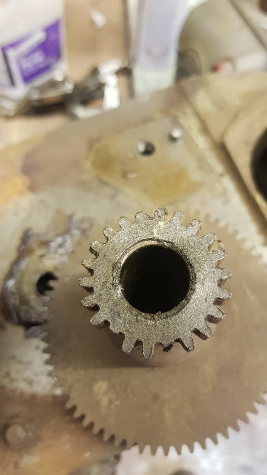

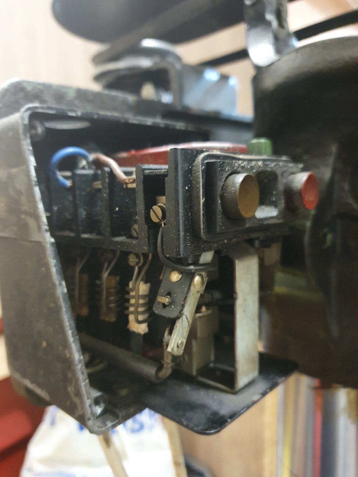

Rob - The top of the drill is 6.5" wide and it is minimum 20.5" long from the outside of the 2 pulleys, though mine hasn't the original motor fitted so that dimension might not be correct.
I also noticed that the quill return spring & housing are missing. The hole it sits in is 51.45mm diameter, I would be interested in this as well if you have one.

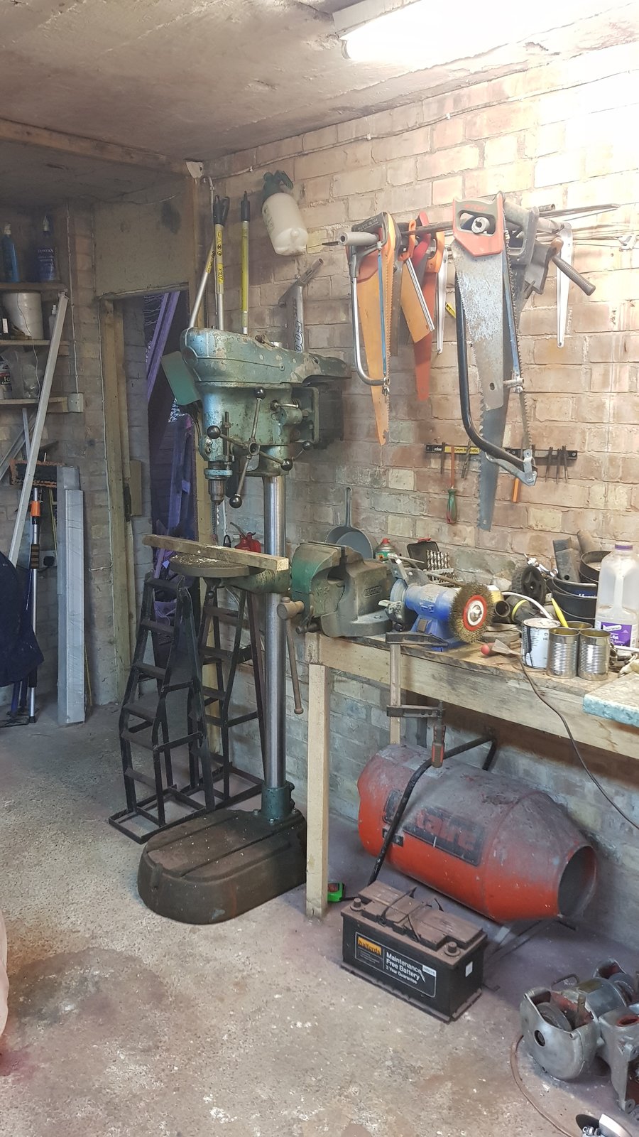

Rob - have you been able to check out what's left of your drill? The parts I'm after are the top cover, quill return spring mechanism and one of the levers for winding down the spindle.I had a look but to be honest it's such a mess I was unable to search thoroughly. Don't think it still has the badge attached either..
I am going again on Sunday so will have a look again and try and send you a picture.
Cheers.

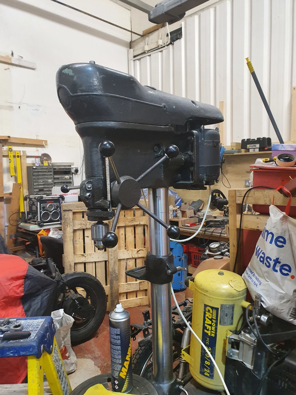

I have over 100 photos of the rebuild and happy to help and share photos if useful.
- that's a kind offer and may help someone else with the same machine in the future.

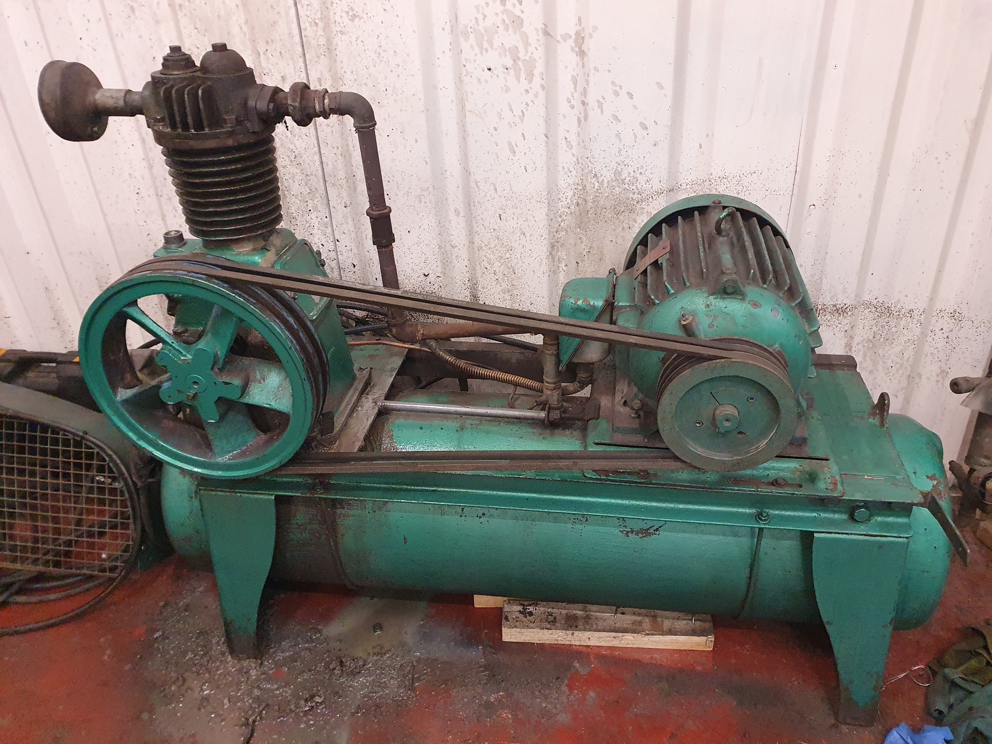

Just out of interest, how do you drain that compressor tank?
