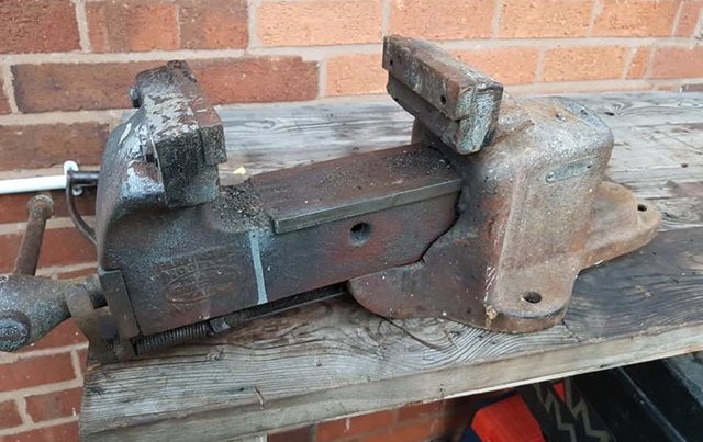

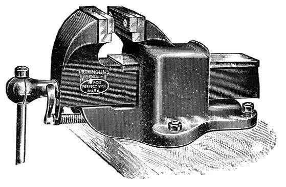

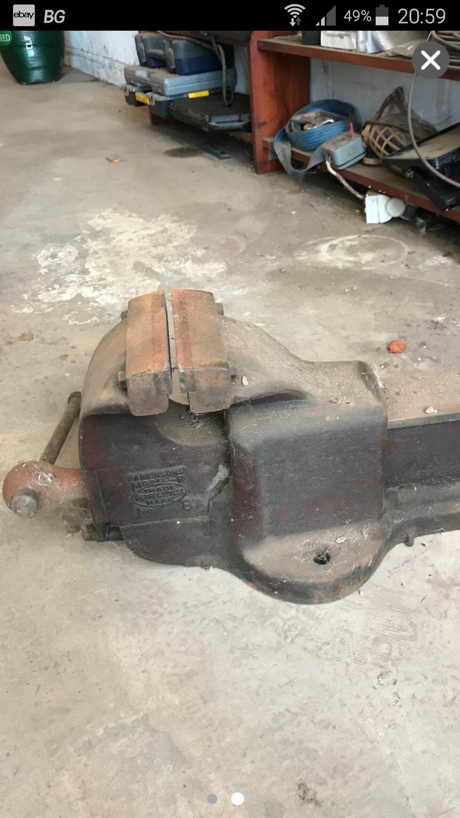

Pretty sure model F is visible below Parkinson's too.

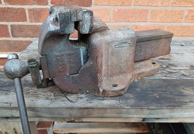

Dont think it is a F.
Frame shape is not correct.

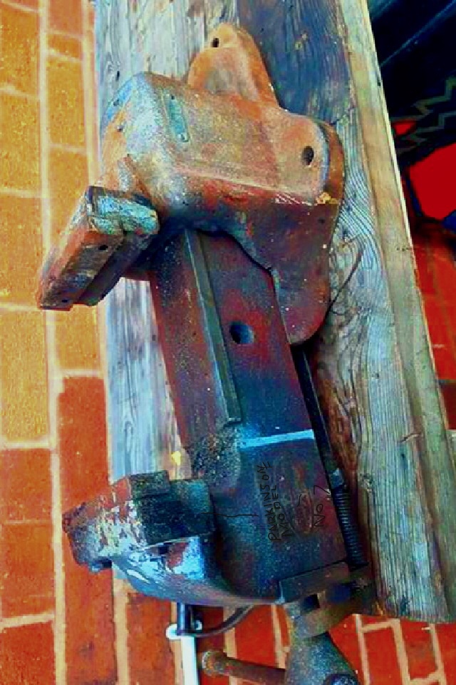

Don't know but if its a no7 I can give you spring dims from mine.Thanks for working out the make of it

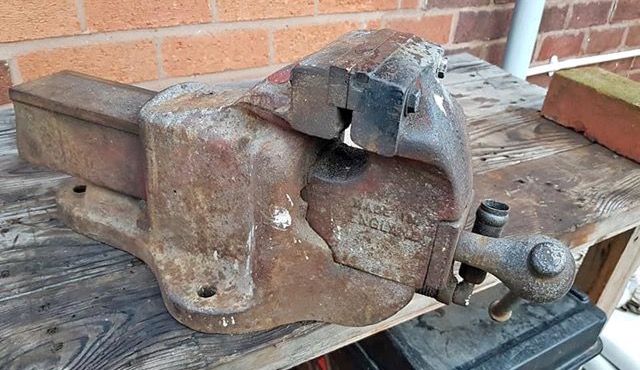

Can you get spares anywhere it's missing the spring for the quick release

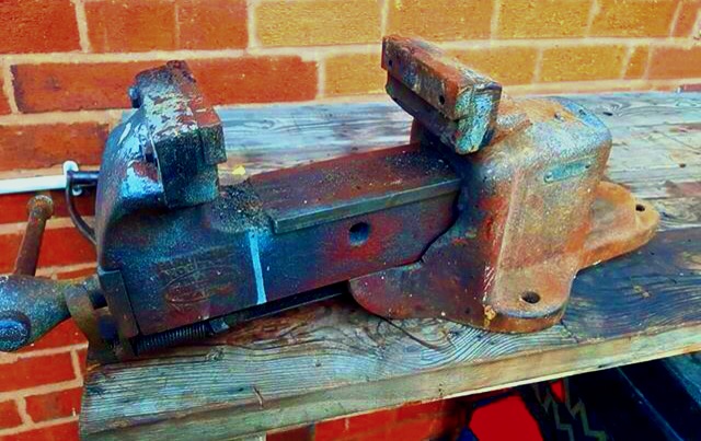

It turns out the spring isn't snapped it just doesn't hold the quick release in place. So the release lever disengages when it shouldn't and undos the vice8A. The 6" model. Spring length & diameter will be close, if not the same. Easy to work out the diameter & length from the lever & nut position, if they differ.
Jack, are all parts bar the spring still there? Or, is the spring there but snapped?
Easy fix then. Should fix into something near the tommy bar and wind up from memory.I

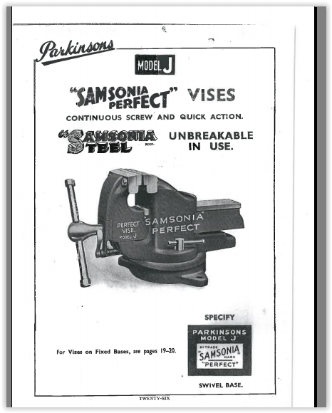

This is a diferent frame note vertical under rear jawmore like a J typeView attachment 158765
I
Seriously. It's a F type. That image you've posted is a F type. The J's have a dog leg shape on the rear of the housing. It's a F type.
