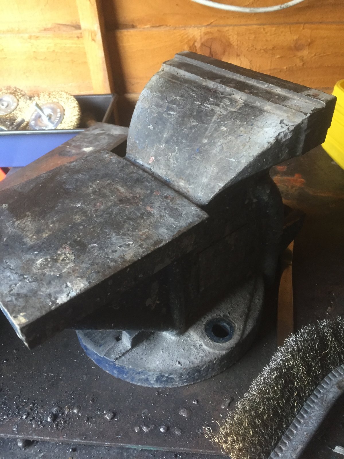

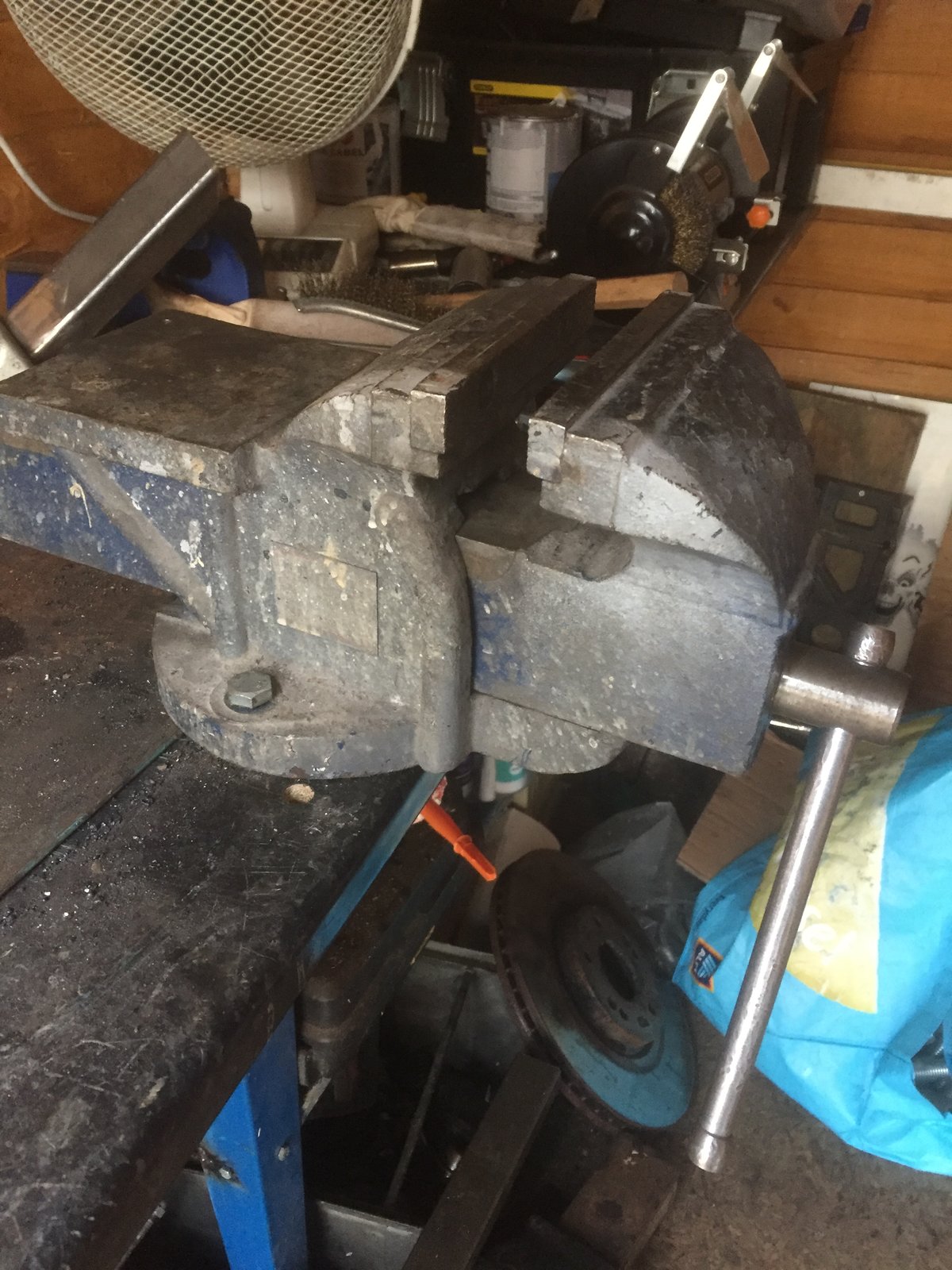

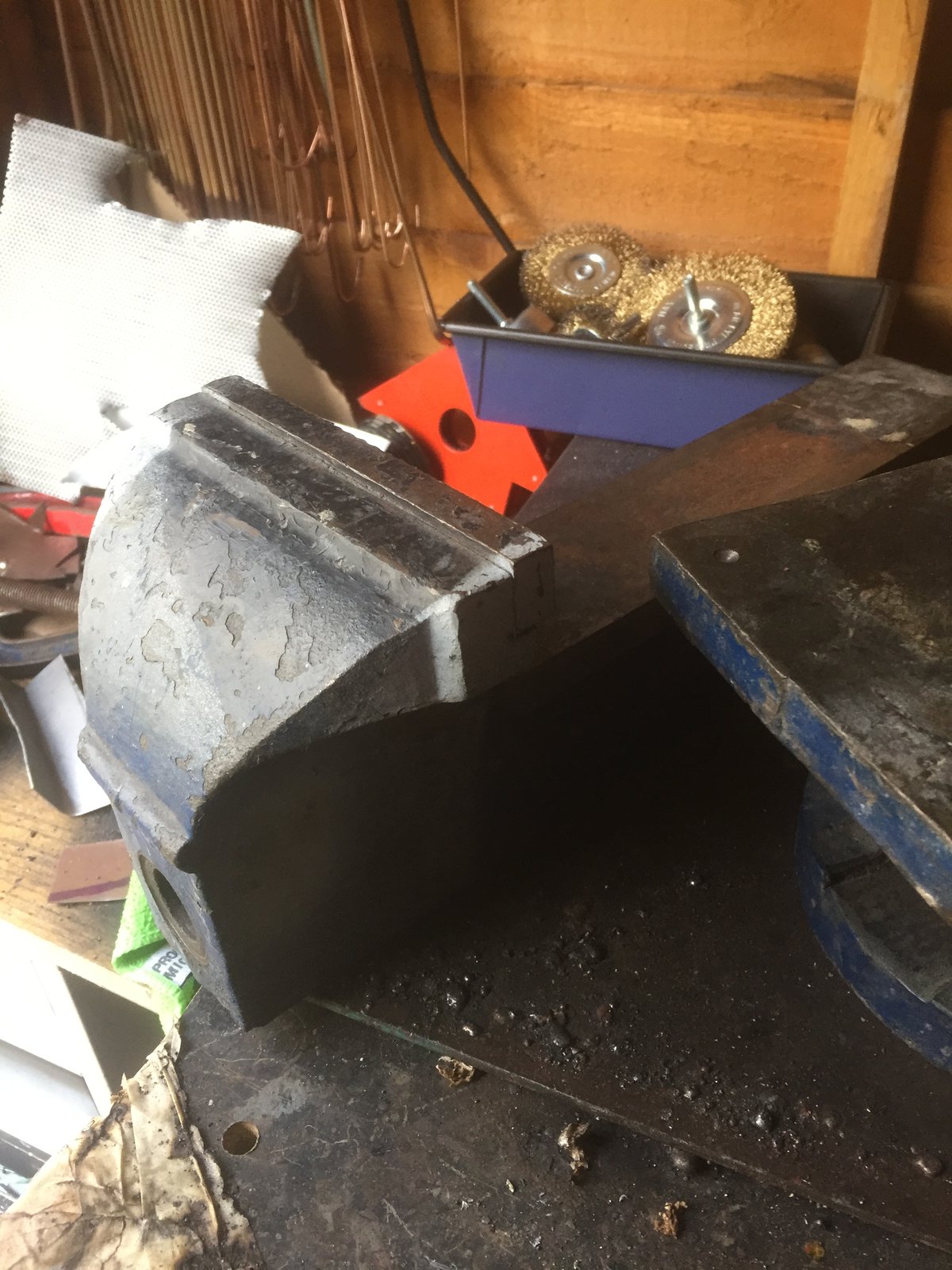

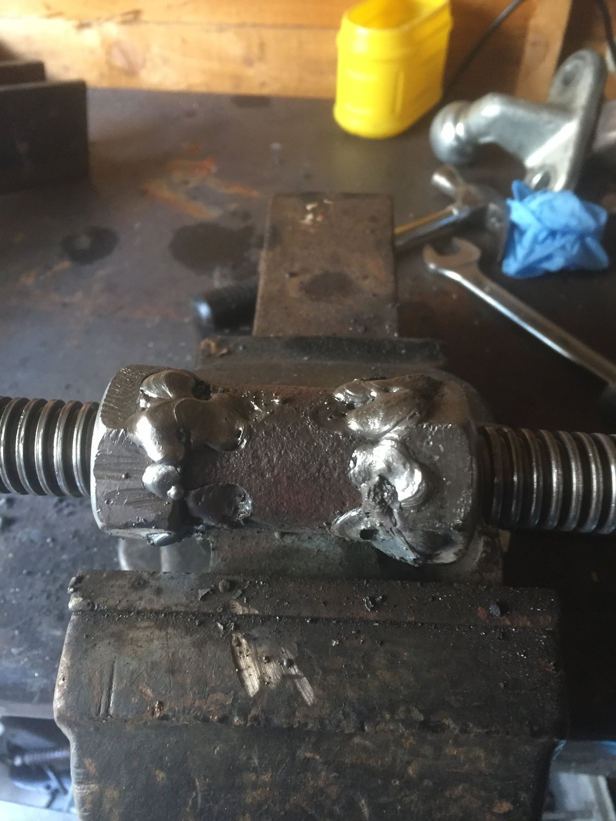

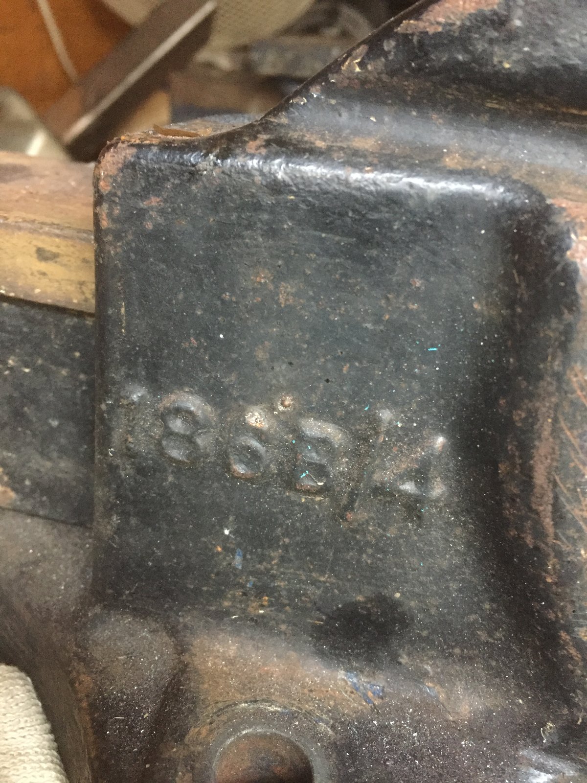

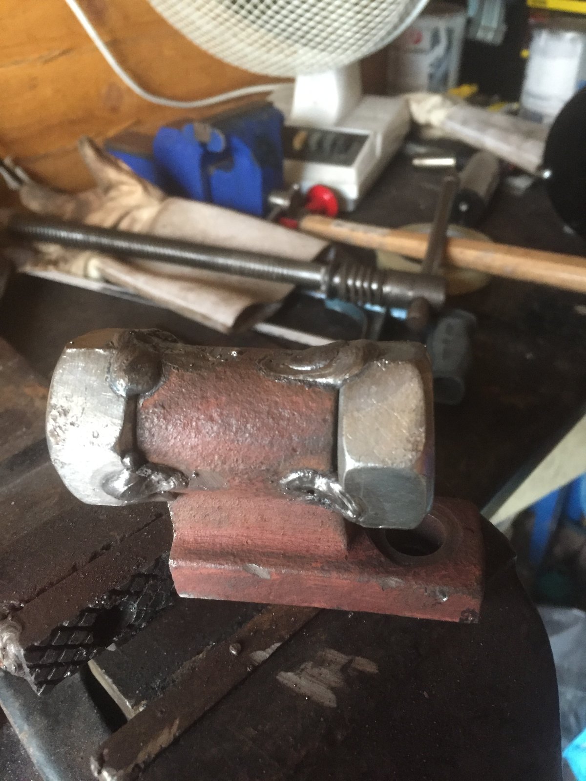

old vice was going to be binned . Could not let this be binned. What happened was the thread was stripped. Bought 2 nuts welded on each end of stripped piece . All up and working again. Not the best of welds, as long as it does the job .
